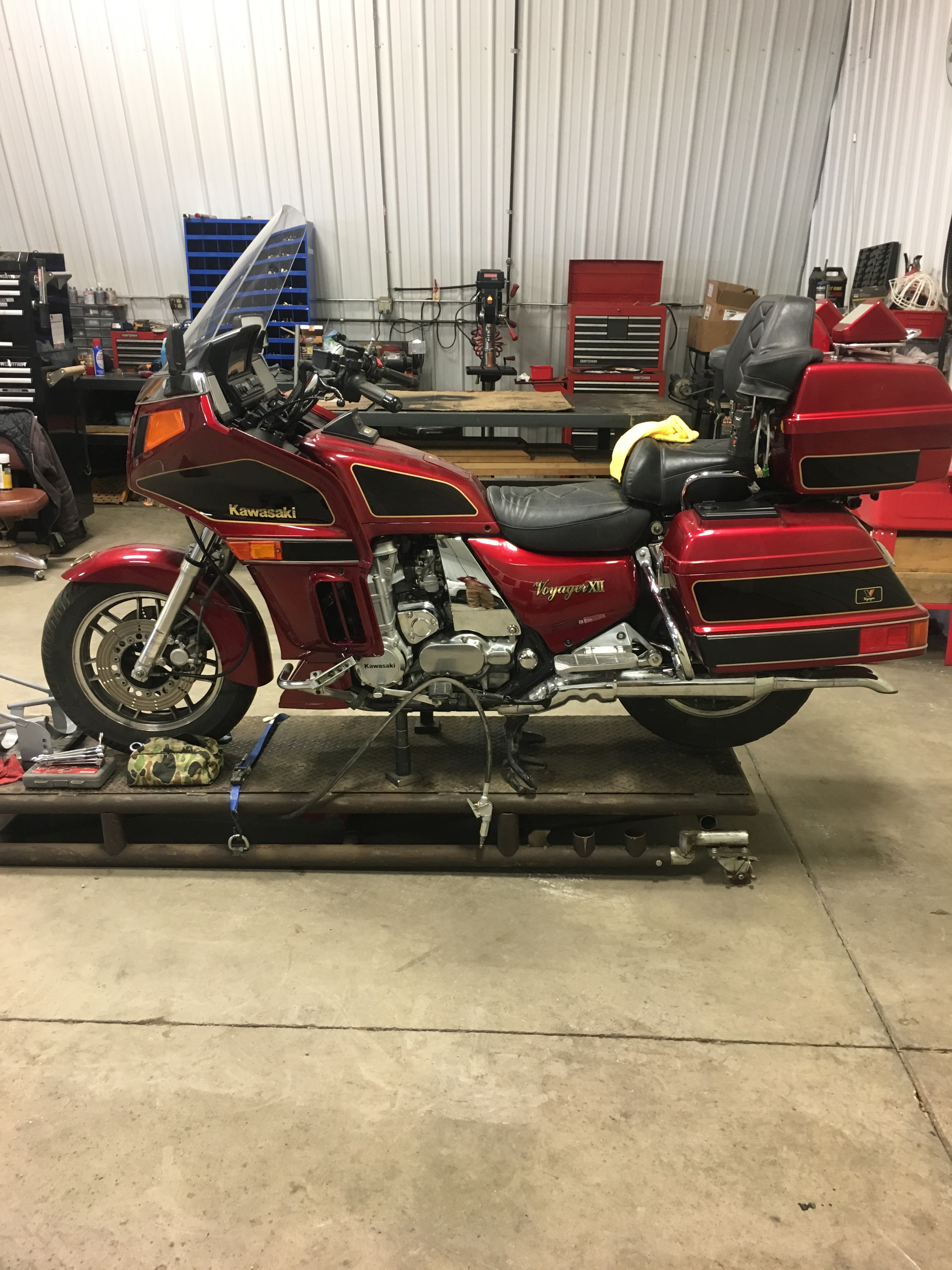

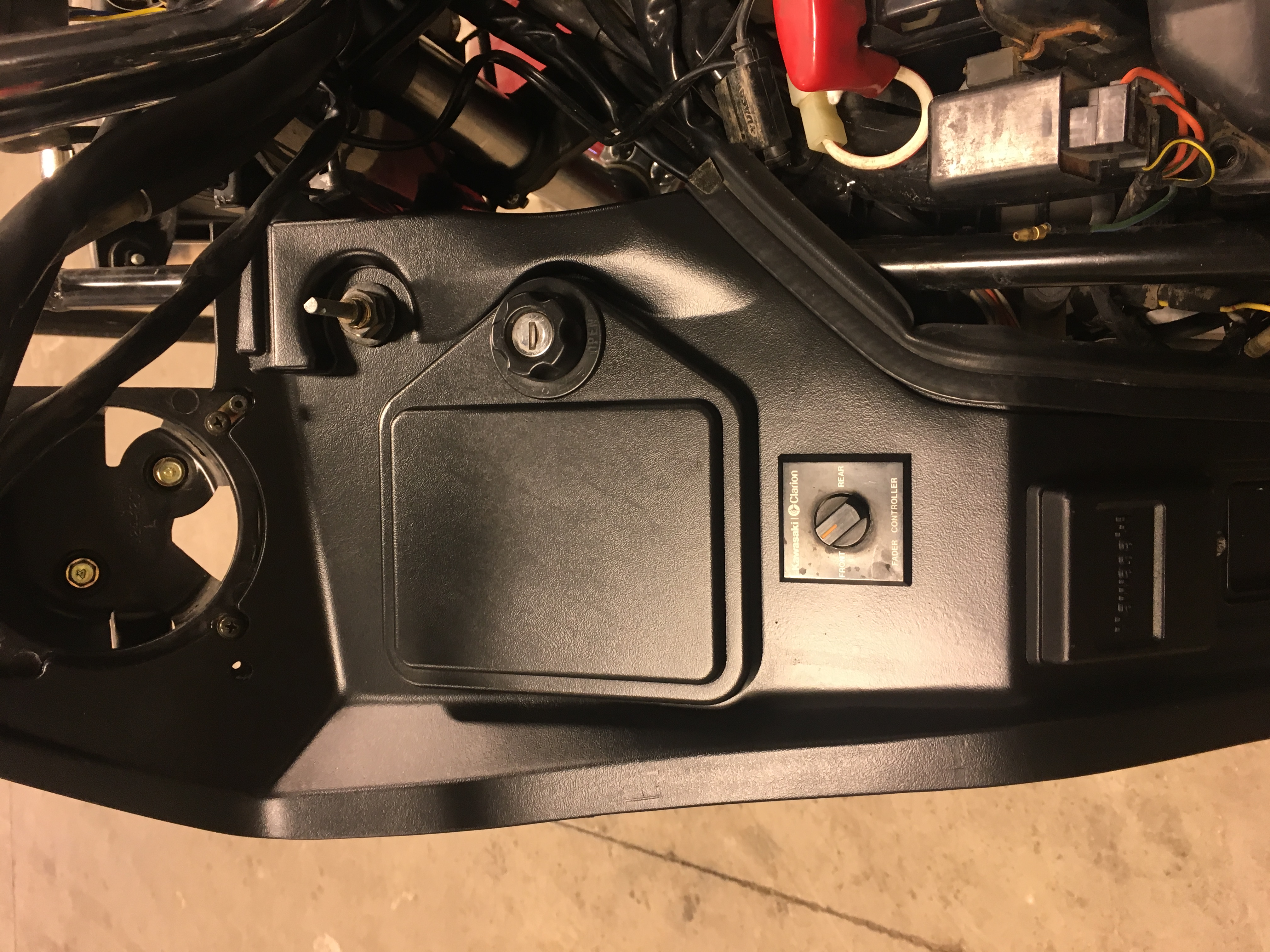

Putting a new-to-me '97 back together. The inner left fairing had some trouble at some point in its life. I'd guess some dot 4 was dribbled on it and it ran down the side of the lockable door and around the balancer, on down to the vent. I wanted to fix it before I went any further.
Eastwood Plastic Resurfacer. $30. Also used a can of SEM Sand Free adhesion promoter for ABS, PVC, and similar plastics. $15. The resurfacer is a matte black. I did no other prep work besides washing and drying it off. I didn't sand the discolored spots. I followed the directions and put 4 light coats on each inner fairing, each of the doors, and each vent to try to keep it all uniform. Even did the knob for the headlight adj.
It has an 8 hour cure time. I let it sit 12 before I started installing parts. It leaves the texture of the piece intact, and dust wipes right off w/o scratching. Everything was completely uniform. I'm no pro, but I was impressed with this stuff. I had enough left over to do the saddle bag lid doors too. I apparently rushed those and didn't get one of the doors quite dry or something. They both looked better than before though. It just takes the blotchy uneven look out of the plastic. I took each inner fairing out in the sun, and it even looks good in real light.
I didn't think to take before pics, but did take an after just because. I can try to get my handler to get them here.

If you click on the first one, you can make out the outline of the bad spot off to the left of the balancer. I didn't touch the balancer with the "paint" and you can make out the blotchy look the whole inner fairing had on it before being covered.

Yes, both the promoter and resurfacer are the 12 oz. spray can. There are several options for a "pre-treat", but this one specifically called out ABS, so that's what I got. The directions for the SEM promoter said to put on a medium wet coat and immediately apply the resurfacer. Once the 1st coat of resurfacer "flashed", then follow directions for the resurfacer which call for 2-4 light coats, 5 to 10 minutes apart. I guessed at the definitions of medium wet and flashed, but followed directions best I could. I didn't try testing anything w/o the promoter to see what the difference would have been without it.
As far as remediation goes, I did nothing other than wash and dry. I didn't pay any attention at the time, but now I wonder if the dot 4 flattens the texture of the plastic and that may be why the bad spot can be made out. I wouldn't know. I was thinking it was just a simple discoloration/fading problem. I didn't want to sand anything because it didn't say to, and I was afraid those scratches would show up.
Here's some stuff off the label that may be of interest to you... it passed 3000 hours of ASTM D4587 QUV testing which is equal to 7 years in the sun. It etches and reflows the surface, embedding black resins into the substrate and maintaining original texture. This is important as I don't need an over-eager doctor checking my substrate......
