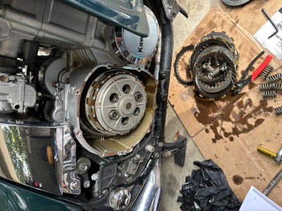

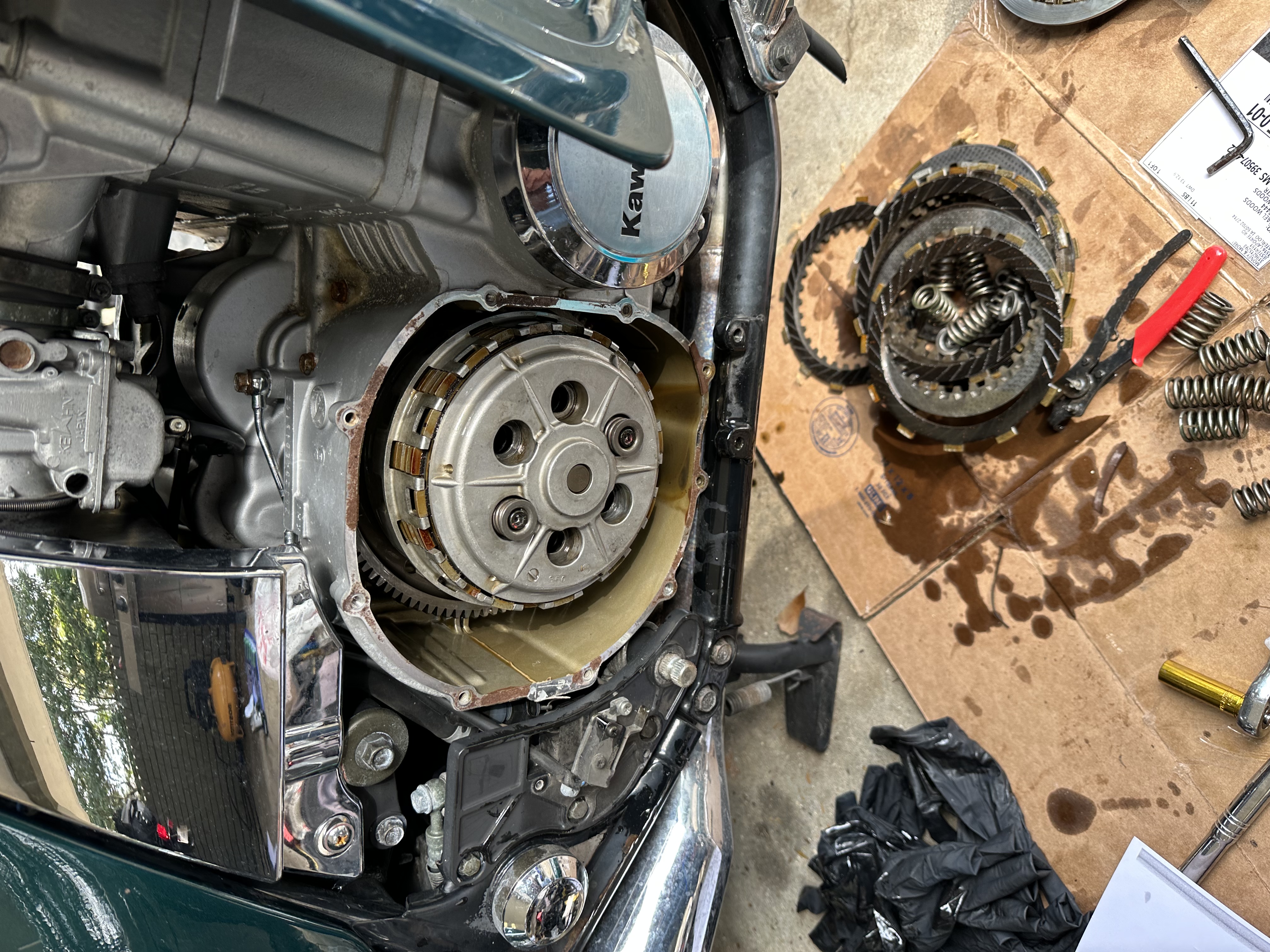

Re: Need some clutch help!
Here’s a photo of it as I was putting it back together. Not sure if you can identify anything?GrandpaDenny wrote: ↑Sat Jan 14, 2023 12:04 pm Sounds like you didn't index the first plate (last one you put in) - it doesn't go in the same slots as the rest. There is nothing to adjust.
ok the indexing looks good near as I can tell. It all looks good. When you say "hardly any throw", what exactly do you mean? Does the clutch disengage almost immediately when pulling the lever, or does it engage almost immediately when releasing, or does the friction zone seem tighter than before?
