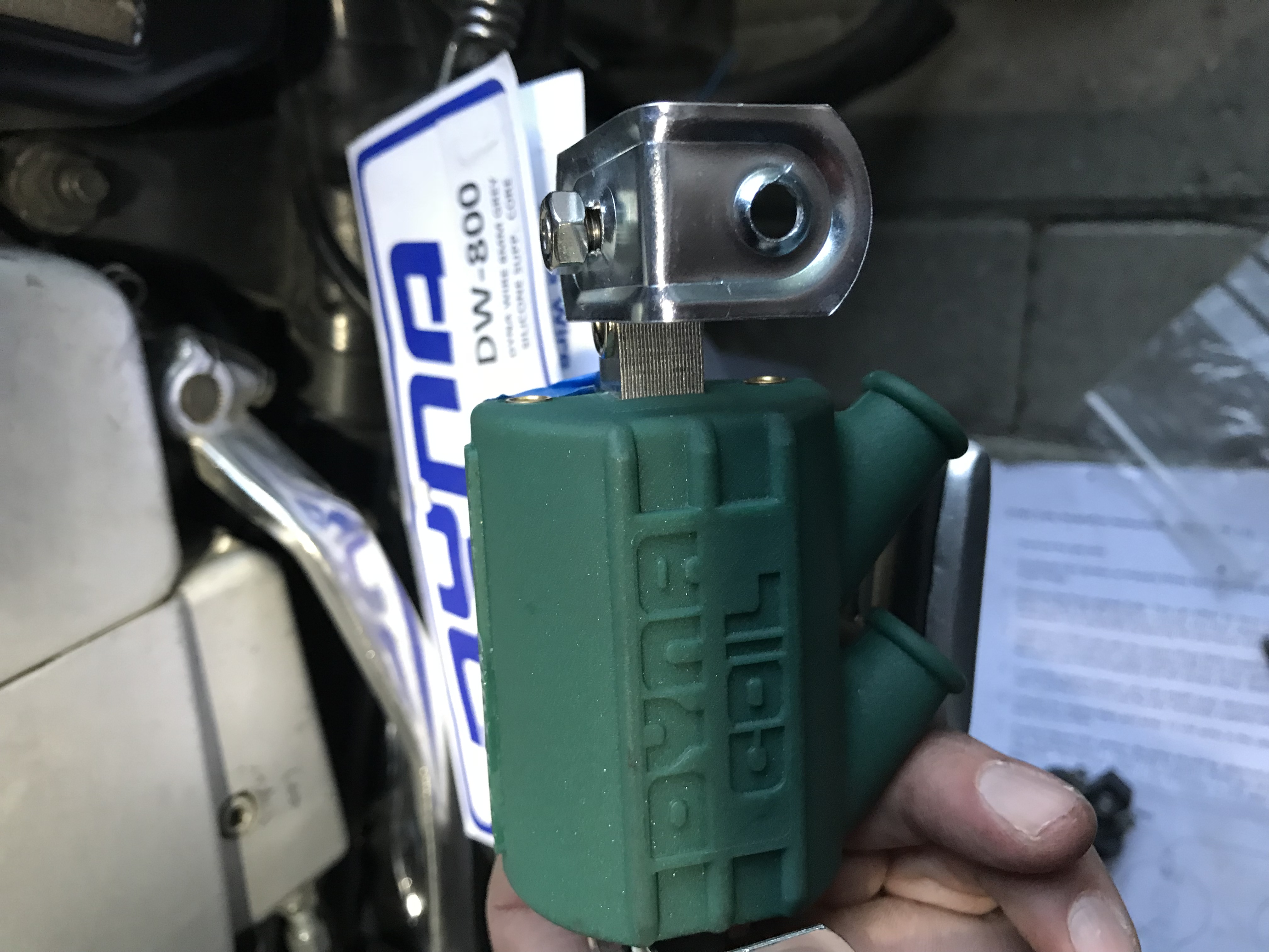

Suddenly my bike was a bit hard to start and sometimes could stop between shifting gears, I’m thinking the coils have done their job. Hopefully my new Dynatek coils will make the difference.

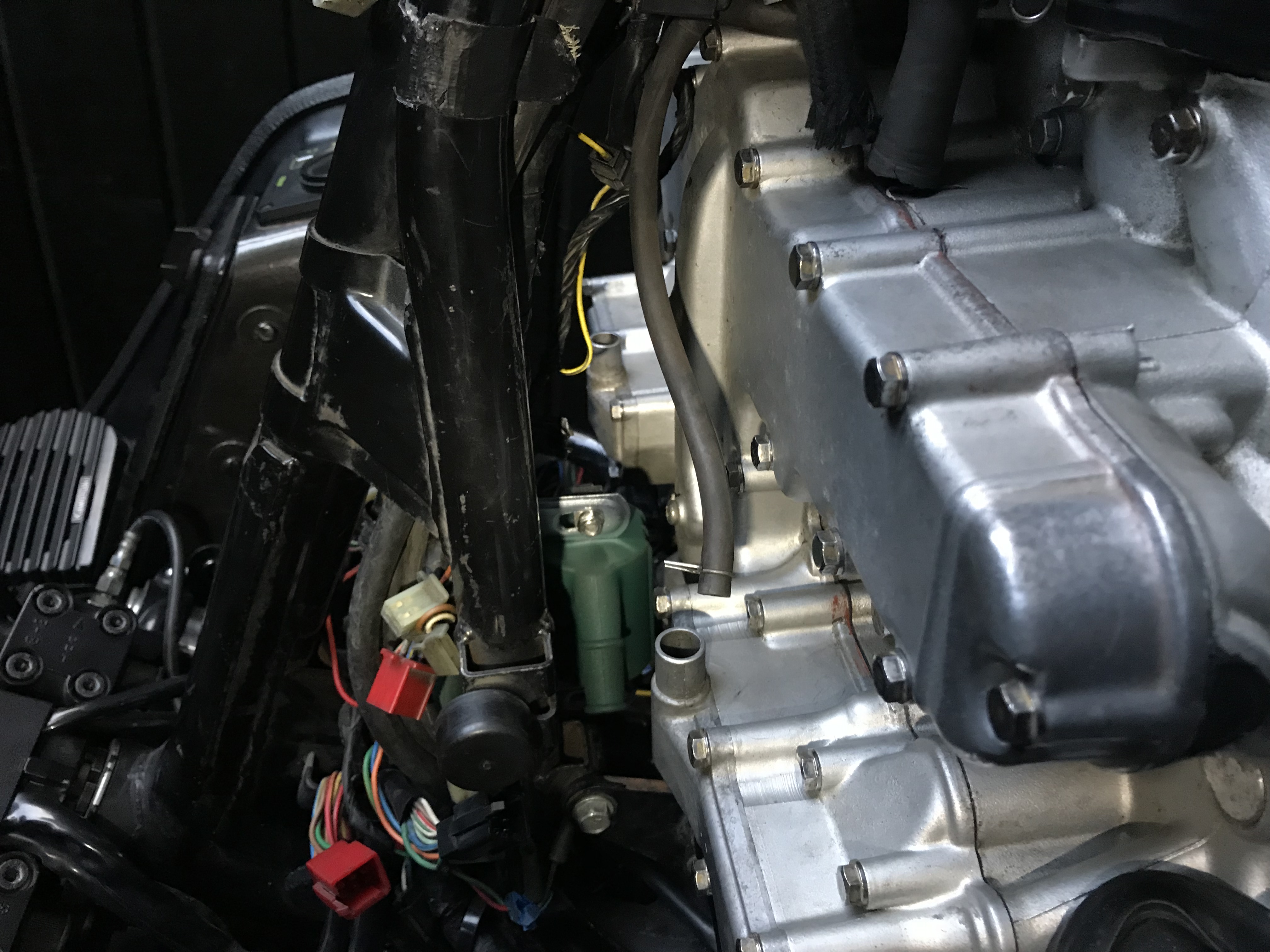

Man, what a difference Easier to start and the engine runs so smooth. It was not a "walk in the park" to install those dyna coils. It needed some modification to mount and a lot of time. But that's all forgotten now :-)

Can you send some more photos of the coil install and what you had to modify to get them in place?

samchar12 Sorry, I don’t have any more pictures from the installation. And now the engine is out of the frame, I’m doing a complete overhaul.
