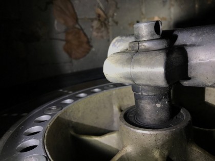

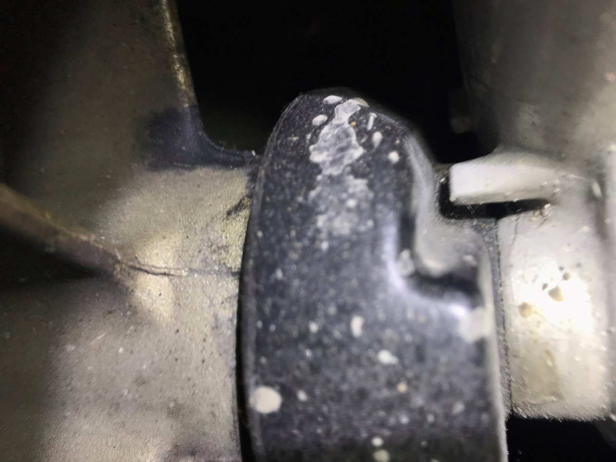

Re: Front axle torque spec
Got everything back together and notice there's a very small gap between the right hand wheel spacer and the fork boss. I know I have the spacer oriented properly as there are wear marks where the seal rubs on the spacer. The spacer doesn't spin so it binding against something - which it should. I wasn't paying enough attention when I took the wheel off so not sure if that gap was there before I too the wheel off or not:
Hmm..I think it is not correct mounted. I dont have a gap on mine.
Need to clean it, but you will see it on the Pictures :-)
Hmm..I think it is not correct mounted.Need to clean it, but you will see it on the Pictures :-)
Took the axle out to see what's causing the spacer gap problem and I figured out what's going on. I had assumed the bolt shoulder on the right hand end of the axle butted against a 'boss' in the left fork leg but it doesn't. So because I'm not fully tightening the pinch bolt when torquing the axle nut, the bolt shoulder pulls through the fork leg and against the spacer compressing the hub bearing 'stack' resulting in a narrow gap between the fork and the left spacer.
Now, I could tighten the pinch bolt first then the axle but that would pull the lower fork leg over slightly from where it appears to want to rest. It seems to me that probably the original tightening order I used (axle first, then pinch bolt - leaving a small gap) is probably the right way to do it for optimal fork movement. Opinions?
