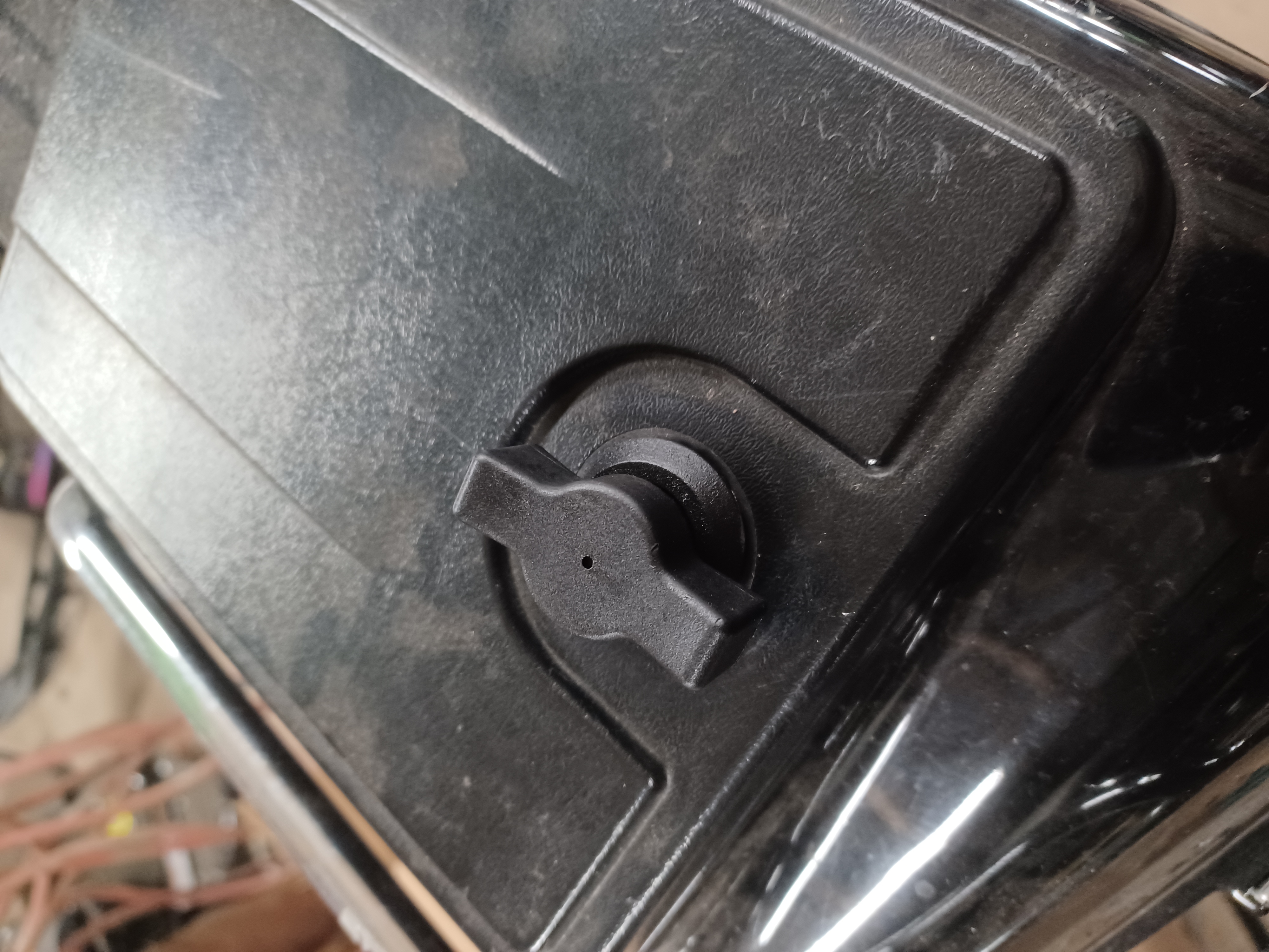

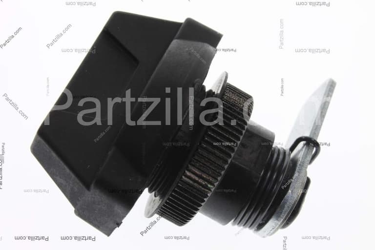

Has anyone found a cost effective replacement for these?
I really just need the return springs. My searches on the interweb have not found a spring from venders that I have found and the lock itself is either not in stock (Partzilla) or quite expensive at those who do offer them.

Re: Bag lock
I was thinking about trying this, one of mine is mising.
Any thoughts?

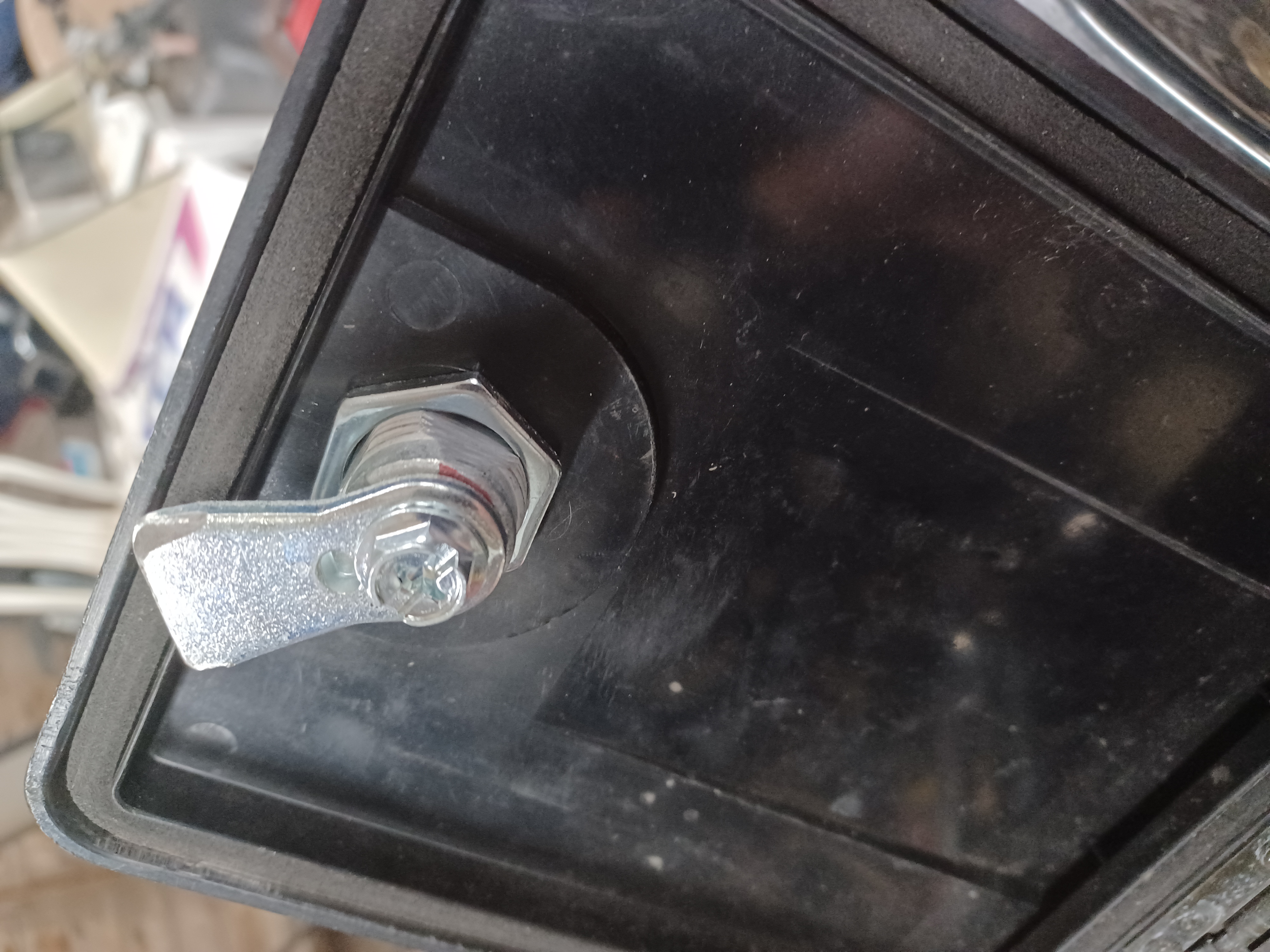

Update:
I went with the latch from mcmaster. With a bit of massaging, seems like it will work fine. I had to grind the flats down a little to fit the hole, and cut some of the tang off. It's not spring loaded, but there is plenty of resistance to keep it closed. About $30 shipped.

Re: Bag lock
Looks great, Thank you for the reply. I have experimented making new spring on mine, If I can't make that repair I'll definatly consider the ones you used.

Re: Bag lock
Conrad, did that part seal off good? i need to do something with one of mine that leaks water in.
- Posts: 96
- 1
89 yamaha venture royale - Has liked: 25 times
- Been liked: 55 times
Re: Bag lock
I can't say for sure it will seal, as i haven't had it out in the rain or under the hose yet. But it did come with a rubber gasket, so i would think so. It does stay closed well.

Re: Bag lock
I can confirm the mcmaster carr latch keeps water out, at least when washing. Not that i aimed the pressure washer right at it mind you, but I'm thinking it will be fine for normal washing and rain.
