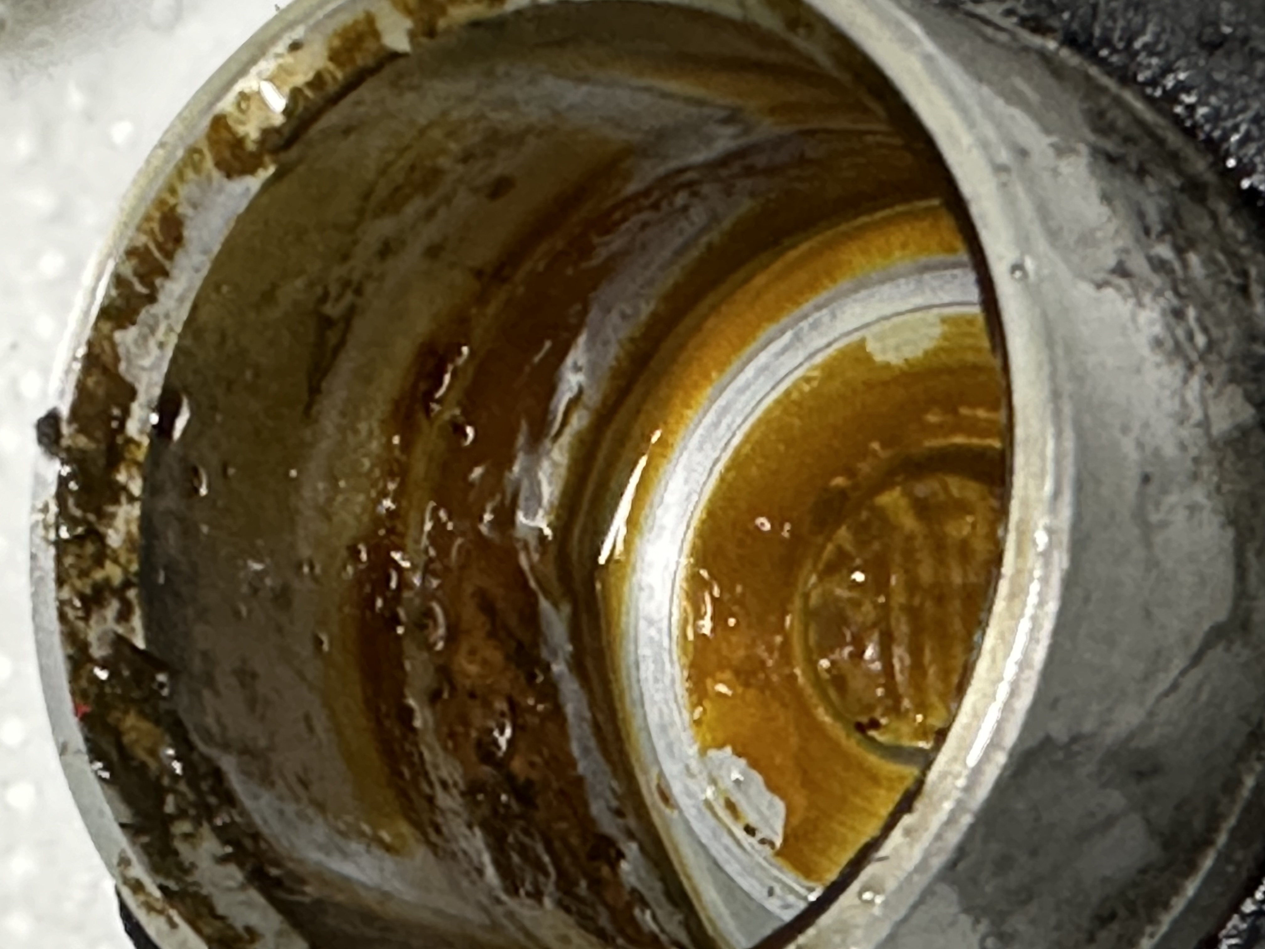

My clutch fluid seems to be disappearing! I am not finding any leaks but after replacing the fluid when I got the bike I find myself having to refill the reservoir. I replaced the fluid and bled the clutch fluid and all seems good for a while. But after a couple weeks the fluid starts showing low again.
Any ideas to find a leak that is not appearing to be leaking. Where the heck is the fluid going??

It may be time to repack the slave cylinder :hmm: ,as it could be going past that into the transmission :cry2:

Will do. Ordered a rebuild kit. Figured if I am going to pull it apart I might as well do a rebuild. I can only imagine what it's going to look like.

That’s affirmative on needing the kit. Oil sightglass nearly full and some nice sludge in the Slave cylinder.

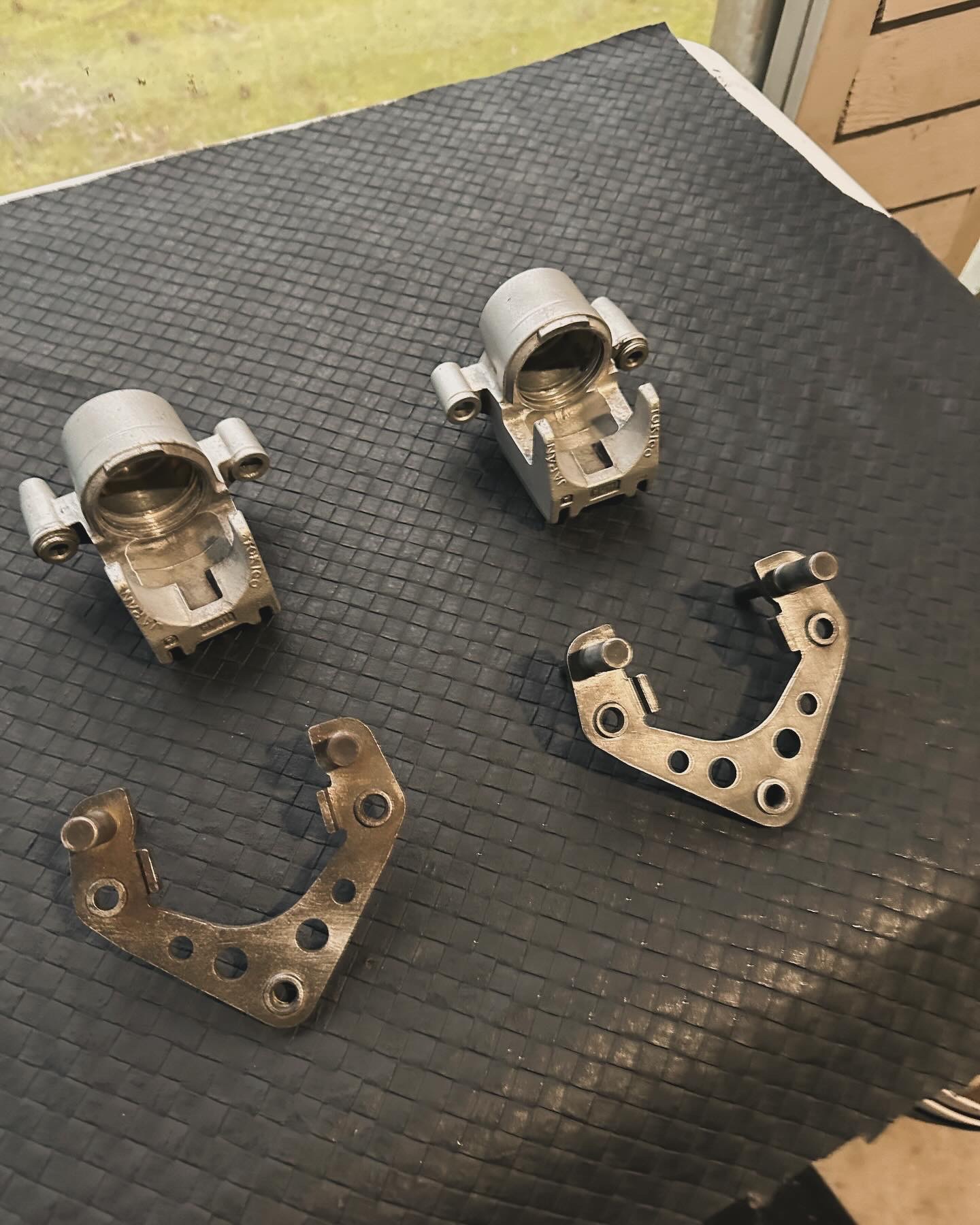

glvnthedream ,Since your clutch fluid looks that bad :hmm: ,you might also give a good look at your brake systems,and be prepared to rebuild them also :corn:
triton28 (Thu Jan 18, 2024 11:33 am)
Rating: 12.5%
glvnthedream
Posts: 65
Joined: Fri Apr 21, 2023 8:06 pm
1
Has liked: 46 times
Been liked: 14 times
Re: Where is my clutch fluid going?
Post by glvnthedream »
Already rebuilt the calipers and getting brake lines.
Thanks for the help and advice everyone.
cushman eagle wrote: Thu Jan 18, 2024 1:10 am glvnthedream ,Since your clutch fluid looks that bad :hmm: ,you might also give a good look at your brake systems,and be prepared to rebuild them also :corn:
