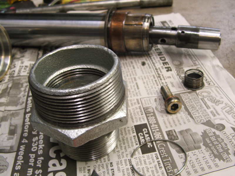

I like how you made a special tool to remove the plug to access the spring and shock oil chamber without taking front fork leg off the bike. Not knowing better, I ended up taking off one strut leg. I used a 24" carpenter's clamp to remove the spring wire circle clip.voyager55 wrote:No need to remove forks. Go by the link I posted . Very simple procedure with great instructions. I use same procedure to change fork fluid every 2 years. Progressive springs front & rear spring shocks are the two best improvements you can make on your bike for ride & handling. http://www.abbikeboard.com/jeff/spring/spring.html" onclick="window.open(this.href);return false;

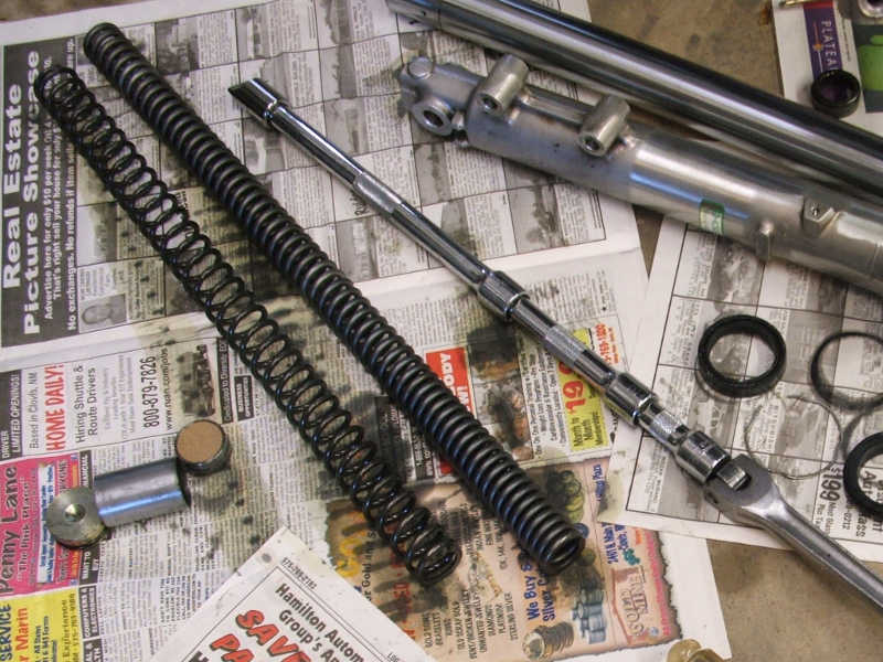

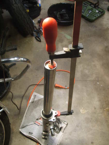

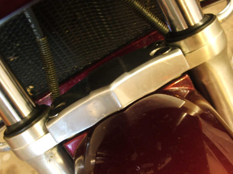

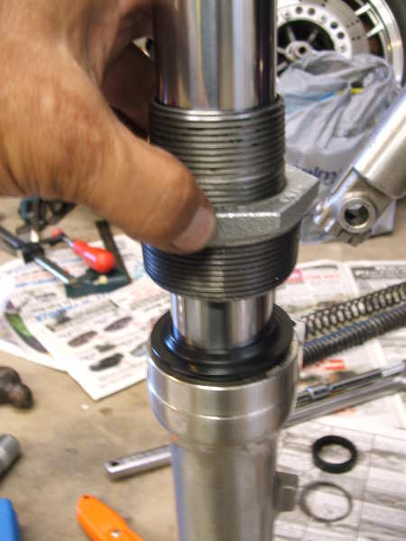

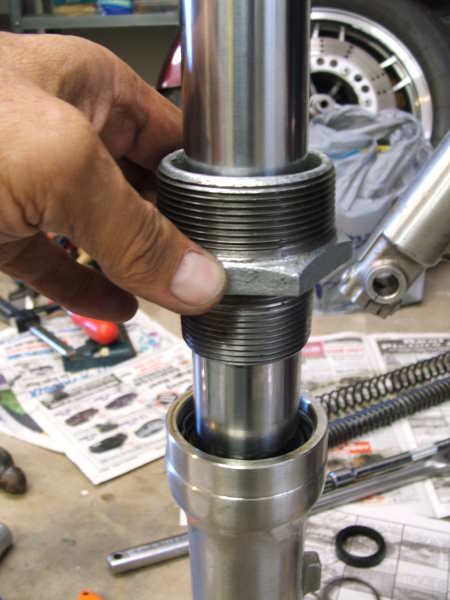

You are welcome, ekap1200. Here's a few more tech tips during my fork seal replacement and Progressive Springs upgrade.
1. To allow me to extract the bottom Allen head screw retaining the inner fork tube, I used a A 15/16-inch Craftsman #44513 Drag Link Socket with enough 1/2-inch extensions to clear the fork tube and breaker bar to prevent turning. It worked like a charm, locked into place sufficiently, I had it off in no time flat. Sears sells a set of 4 in graduated sizes, which will help to remove large slot covers on many motorcycles without tearing up the aluminum.
2. I improvised a tool using a 1-1/2-inch IPS galvanized iron pipe plumbing nipple and 1-1/2 to 2-inch IPS galvanized iron plumbing bushing to seat fork seal and fork cover. It weighs a couple pounds and has enough inertia to act as a sliding hammer. This was certainly much cheaper than the special tool specified in the service manual.
