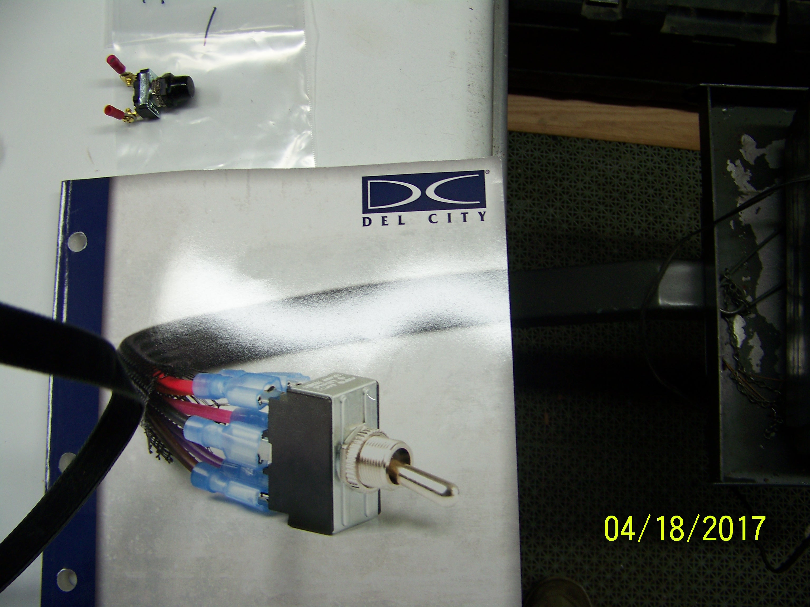

I'm guessing that's also where I should wire in that switch other's have talked about, to allow priming the carbs without turning the motor over. I assume I can use a single-pole switch on the hot side?
Re: During Carb Sync Engine died...won't restart...Advice?
I chose this one. It is a momentary push button, Normally closed, 3A. Separate item added was the black rubber button cover.Nails wrote:I'm guessing that's also where I should wire in that switch other's have talked about, to allow priming the carbs without turning the motor over. I assume I can use a single-pole switch on the hot side?
It is the small switch in the upper left of the photo not the switch on the cover of the free catalog also shown in the photo.
Not much room to get that plug off or see it so pay close attention to its orientation as you remove it. I would have to get back to you on what wire I tied into. Purchased from Del-City catalog online. Starts like I just had it running. and the best part is you can use it to hear the pump run in a trouble-shooting moment...
- Posts: 1830
Okay: normally closed, and push to open.
I was thinking of a hidden flip-switch, to double as a theft deterrent. Even though it seems more likely to confuse me than ever actually deter anything.
And yes, weatherproof seems necessary. (Hard to find real weatherproof switches.)
Thanks. My new-to-me bike remains scattered in pieces; and I'll add this little job to the list.

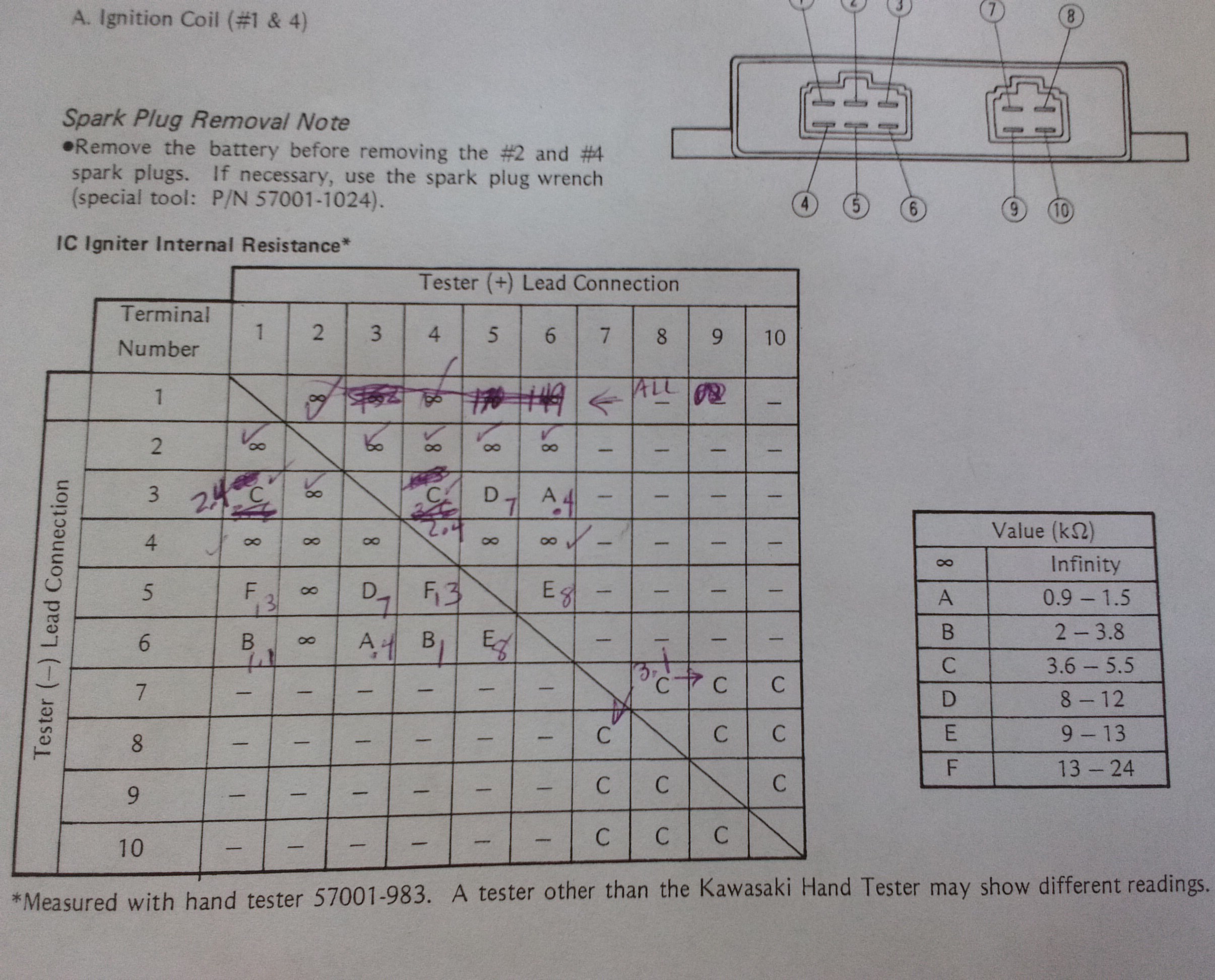

I believe this leads me to the Igniter. I will pull it and bench test it as per the owners manual and report back.

OK...so I replaced the IC Ingniter with one off of a (supposed) working bike...no go.
I pulled the plastice and took apart the main connector that comes from the ignition key/switch. It was fine.
I bench tested the kickstand switch...it's working properly.
I even took the vacuum line off of carb #1 and the back of the diaphram (on it's way to the IC Igniter) and blew through it. I thought maybe with the air box off and it happening when I was adjusting the restricter on the vacuum gauges that something may have gotten in there and was keeping the IC Igniter from getting vacuum, but nope, it was clear.
I'm really stumped...and the weather is beautiful...sigh.
Let me know if you think of anything else to check.
Thanks,
Rich
PhishHead61
