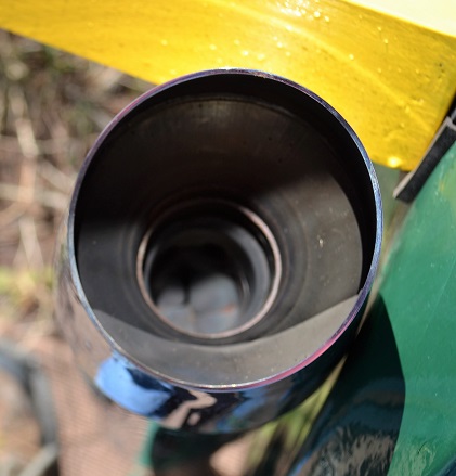

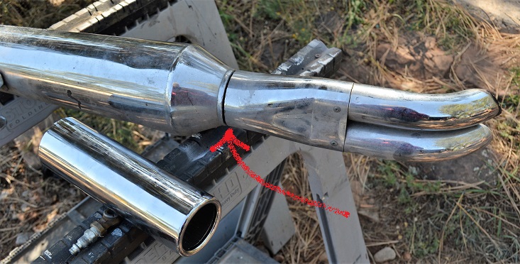

I had a way kool idea: replace the exhaust tips with something shorter and straighter. Well, I got the idea from somewhere in webistan -- somebody else did this and had a sound recording. I liked what I heard.
But when I cut off the old tip (red arrow), it didn't fall. There's some inner pipe.
Not sure what the other guy did. I should've looked at it closer - I don't need to wreck the whole exhaust system just for a little different sound. I'm just gonna weld it back closed. :bat:

Nails, if you look close at the two turn down tips only one is actually used the other is a fake exhaust tip. So even though I've never performed an autopsy on the exhaust or the Voyager it self I think one could assume that the inner pipe you found goes to the one turn down tip that is functional.

I've edited this post after taking a closer look.
I think this is partly true. The outside pipe has a lot more soot, but the inside one also has some soot. The outside pipe connects to that inner pipe (further upstream), but there's some complication and partial obstruction. I originally thought the inside pipe also hooked to the inner pipe, but I checked again and that might not be true. I suspect the inside pipe only gets flow in high-flow conditions, but I have not idea how that might be hooked up.
On the header end, I see no inner pipe. There's some complicated plumbing here, too. I don't want to mess with it any more.
(The tips apparently come apart by grinding off those rivets. But I don't have SS rivets to put it back.)

No, just stupid. Those often are confused. Somebody in some web vid "cut off the tips and replaced them with straight pipes". I was just following them ... like a lemming.
Apparently they hacked it off with a chop saw and left the inner pipe open. The resulting sound wasn't much louder than stock and quieter than a Cobra -- they had vids of all three. Dumping the plumbing at the tip didn't really seem to do much of anything.

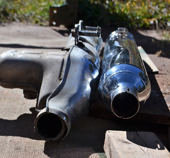

Apologies for resurrecting this old thread, but I just got my PC fixed.
Here are some photos of the FLT pipes I bought. One shows the plug. Earlier HD pipes had a plug in only one side. I thought the later ones had no plugs, but mine ended up with a plug in both sides. I don't really know what this means in terms of restriction (the rest of the design), but at least both pipes appear to be the same.
The other two photos compare with stock.

I think I can hook them up to the stock headers by cutting a 30-degree 1.5" SS elbow right in the middle and then welding it back into an S-curve. I'll mount these pipes to the saddlebag brackets, somehow.
But for now I put the stock pipes back on because I have some other mods in mind. I'll make all the changes to the saddlebag brackets at once.

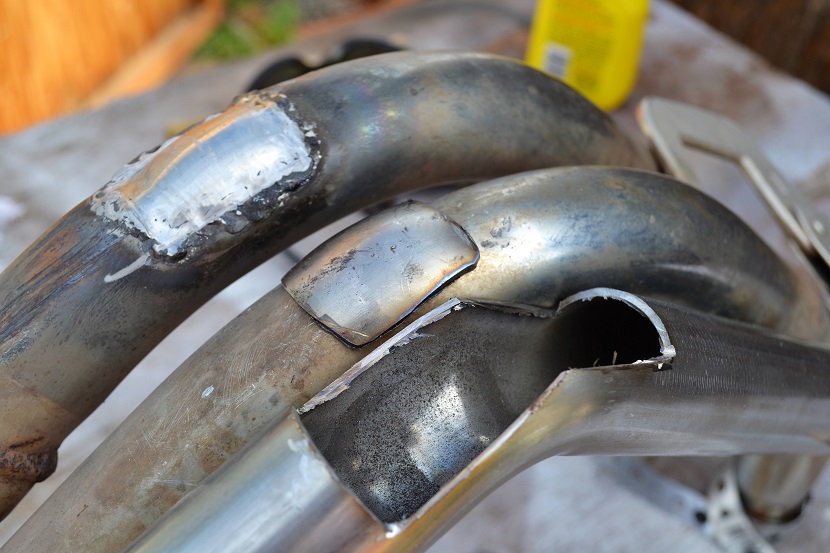

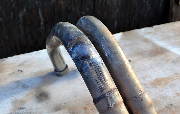

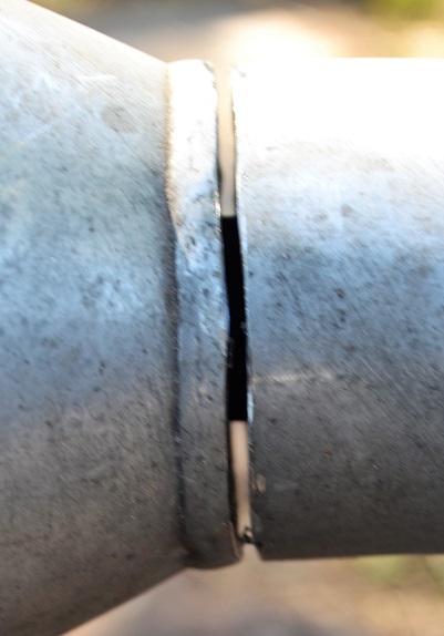

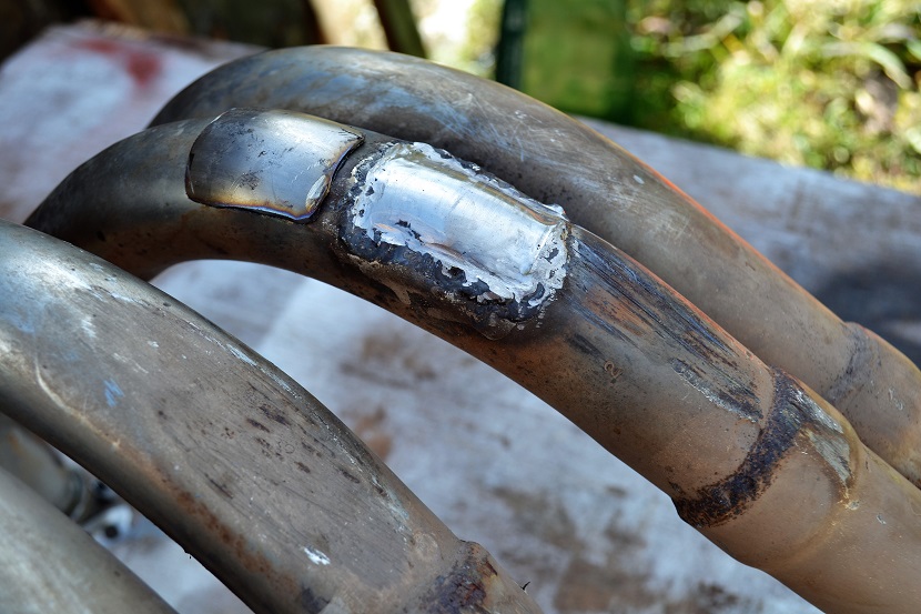

And since I'm talking about the exhaust, here's a repair to a bad bash in one header. (The other header has a minor bash.) I tried drilling a hole and pounding it out with a slide hammer, but it was too tough. Turns out, the headers are double-wall.
These photos show the inner wall replacement, as well as the piece destined for the outer wall. I cut these replacement pieces from a 30-degree elbow of stock SS exhaust material.
This shows the final outcome.
I used a reducing flame and Solar Flux B to avoid an oxidized, brittle weld. I like to think that it worked, but I'm looking at making a bash plate all the same. Also, the header alignment messed up and I had to reheat the repair and use hand hydraulics to bend it back -- coulda been a wreck, but it went back on without leaks.

Nails,your header repair looks better than I would have imagined! :thmup:
I would not be brave enough to try something like that. :hmm:
