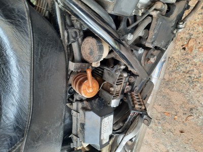

Its sat inside since 2018.pretty clean.i thought it was a voyager 4 cylinder. Apparently its a kz 1300 but dressed up like a voyager. So i guess: transmission fluid 1 tbsp down each plug hole. Replace any plugs that need it.let sit 24 hours. Change oil filter radiator coolant. I assume it has one. Pull tank off, rinse it out, put gas in, swish it around, then remount.change fuel filter. Change brake fluid. Install new battery. Fingers crossed see what happens.130 hp according to specs.
