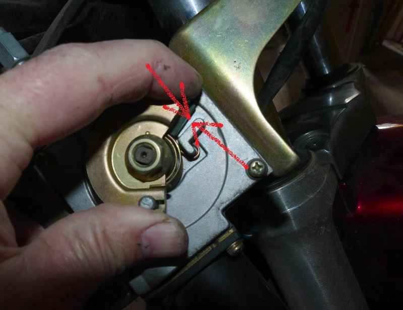

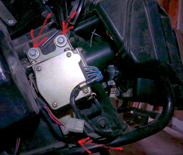

Here's the actuator, under the right fairing near the headlight. A common problem is too much slack in the cable.
Take off those three bolts and then turn it over to see the cable. (My hand is hiding the adjuster. Sorry.) This shows the slack you want -- I'm turning the pulley against a spring to take out the slack. See page 15-19 in the manual.

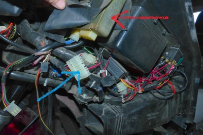

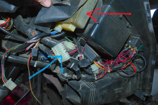

The control unit (red arrow) is under the left fairing, also toward the front. (That gob of wires to the right is where I moved the cruise control switches and lights, a switch for high-low auxiliary lights, and wiring for heated clothes and stuff.)
Page 15-15 in the manual runs down some quick checks that you can do on the harness side of the 13-pin connector (blue arrow). Do these checks with the plug disconnected. This will help identify which cancel switch is kaflutchy and stuff like that.

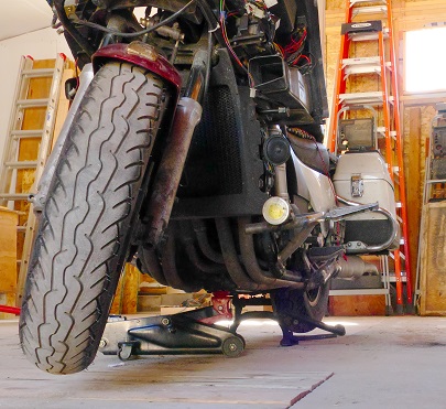

Nails,if I recall,the speedo has to be showing 30MPH to set the cruise,that would be hard to do by hand with the front wheel in the airNails wrote: ↑Thu Apr 21, 2022 12:05 amYeah, all those switches and lights checked out. And I rebuilt most of that anyway, when I moved all that stuff off the tank and onto the left-side fairing.rustynut51 wrote: ↑Wed Apr 20, 2022 9:43 pm mine did that . it was a bad wire at the control on the fake tank.
As the manual points out, there's really just three components here: the control module, the speed sensor, and the actuator. For the control module, all I can really do is check the lights and switches hooked to it. For the speed sensor, I just need to get the front tire in the air and see what happens when I spin it. The actuator has more tests.
- Posts: 1831
Re: cruise control
The test is something like four on-off cycles per revolution -- about page 15-20 in the manual. That low speed limit (for activating the CC) must be downstream, in the control module.cushman eagle wrote: ↑Thu Apr 21, 2022 12:36 am Nails,if I recall,the speedo has to be showing 30MPH to set the cruise,that would be hard to do by hand with the front wheel in the air

The control unit has two connectors, a "6P" one that really has 5 pins but they're labeled #1 thru #6, and a "13P" one with pins #7 thru #20.
Fortunately, mine passed this first round of tests: with the 13P connector (photo in my previous post) disconnected from the control unit, the key “on”, and the engine kill switch to “run”, my CC “main switch” worked (that indicator light came on, anyway). Then, grounding the #7 pin caused the “Set” indicator light to come on. So far, so good.

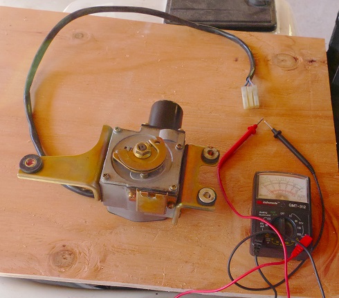

First, remove the actuator from the bike else “the control unit may be damaged,” the cable will be in the way, and some of these electrical tests are mighty awkward. From here on, I’m talking about the 6P actuator connector, the other connector on the control unit, not the 13P. Also, the manual warns not to mess with the pin #4 (BL/W) at all, else you might blow a diode in the actuator.
The first test is resistance between #5 (BL/O) and #6 (BL/R). If this is about 20 ohms, then the Electromagnetic Clutch Coil Resistance is good. Mine reported zip ohms, so I finally figured out why my CC doesn’t work.
I’m done today -- just gotta put the fairing back on. And I’ll be using the VistaCruise again this trip.
Since I’m here, I’ll paraphrase the rest of these actuator tests. Mine passed the next check: that the actuator pulley moves easily by hand and returns back with the spring smoothly. The rest of these checks are onerous, involving putting 12V across various pins, sometimes with an ammeter in series, and checking things like how the pulley moves and whether the clutch locks (see 15-18 and -19 for the heinous details). If any of these fails, then “replace the actuator.” Honestly, I’m a little relieved not to have to run those tests.
