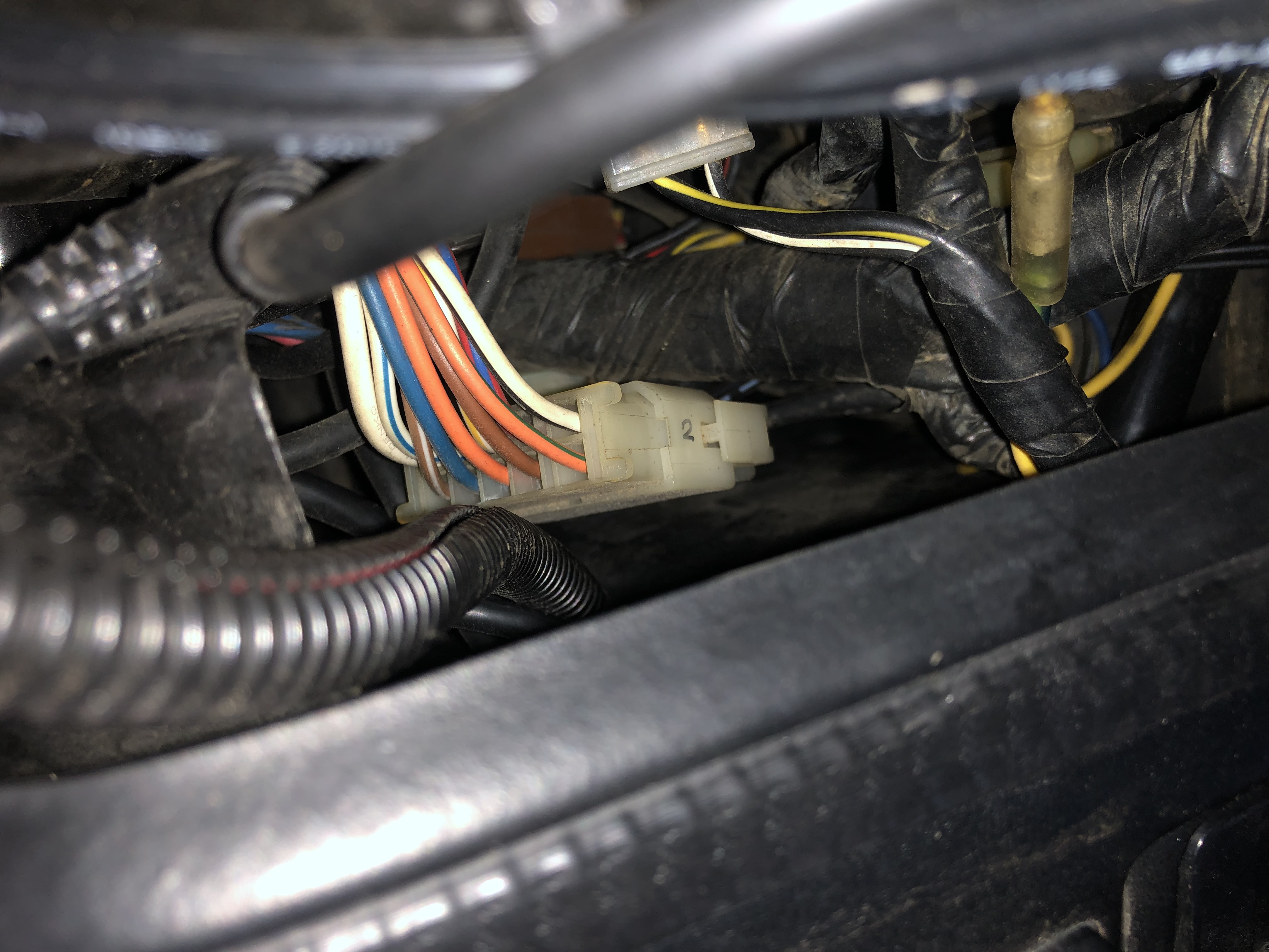

Re: Intermittent Engine Turning Off at Low Speed
Is this the notorious 10 pin connector that everyone criminalizes?
- These users liked Micoproviso's post:
- GrandpaDenny (Thu Sep 01, 2022 2:32 pm)
If the contacts appear clean and no signs of the plug getting hot, intermittent open in the key switch is a common issue. Wiggle test the harness, while idling and see if circuits start to open. Relay issues usually work or don't work.Micoproviso wrote: ↑Wed Aug 31, 2022 4:50 pm

"13-pin connector": Sorry, I've got the cruise control "brain" on my brain these days.Micoproviso wrote: ↑Wed Aug 31, 2022 4:50 pm Is this the notorious 10 pin connector that everyone criminalizes?
It's possible that your bike, which hasn't been used in years, developed more than one corrosion problem. You also mentioned surface rust.
