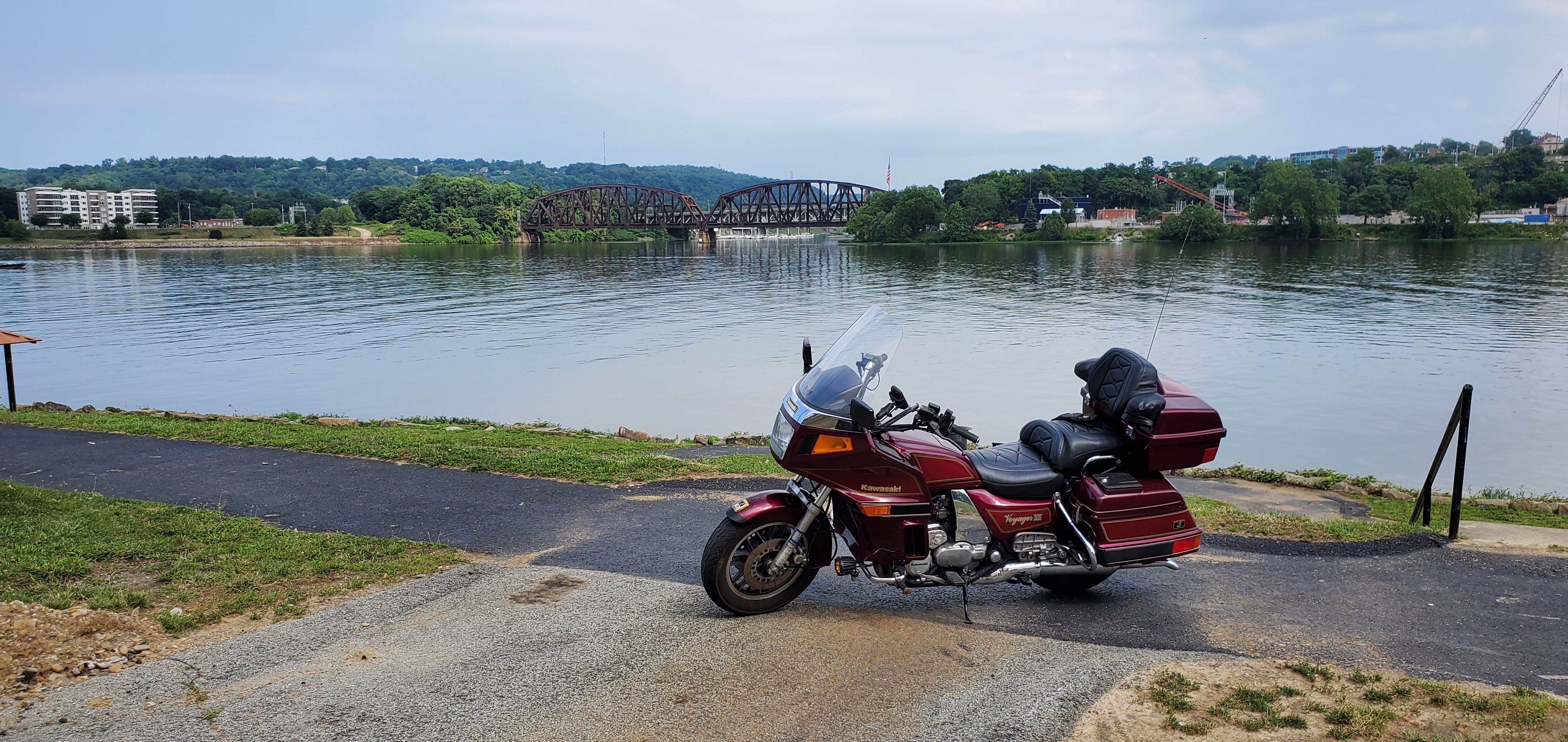

It's been awhile. I think the only changes since i posted last is the upgraded rear shocks to progressives. I also bought a rack and the lower chin fairing that i was missing and got them installed here recently. Still loving the bike. Took it on a 6 day trip from Pittsburgh PA up through PA and NY to Niagara Falls, Over the finger lakes to Watkins Glen. To the PA Grand Canyon, all through north central rural PA stopping at many state parks along the way. Not even a hiccup. Did great. Its becoming my go to bike.
