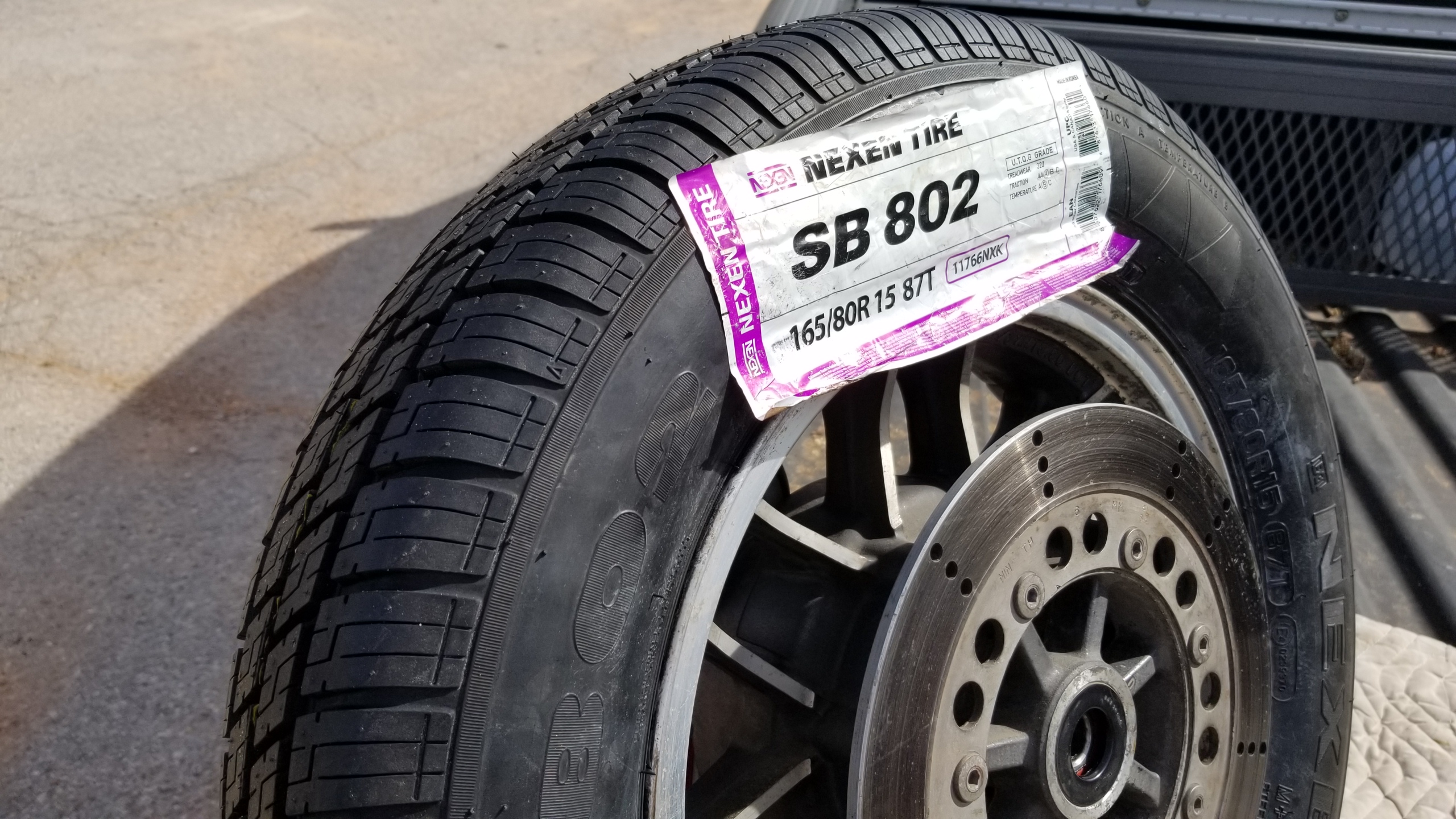

Just mounted my Nexen tire, SB802. 165/80R 15 87T. Would not seat up to 80 psi. 85 degrees and sunny today.
I got out my small air compressor that has a pressure regulator. I used a 4 foot hose so the pressure would be the same
as the regulator showed. I also have a clip-on air chuck. My brother suggested putting a strap around the tread so the tire could not expand in circumference. I set the regulator @ 100 psi with the wheel on a small diameter metal trash can. Plugged in the air hose and got back. Didn't see how high it got but one side popped very loud, a few seconds the other side popped. I let you know how I like it soon.

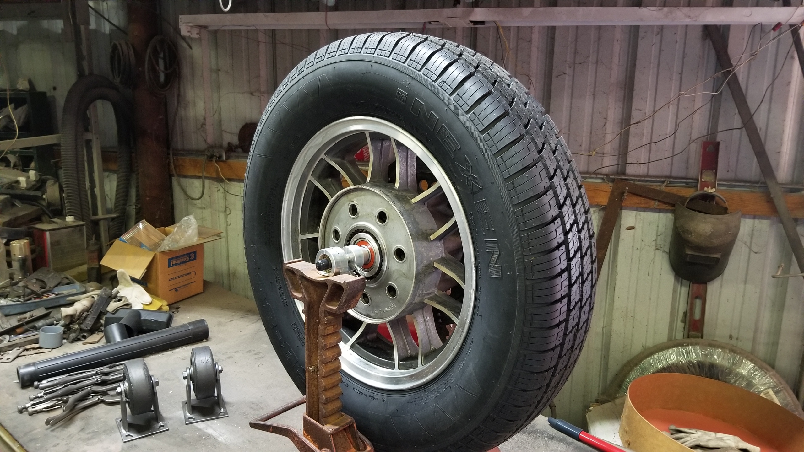

I usually end up at about 100# on the federals and 120# on the Nexens to seat the beads.

Yup. About three times my 46# running pressure, But that's what it takes to get the beads past the 'bumps' on the rim,
