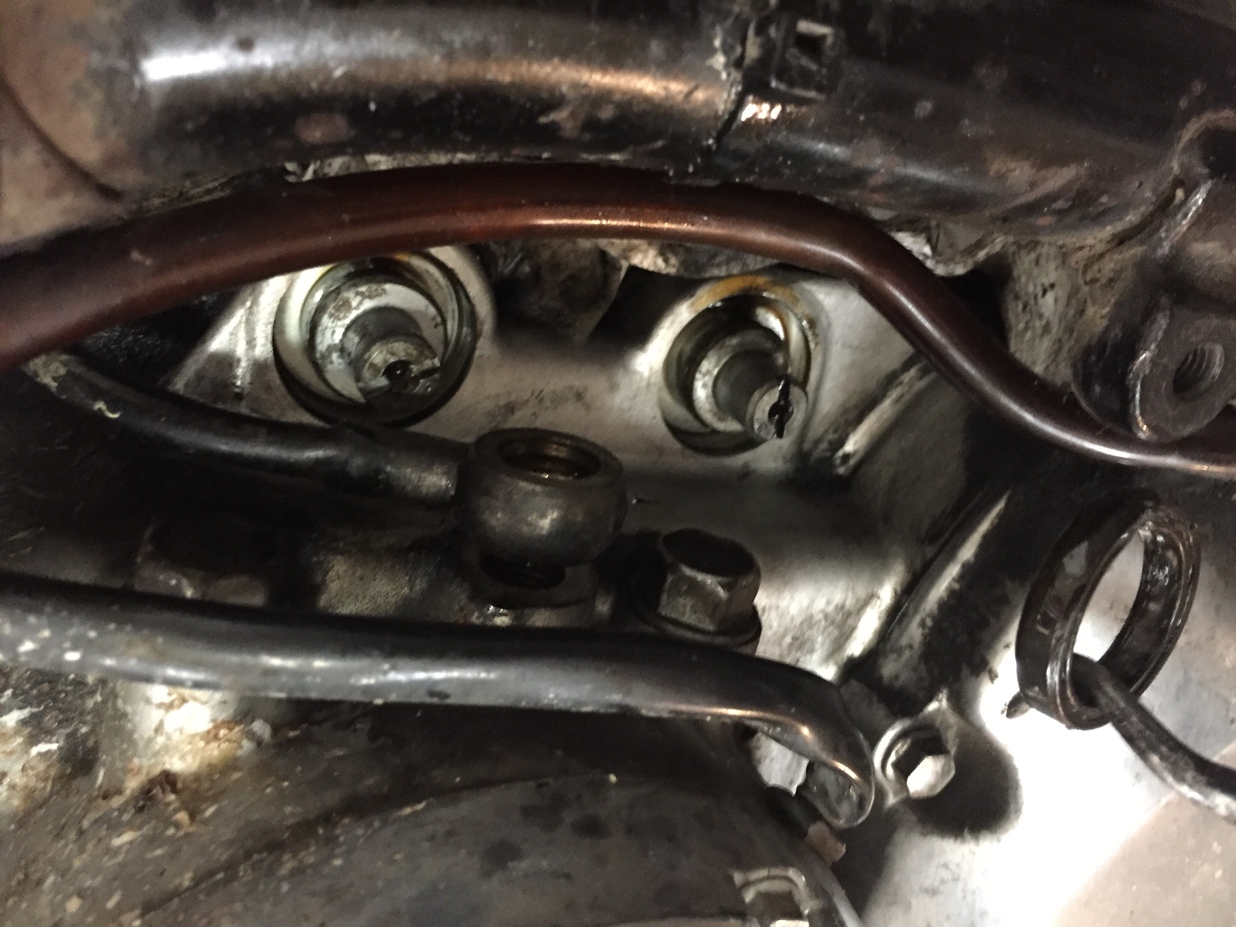

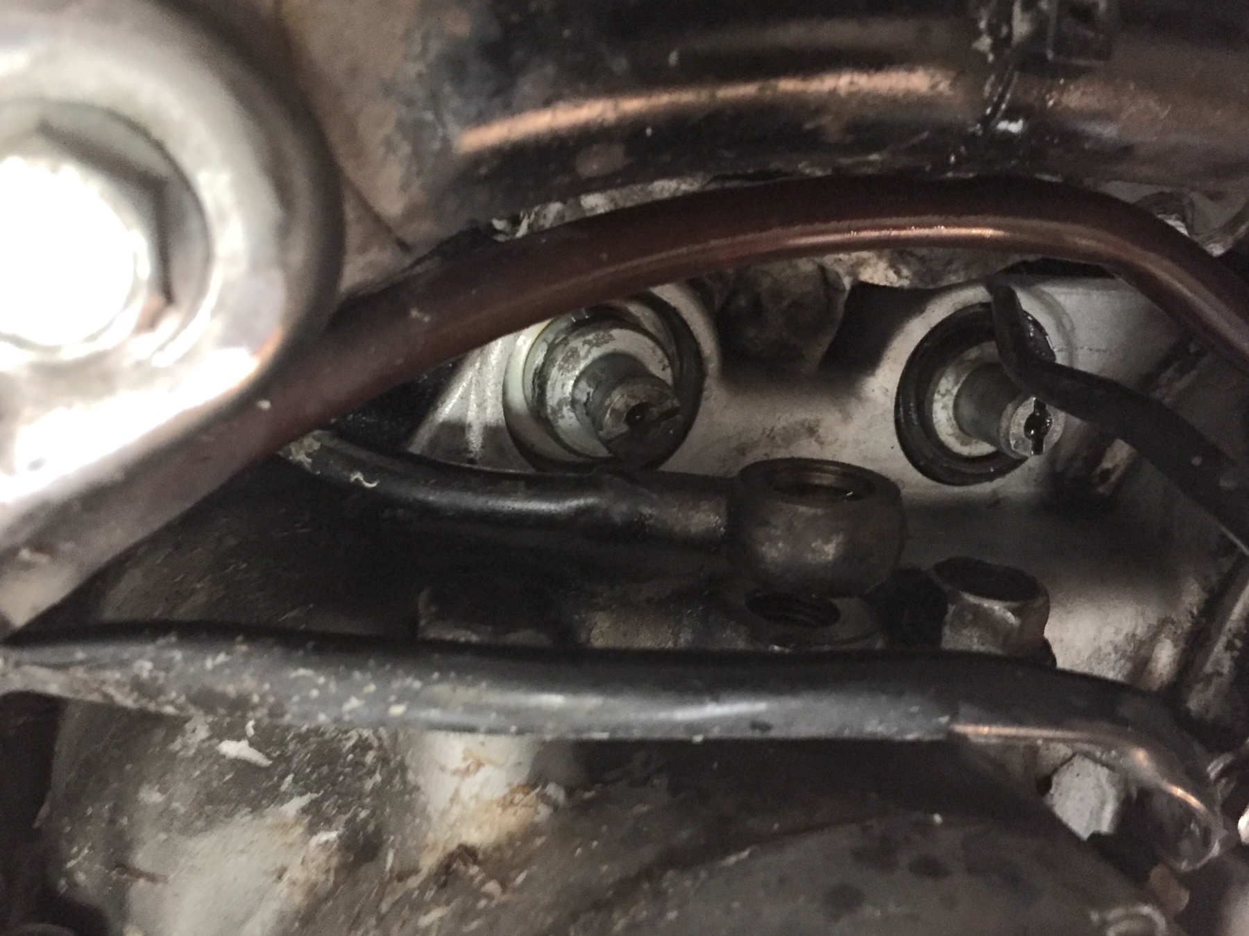

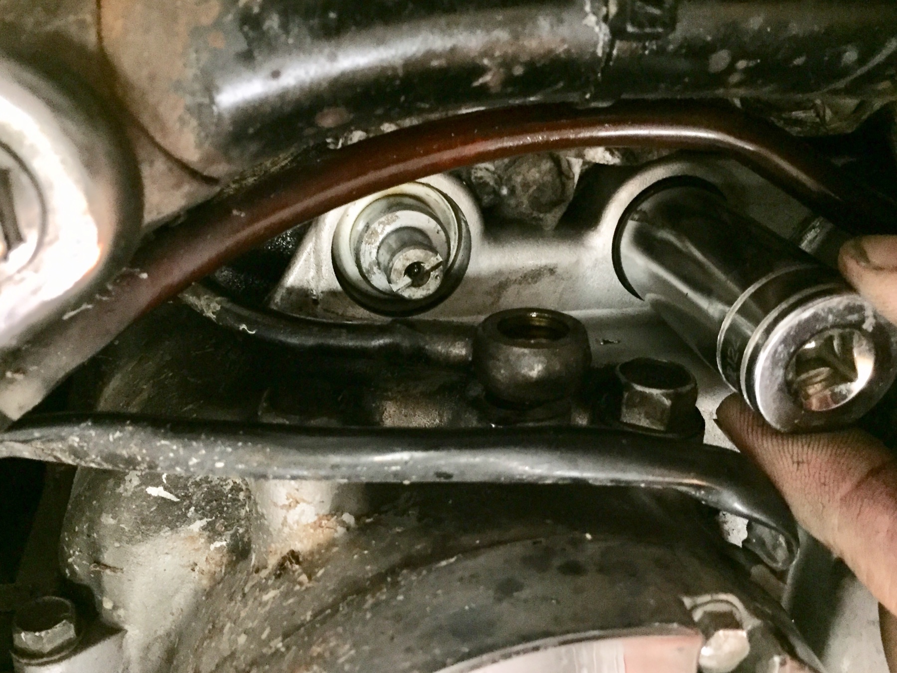

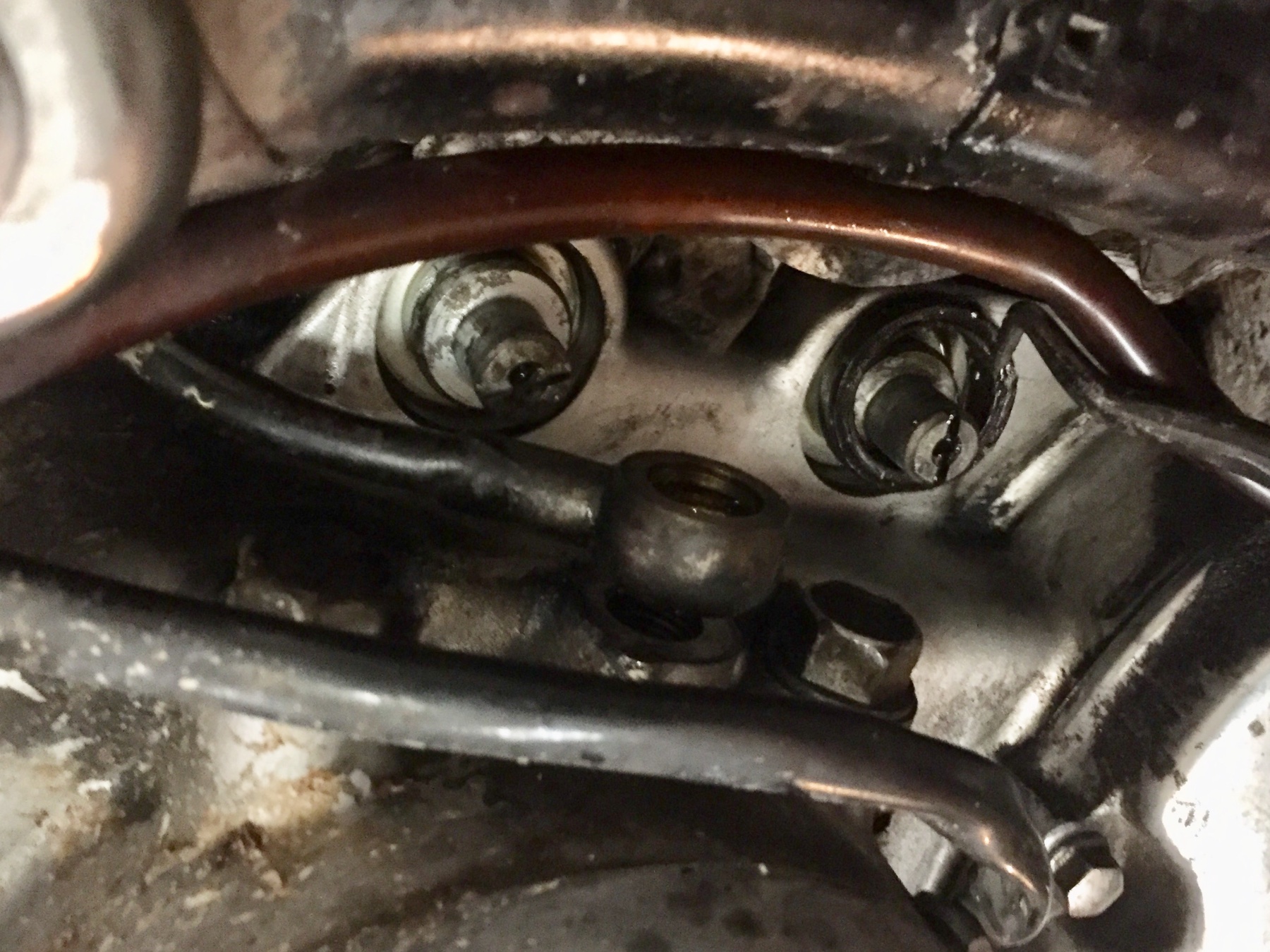

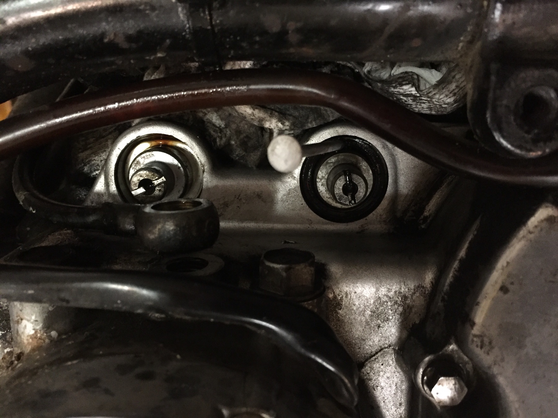

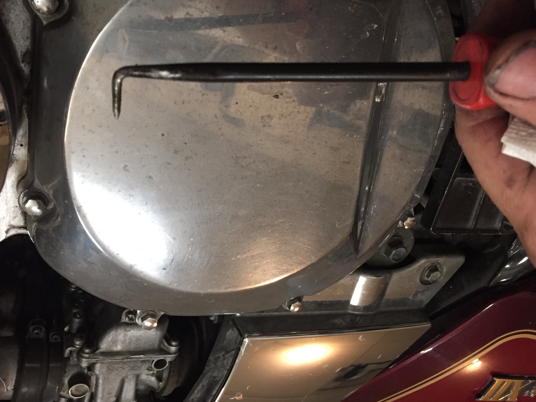

Actually the balance shaft seals aren’t that bad. Mine took to leaking last week. I just changed them, took about an hour, and I wasn’t rushing. Took off the brake pedal, and peg. Loosened the oil line clamp, as the bolt looks trapped by the exhaust. Remove both oil line banjo bolts. Took off the balance shaft clamp, the shafts can spin easily after this. Punctured the middle of the seals with a nail, to let me get my cotter pin hook engaged. Lightly tap the cotter pin hook in and Bobs your uncle. Then just install and lightly tap it in to seat with a socket.
Why do all my photos load upside down and out of order? I even flipped them over in my photo editor, but same result...

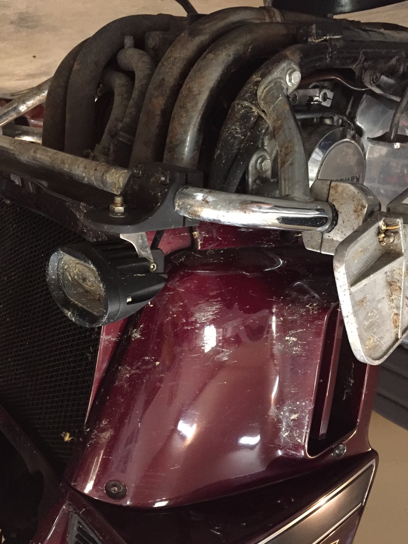

Now it’s bath time for my therapist (bike). Sorry, one or more grasshoppers may have been injured in the making of this mess.
