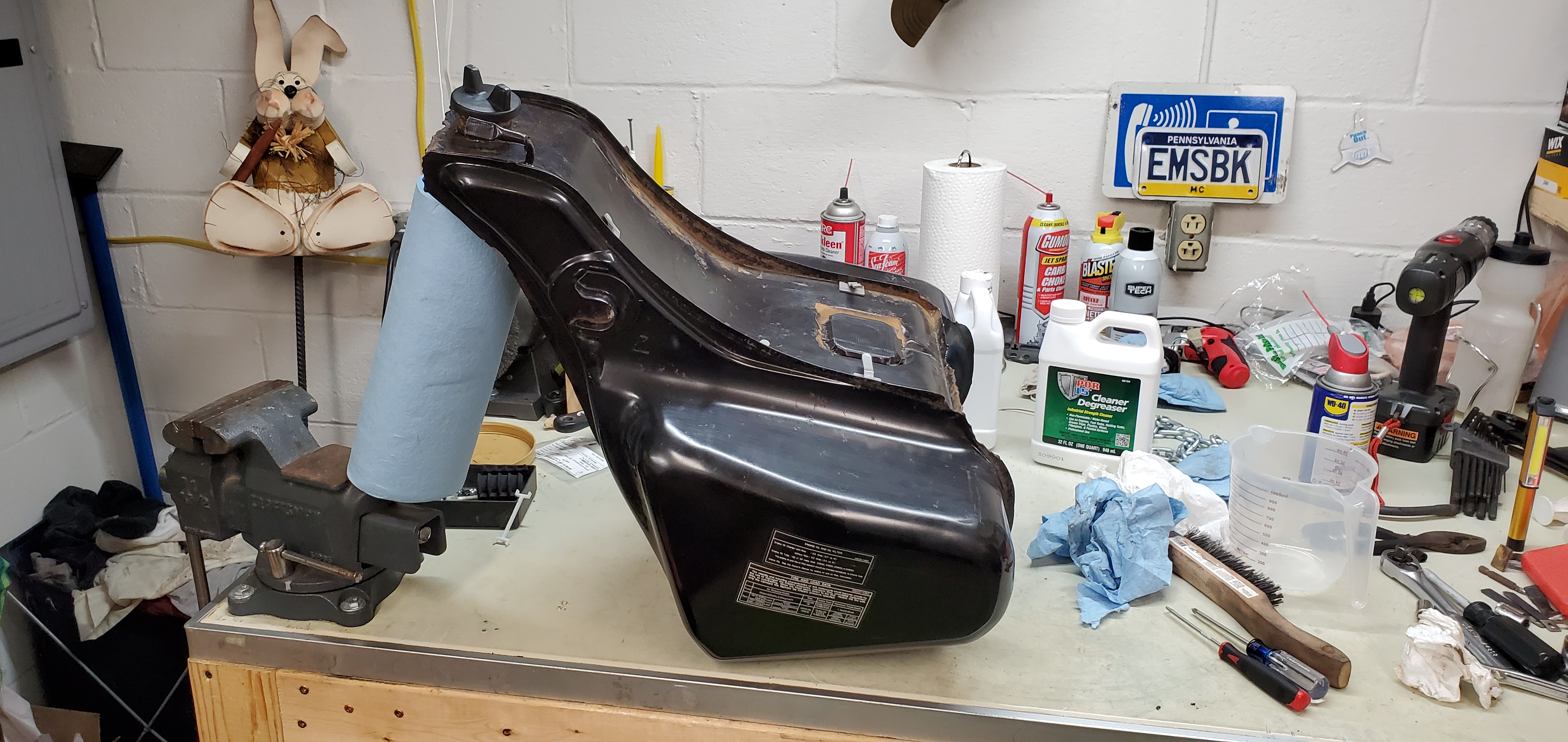

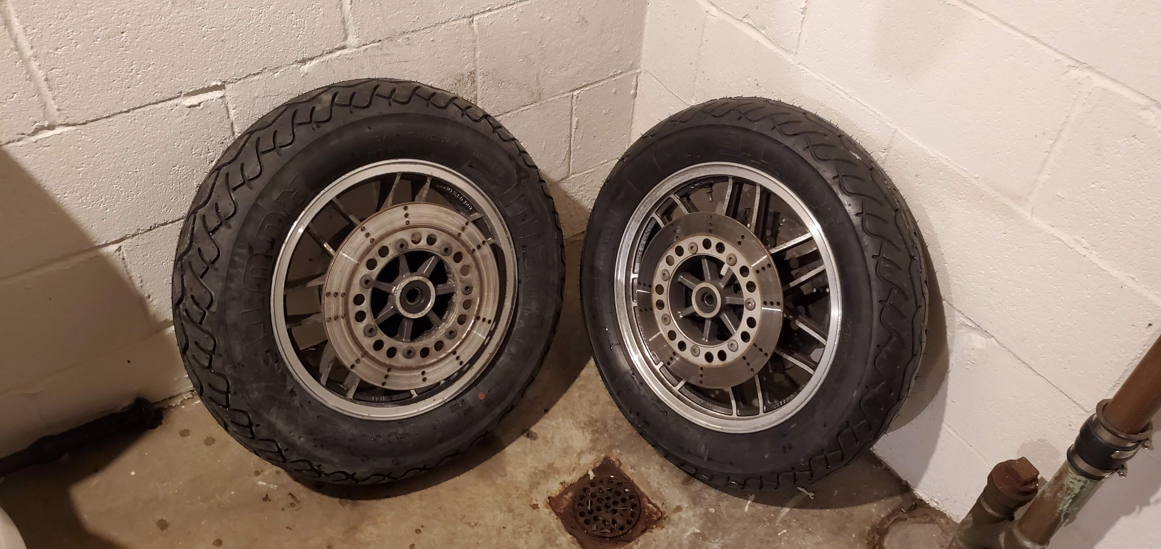

My kawasaki part order will be here saturday, new tires today. I ordered the POR-15 tank cleaner/liner kit. So i should have lots to do coming up.

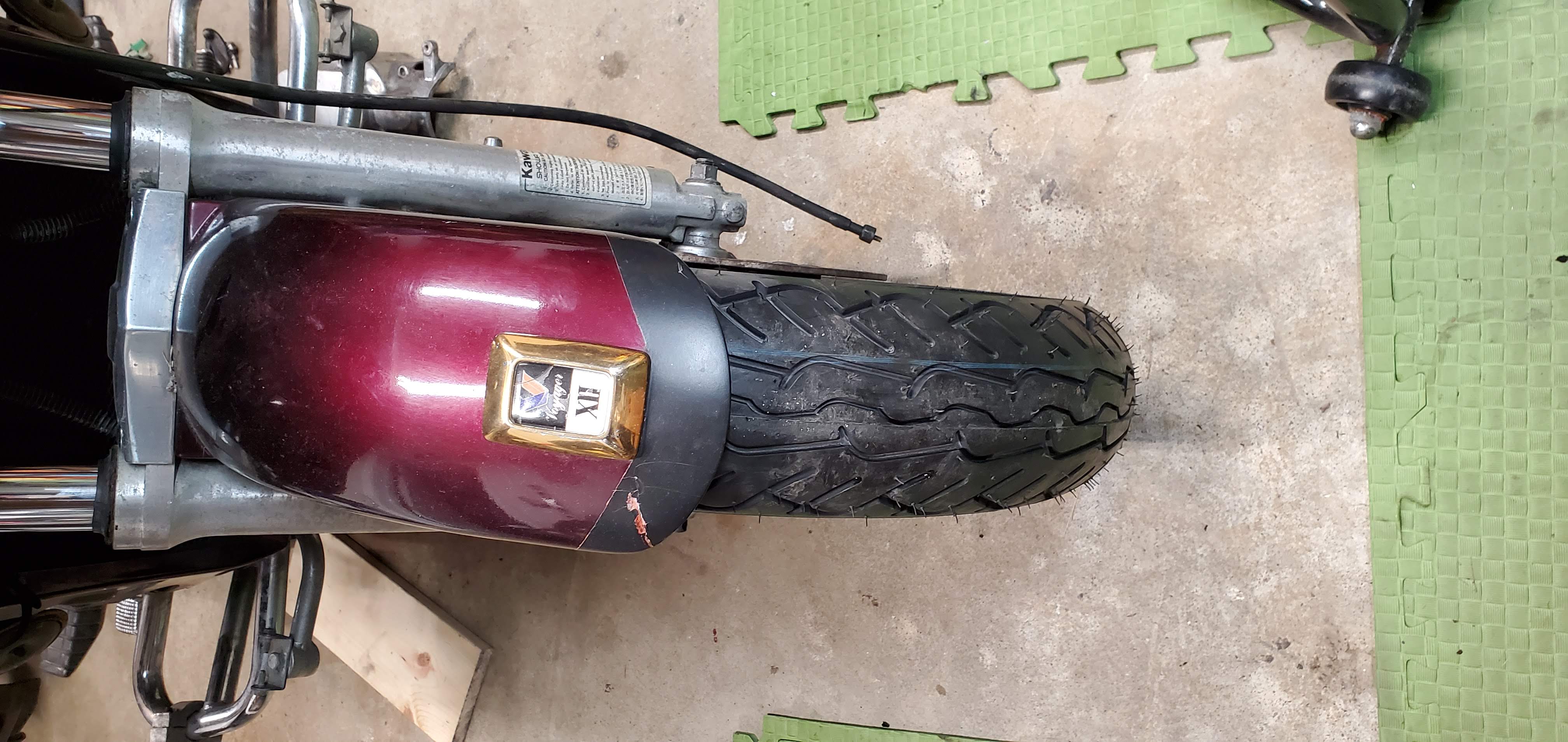

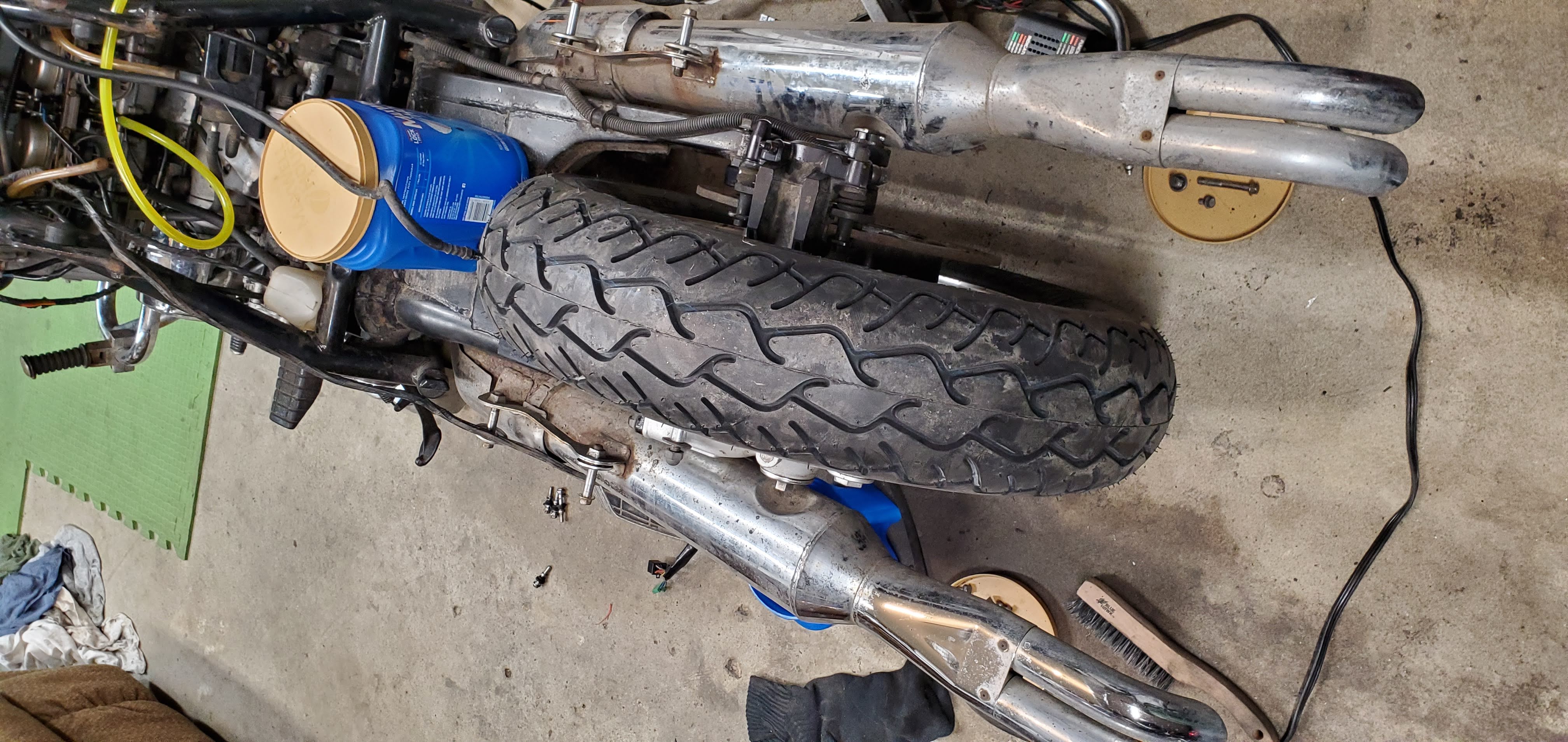

I got the new tires installed. The front tire was a pain, it wasn't sealing enough to hold air. I had to do the old carb cleaner explosion to get it to seal. Got them all cleaned up too. I don't know who had this bike, or where they rode it, but man its boggling how dirty it is. Waiting on the gas tank cleaner and sealer to do that next then i think i can get the tank back on the bike. I'm still trying to figure out how all the body fits on and what fasteners I'm missing. My first order for things showed up. I had to buy the air filter and those little hold down pieces, I'm not sure i know how that goes together either.

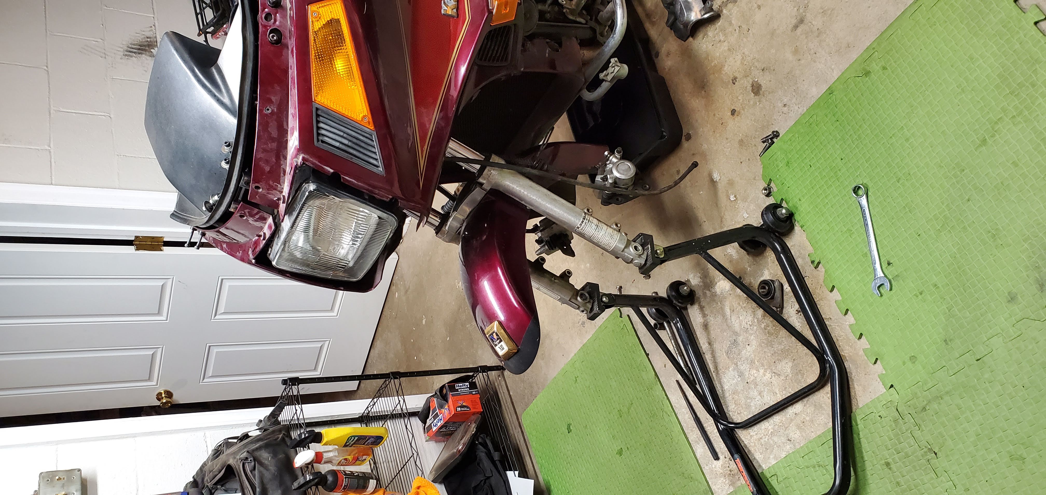

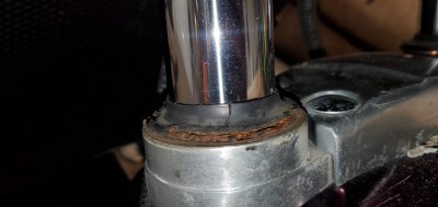

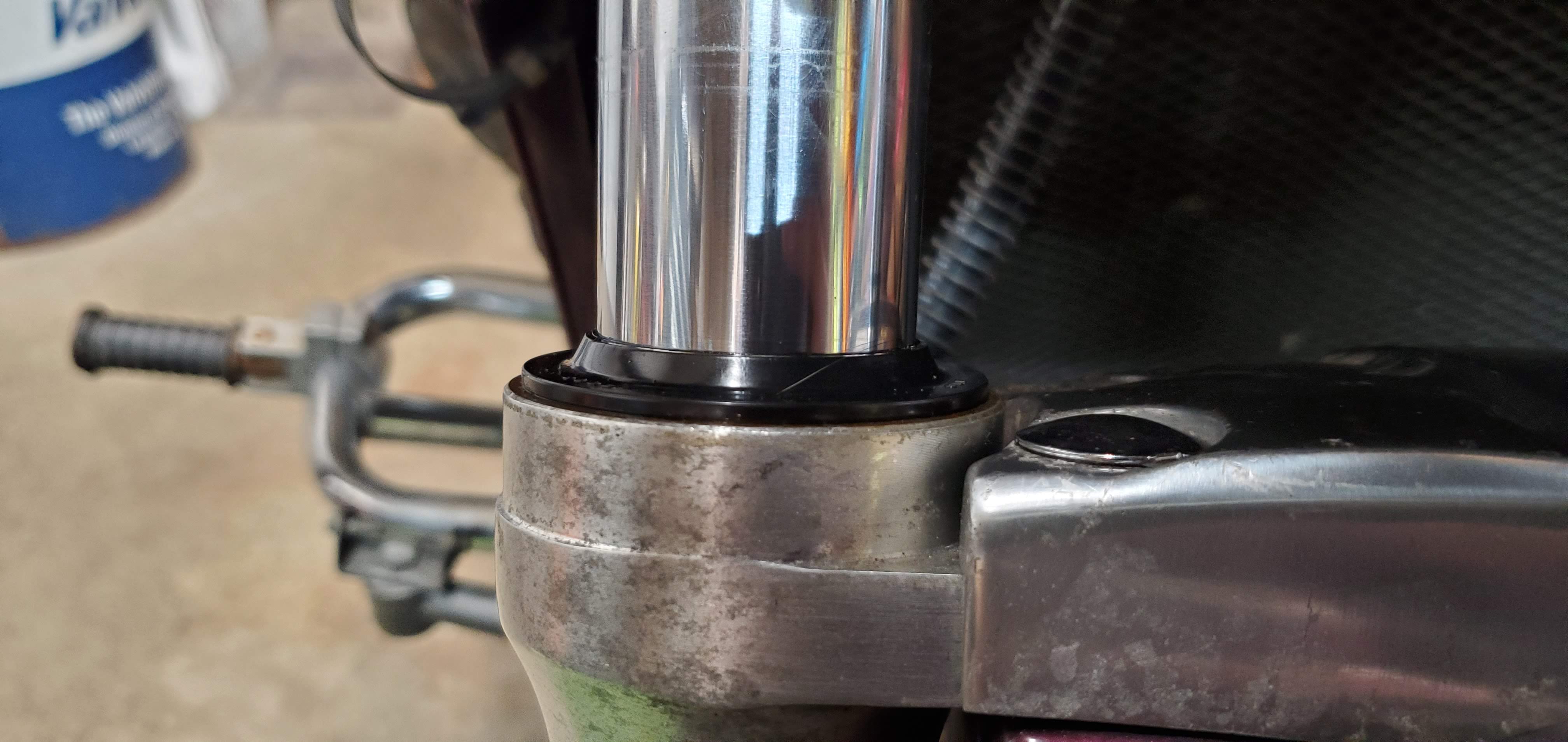

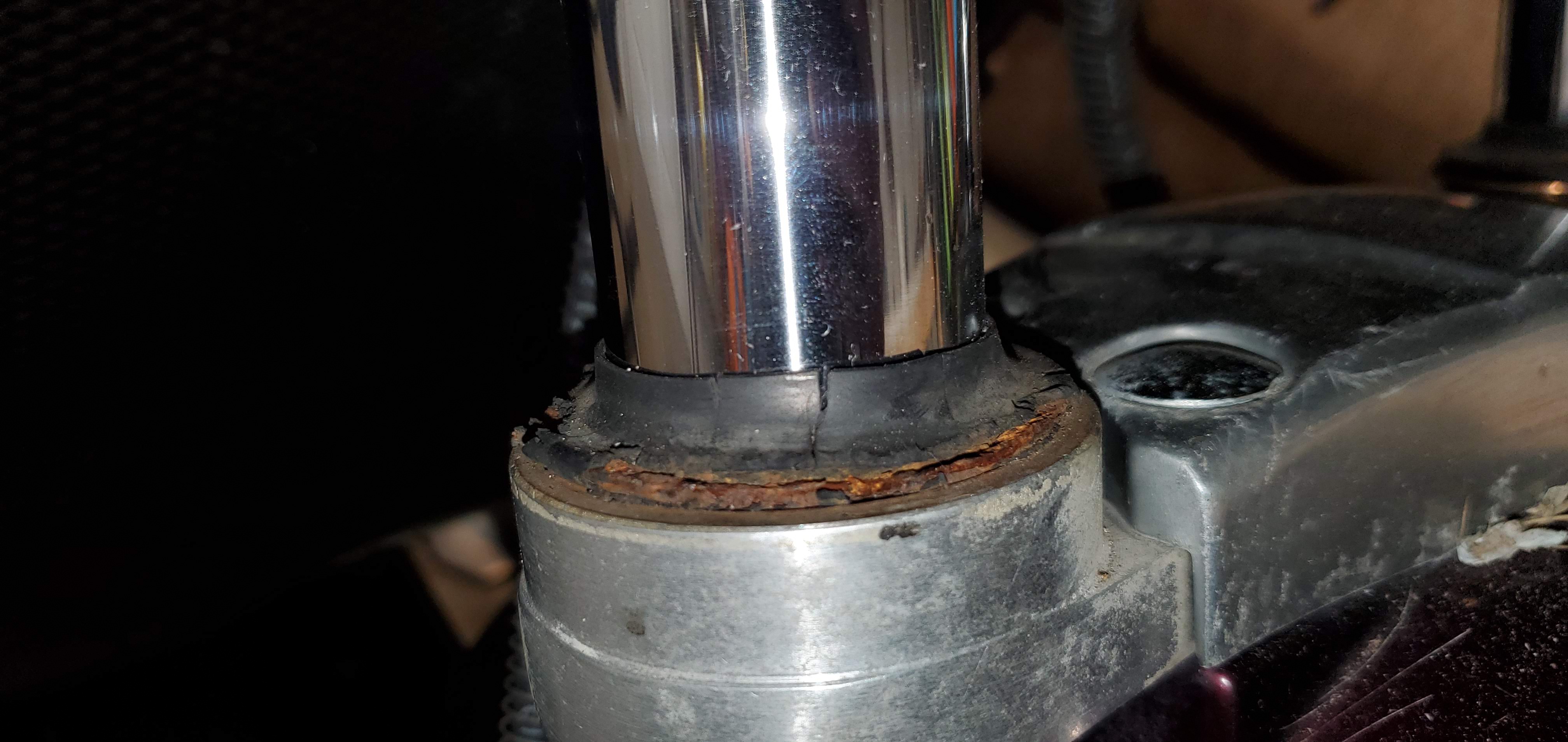

Based off of how the dust wiper looks on the fork i decided to start taking the forks apart to change the seals and put new oil in. Started that process last night. I got the rear shocks full of oil again, now i guess i'll take out the 160mls. That is the strangest way to change oil. Anyway, i need a longer allen bolt socket to get the forks apart so I have to wait for that to show up. I can start the gas tank cleaning now though. Once the tank is clean i can put the tank back on along with the subframe then the airbox. Its coming along, i have got a lot done, but still much more to go.

Prepare to hear a thousand times the glories of Progressive springs. Some have gone all the way to cartridge emulators, reporting excellent results.
And if/when you dump the front air crap, consider leaving the air line intact to allow periodically bleeding off accumulated pressure. But I recommend shortening it to minimize the headspace volume -- this factored into my decision to use factory fork oil levels instead of the larger volumes that many otherwise advocate here.
I do my own wrenching, but I'm happy to take the forks, new parts, and new springs to a shop. It's just too easy to cross-thread the caps. But there are posts here with tricks. My favorite is to leverage a 1/2" drive socket and breaker-bar against the handlebars -- I found a way to make that work. I mean, don't remove the handlebars too soon. I also advocate Dextron instead of real fork oil. If my next suspension-oil change (I use it in the shocks, too) comes back clean, I might go back to fork oil.

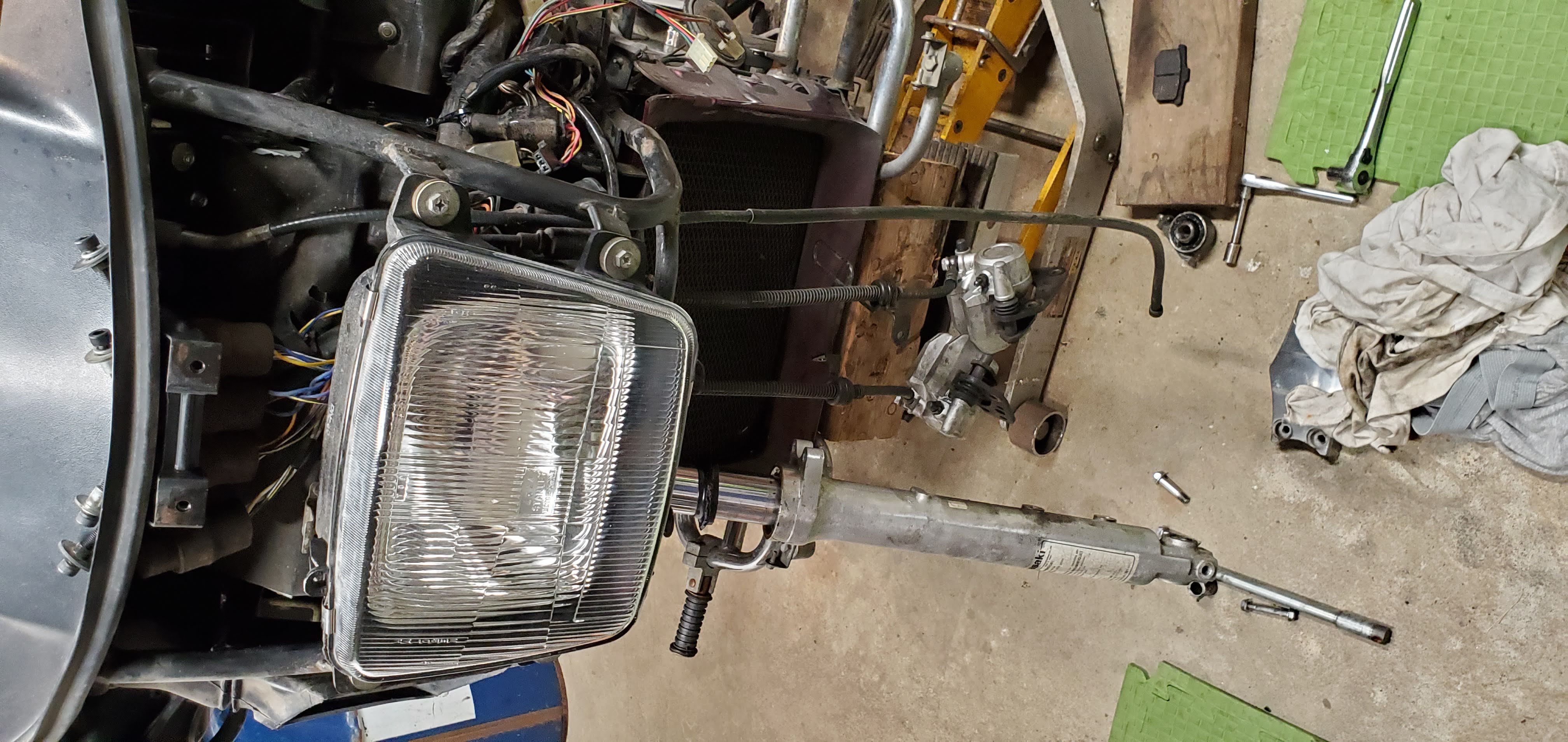

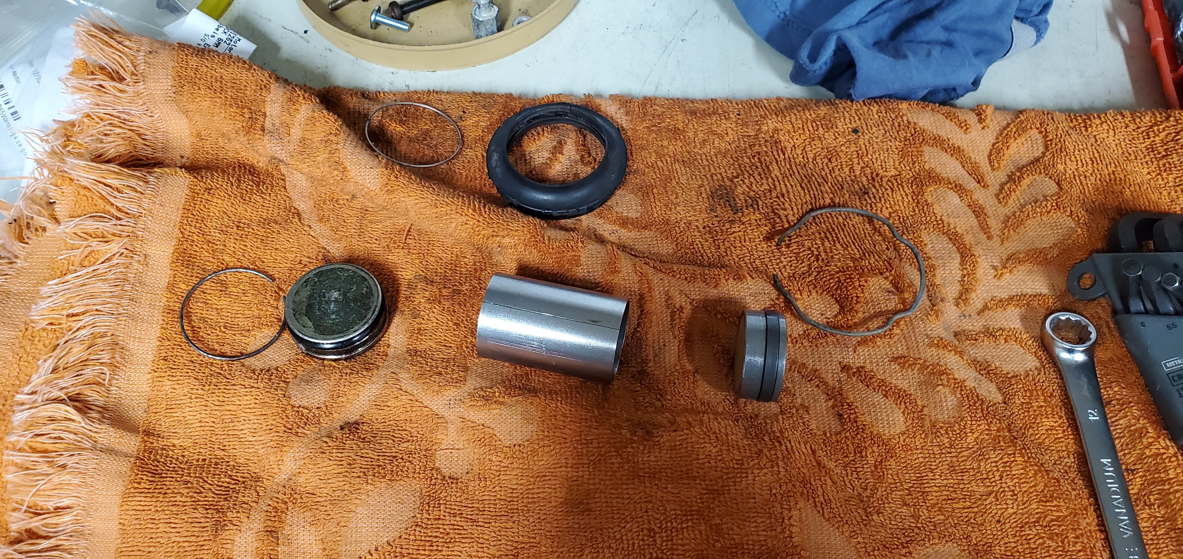

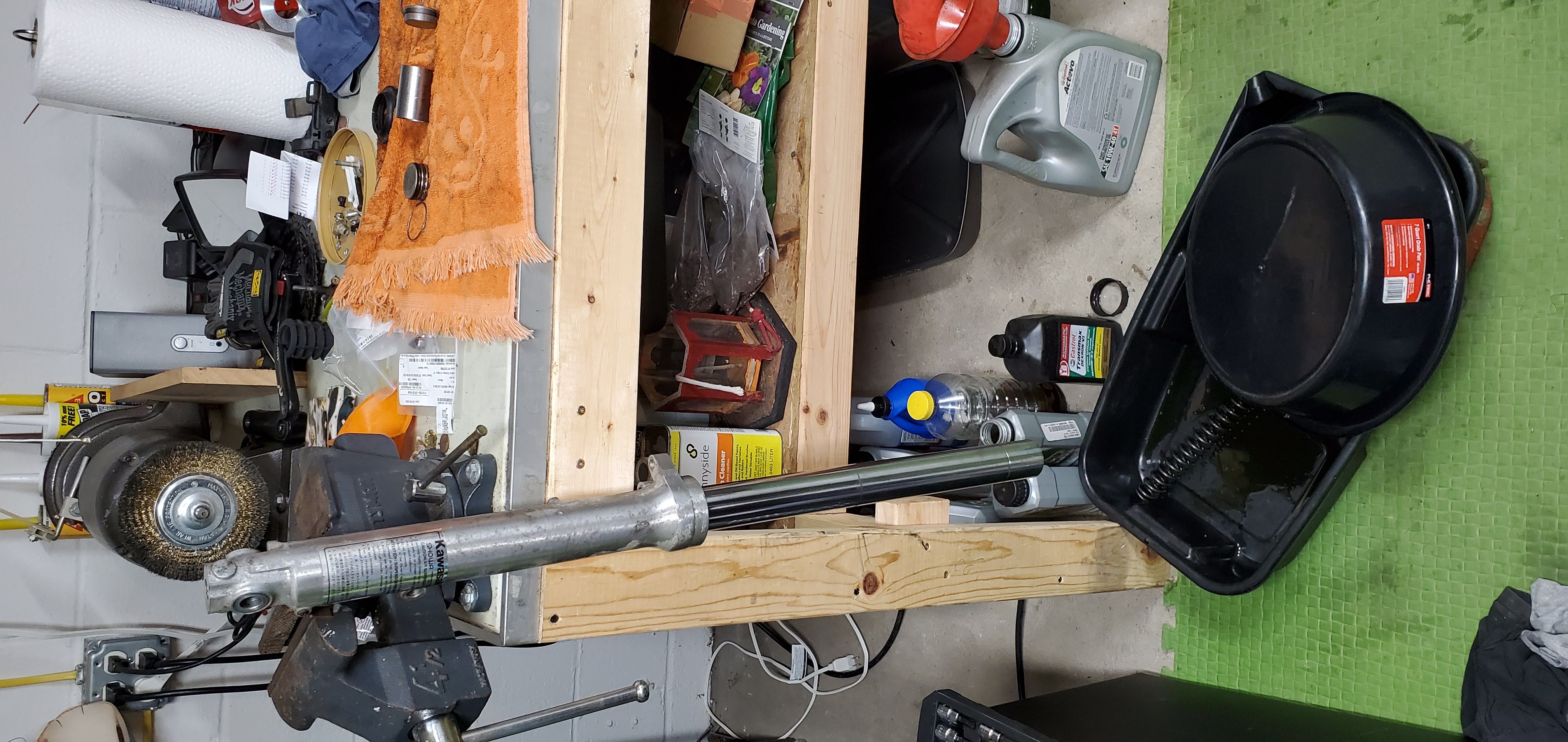

The forks were not too bad. Its just strange they did not put threaded end caps on them. The retaining clip under pressure is strange and much harder to deal with, but not impossible. I had to wait for the new fork seals and a longer hex socket to get here to get the forks done. I did use dextron in the forks.

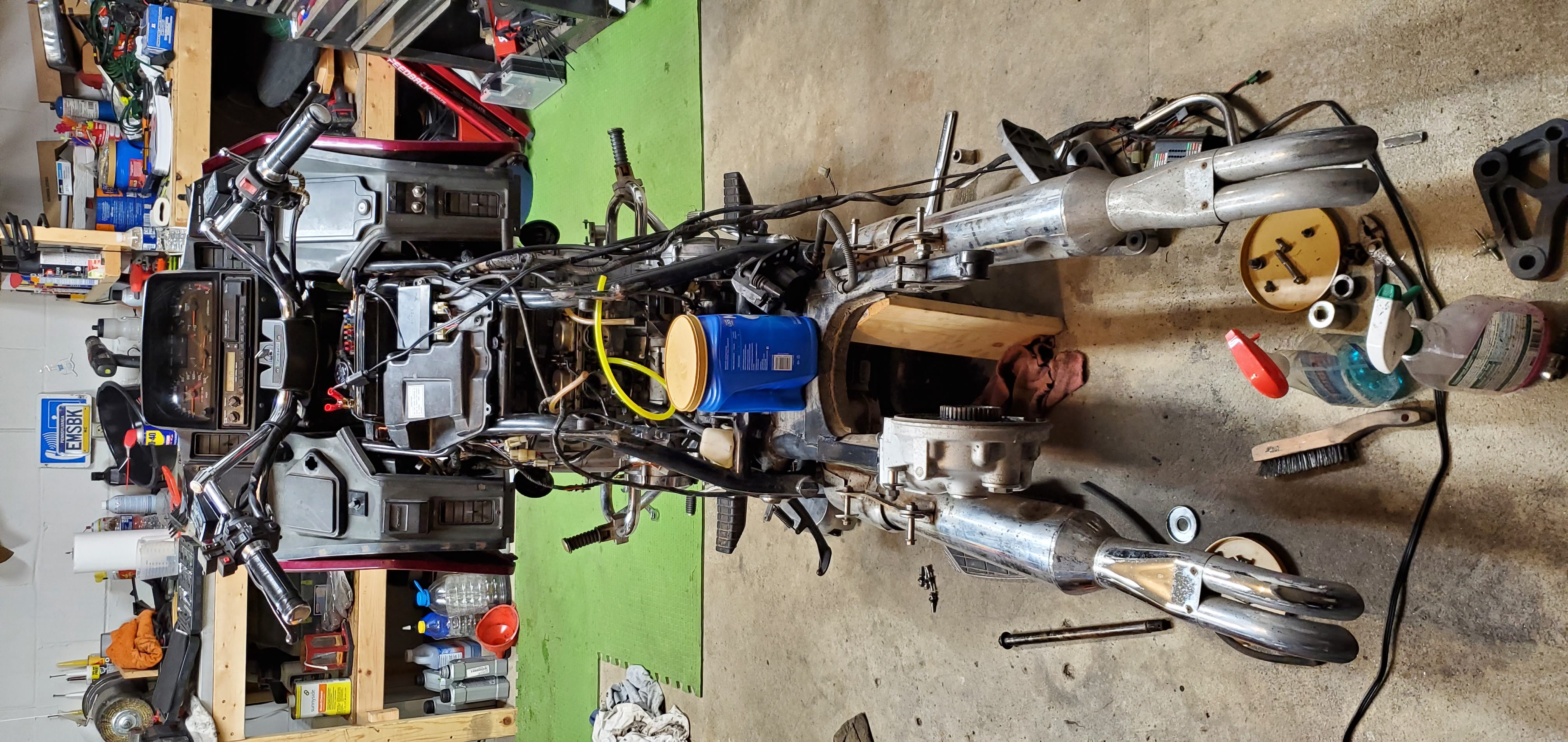

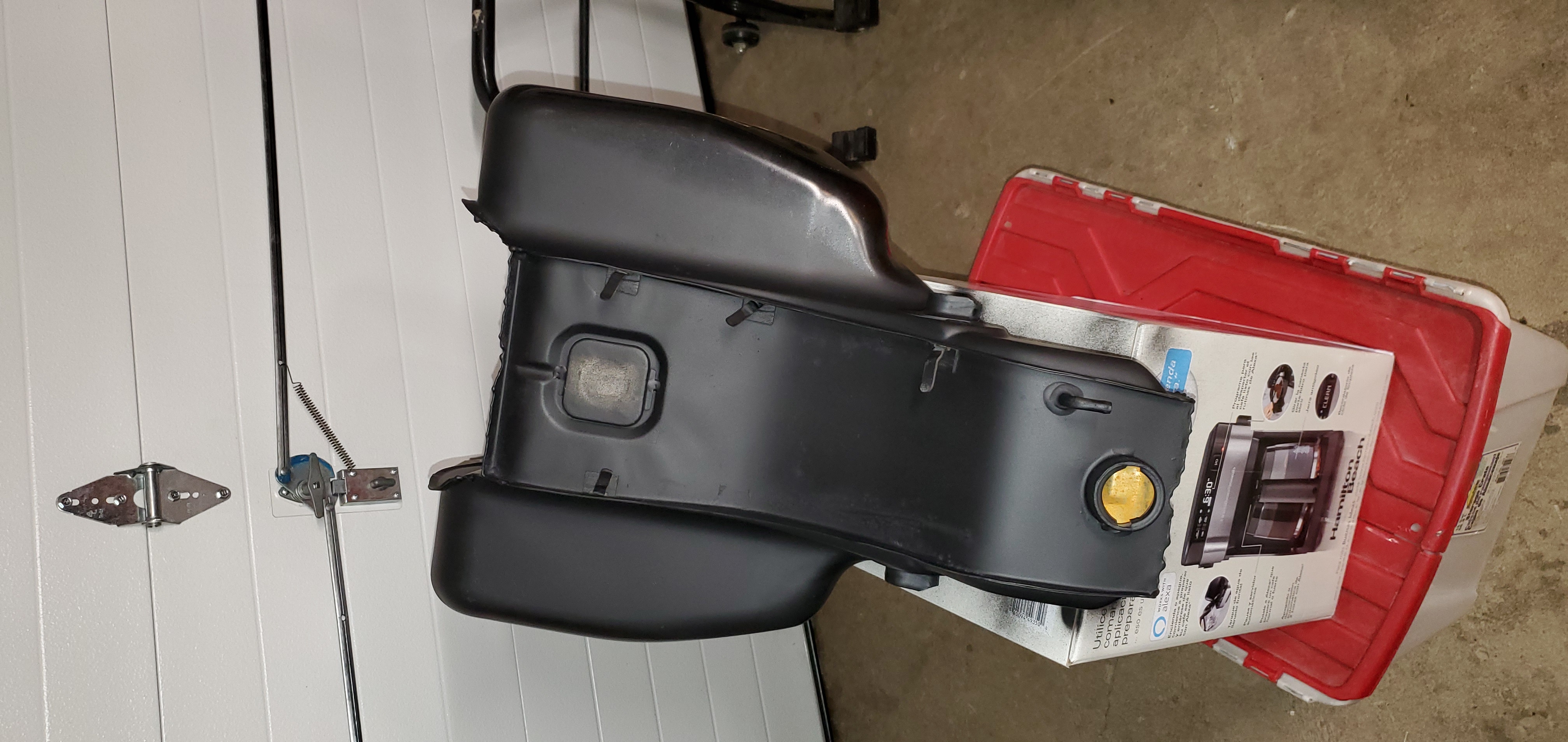

It fires right up when i try to start it. So i think i can start reassembling. The next thing to do is the gas tank. That's going to take a serious time commitment.

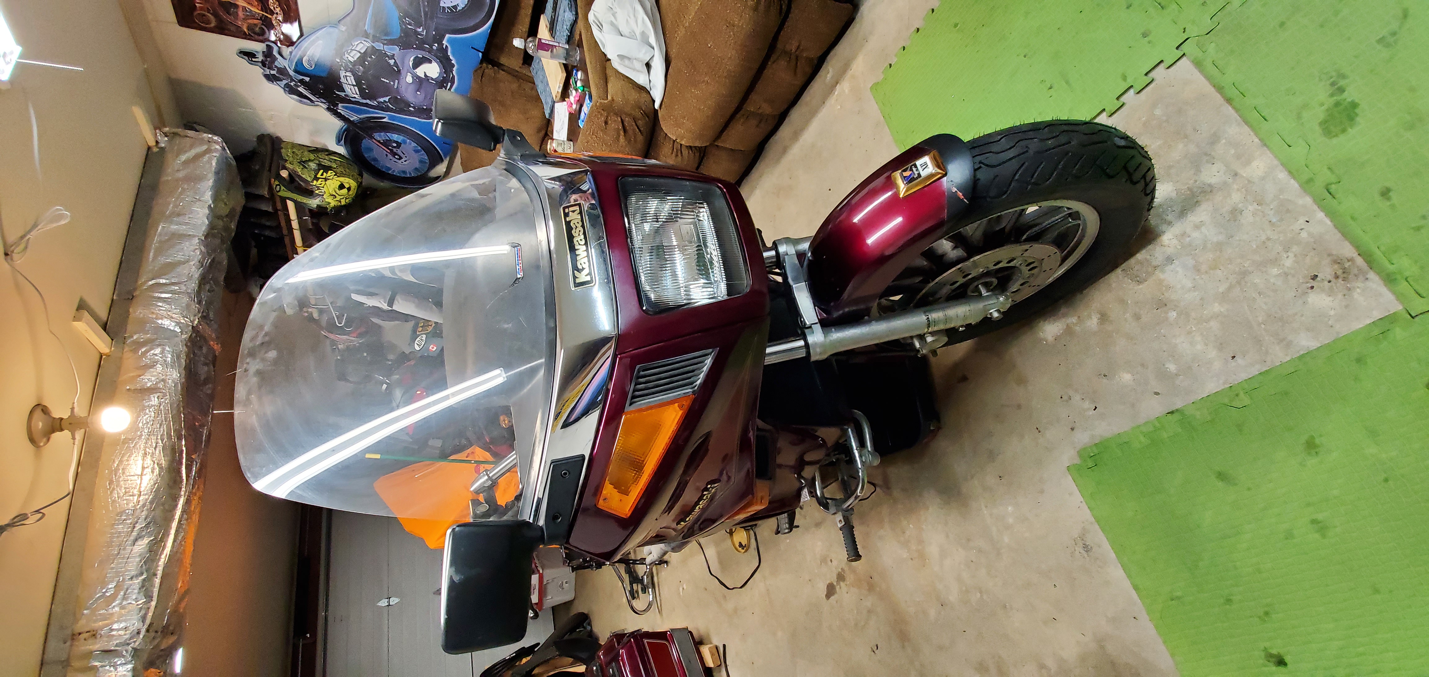

Before and after picture. Looks a little better.

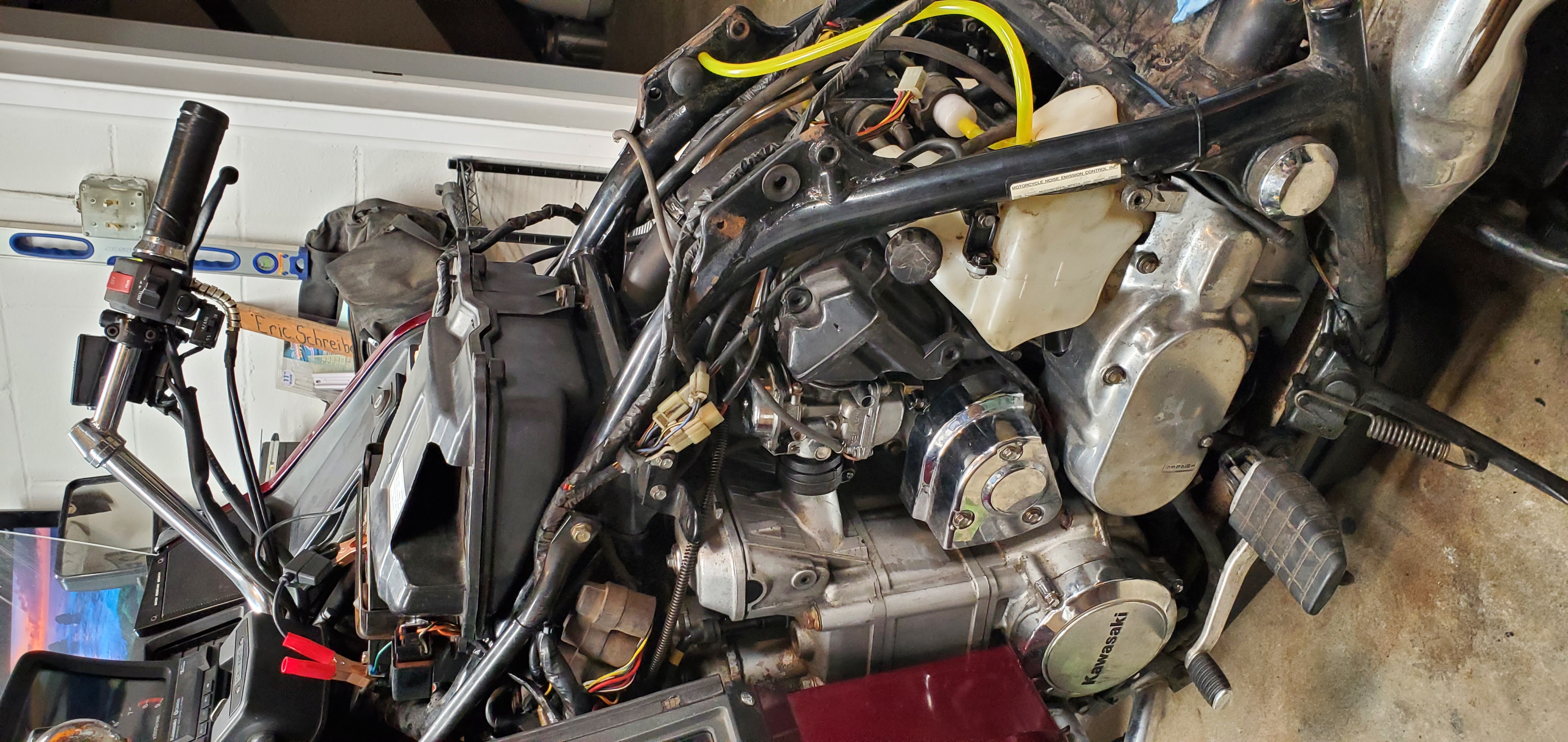

Can anyone tell me what's supposed to bolt to the airbox next to the ignightor box? I see a threaded hole there but no idea why. Thanks.
I got all the intake back on. Painted the tank with rust killer. Got the whole front body back on to see what parts I still needed to order. Today I will paint the tank gloss black and start the metal prep step of the tank lining.

If it's the hole you mean, I remember a clamp there for a battery cable, vent line, or something. It doesn't work very well, and often not at all.

Thanks! That's on the dirty side of the filter, no need to plug it.
I got the tank all painted gloss black. Continue the lining today. I fired it up with the whole intake in place it sounds and runs alot better, without the airboxes I'm sure it was getting too much air. I'm getting anxious to actually ride it! I'm getting close.
