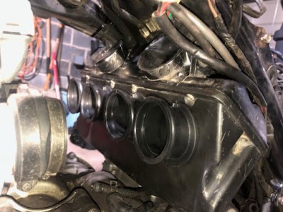

The new lower airbox (aka known as the "surge tank") and new boots (aka "carburetor holders") in place awaiting carb placement:

Latest update: the boots are, according to my buddy doing the work, a pain in the kronk. He says that's been the only difficult part of this whole adventure. He says these machines are easy to work on. That's compared to Concours 1000s and 1400s.
I'm going to be paying this guy for a long time for this job.
Looks like he's got the carbs in and will be syncing them tomorrow evening after work. Y'all would have loved the text messages going back and forth about putting the boots on:
Wayne from COG: I'll be heating the boots up before dropping in the carbs
Wayne from COG, I won't melt them lol
Me: lol
Me: little vaseline or KY might help too,
Me: oh you said "boots" not "butts"
Wayne from COG, Lol OMG
Me: anyway, seriously, a little water-soluble lube of some sort might help
Me: even some soapy water
Me: or alcohol. Kinda like putting new grips on
Wayne from COG, Yes 'some' lube ok,
Wayne from COG, I am very cautious in introducing anything that is not supposed to be in the air/ fuel mixture.
Me: well you put the lube on the outside of the carb and it won't get into the airstream
Me: or a very thin layer on the inside of the boots, Sunday, April 2 2023, 2:28 PM.
Me: soapy water will dry up. Alcohol will evaporate.
Me: Like doing grips. Even spit will likely work.
Me: I don't care if you spit on my new carbs, they're going to get dirtier than that LOL Just don't spit on the shiny parts LOL
Me: Brake fluid doesn't eat rubber so you can use that, too.,
Wayne from COG, All good suggestions.
Wayne from COG, Well other than brake fluid, duck screwing around with that stuff.

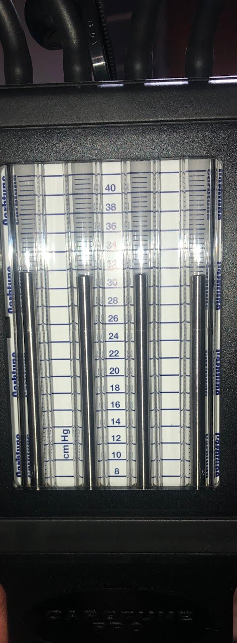

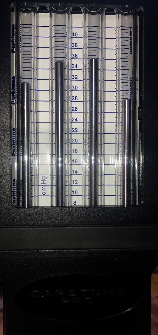

Carbs are in. Bike is running. initial vacuum readings before carb sync::
After synchronization:
