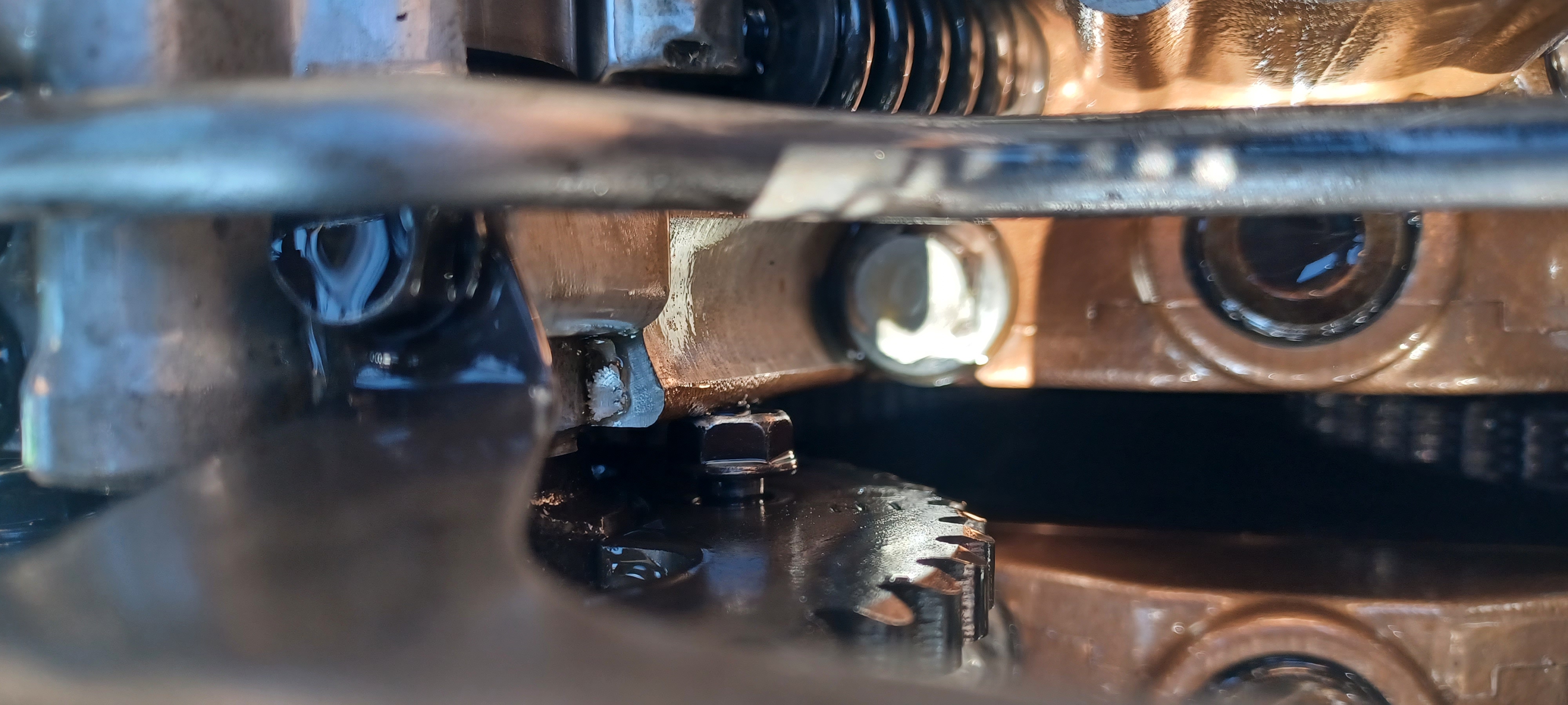

Re: Hi from thhe UK
Ther was the noise,cam chain sprocket bolts on the ex cam were loose and catching the casing
Zoom in to middie But I cannot thank you enough for your support and guidance and advice along this path.
Thanks Nigel
Thanks Nigel
