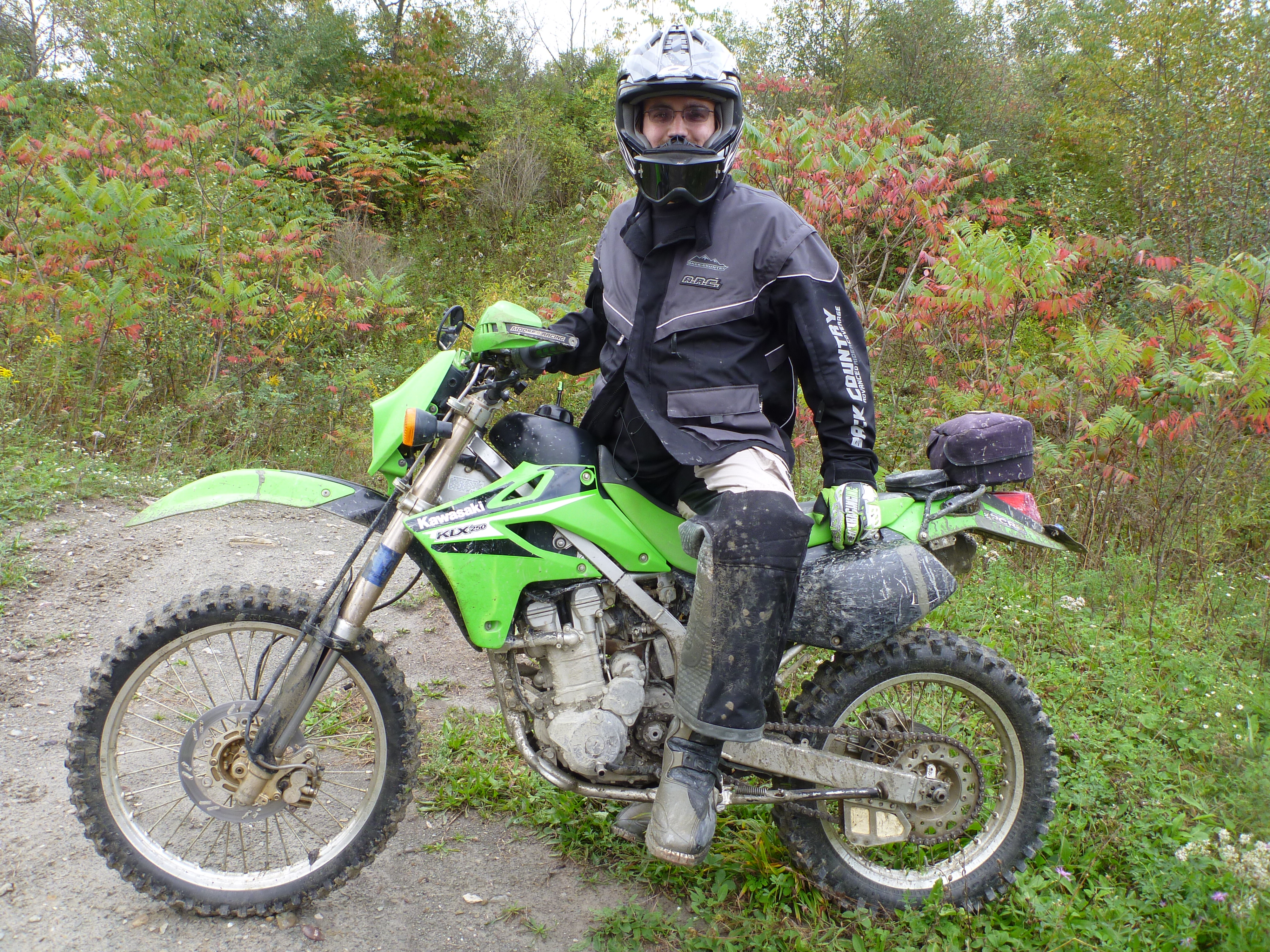

I greatly appreciate all the help guys. My first motorcycle was a 2006 KLX250S Dual sport. I had that bike until 2018, it was a 250cc and i put a bigger cylinder and piston on it to make it a 350cc. I also did just about everything you could do to it. Suspension, carb tuning. I have a 1998 KLR650 that i also made a 685cc and have done suspension on. My second most recent purchase is a 2008 650 Versys. I know the value of people that know specific models inside and out. A few other older honda street bikes.

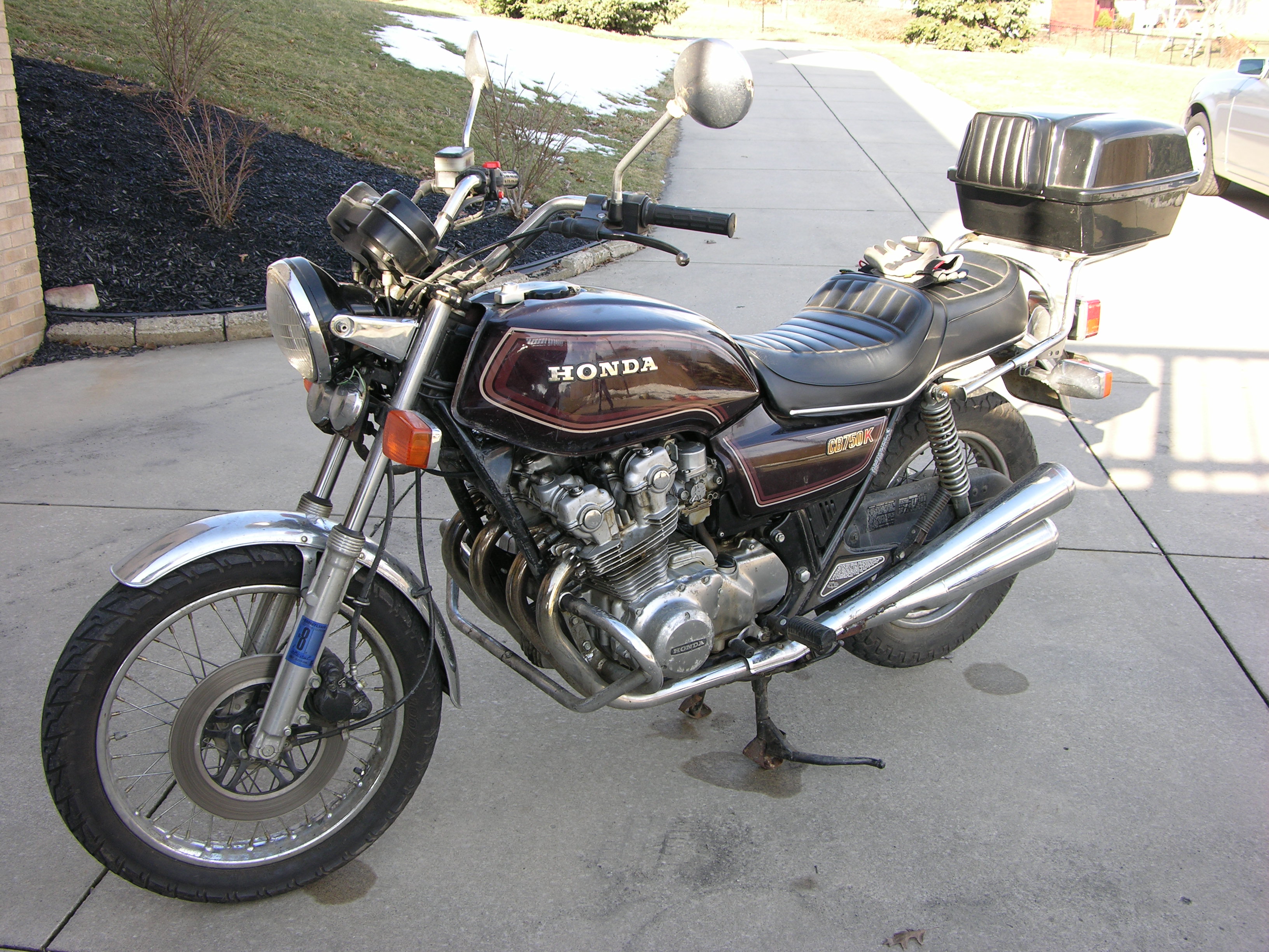

I had a 1979 750K (pictures in the link, when I put her up for sale): Vindicator fairing, Lowers (Goldwing model, cut to fit the CB750K), similar trunk to your's, soft saddlebags, and a thermostat controlled Oil Cooler, with a spin-on filter adapter. She was a beauty! Sold her off two years after we got the Voyager: it was dry-rotting in my garage, as we loved the Voyager so much, we never rode the Honda anymore. I still miss that bike. It was like riding a fighter jet, after riding the Voyager: so light, and much more nimble. The KZ440 LTD was even more nimble, and lightweight -- I mostly missed my turns because I was literally LOL'ing in my helmet, having sooo much fun riding it, flying through the soft-butter gear shifting on it (6-speed).
Don't get me wrong. I love our Voyager. It is just in a different class than my previous two bikes. Each has their charm, each was fun, within their class. I prefer the Voyager, as we like to ride long distances, and she is designed for that, with comfort, power, and fun... Cheers!

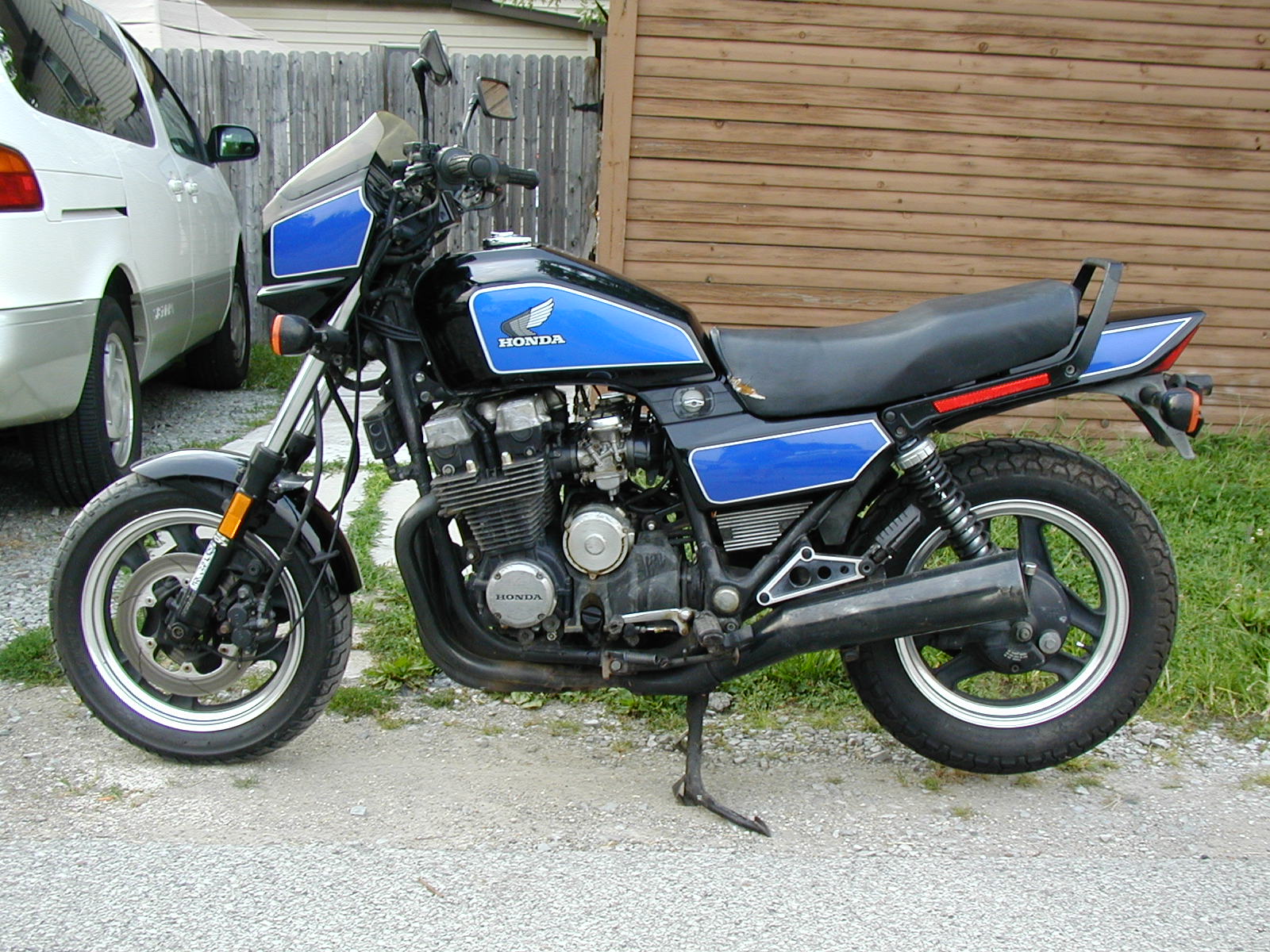

That 750 was found by my wife. She only had an inkling of what style bike I was looking for. She nailed it! I love the classic, APJB design, the spoked wheels, and the Windjammer/Vindicator fairing. That bike was exactly what I was hoping to find, at that time.
I've read a lot of pooh-pooh comments on the Windjammer fairings: "ugly as sin," "big, clumsy, and ugly," etc. If you have ever ridden in a headwind/crosswind, with a fairing mounted to your handlebars, and later rode behind a frame-mounted fairing, all of that so-called "ugly"-ness falls away. A handlebar-mounted fairing is a wind sail, attached to your handlebars, pulling hard against your arms, attempting to steer your bike for you! Personally, I love the Windjammers, especially with the Lowers attached: a genuine pleasure to ride in the rain, as they kept your legs mostly dry, and mostly out of the wind.
Once I dialed in that 750, I was set! I had my dream bike, or so I thought. Then we began long distance touring, and the 750's shortcomings, became very apparent. We rode her, two up, circling Lake Superior: mid-50's, and rain, every day in Canada... It was miserably cold, and wet. Our gear was low quality, the conditions were terrible, but that then-30-years-old bike rode, and ran, flawlessly. It was our most memorable tour, to date. I want to repeat it on the Voyager, but the wife wants to see other sites. I get her point, but I'd love to re-create that experience again -- hopefully without the cold rains!

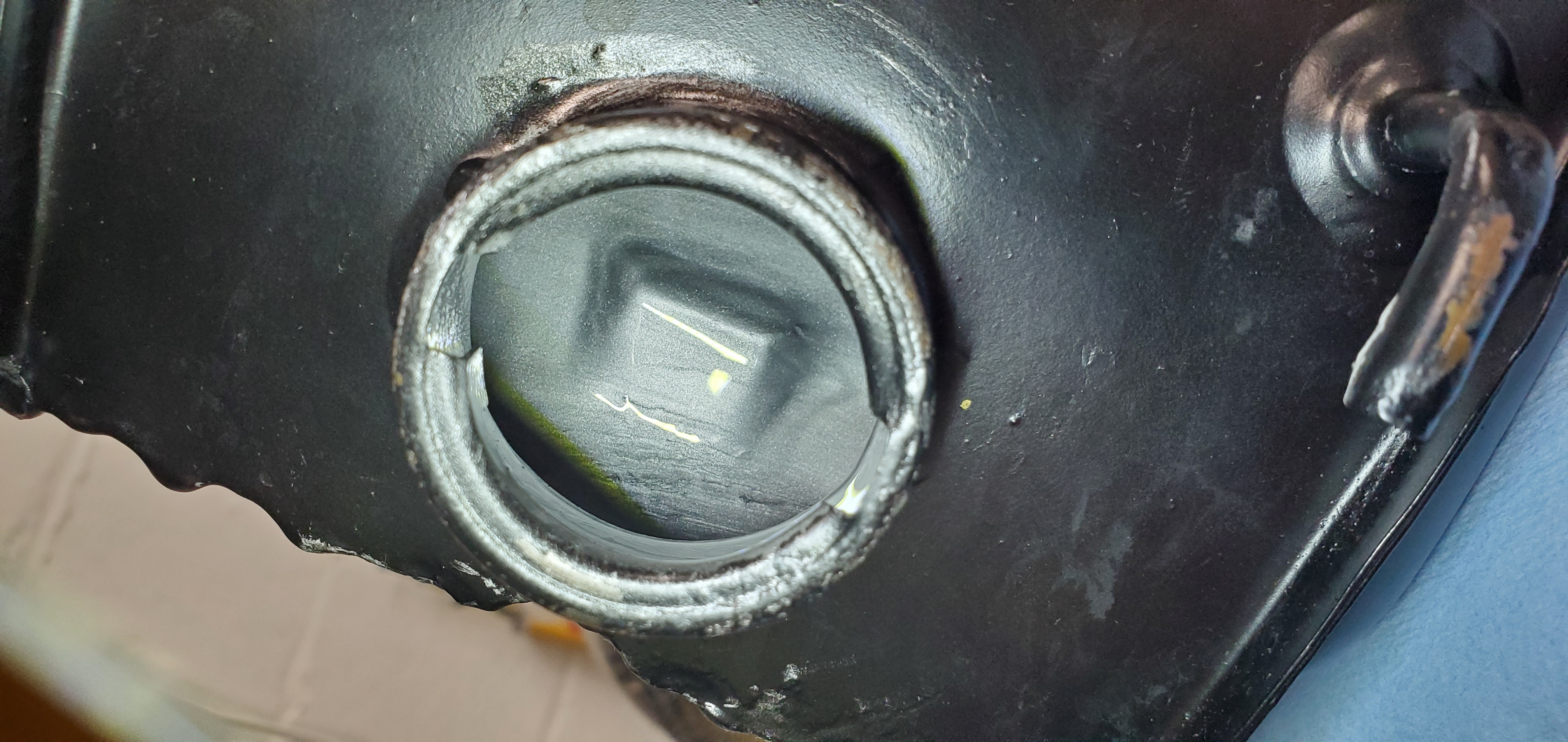

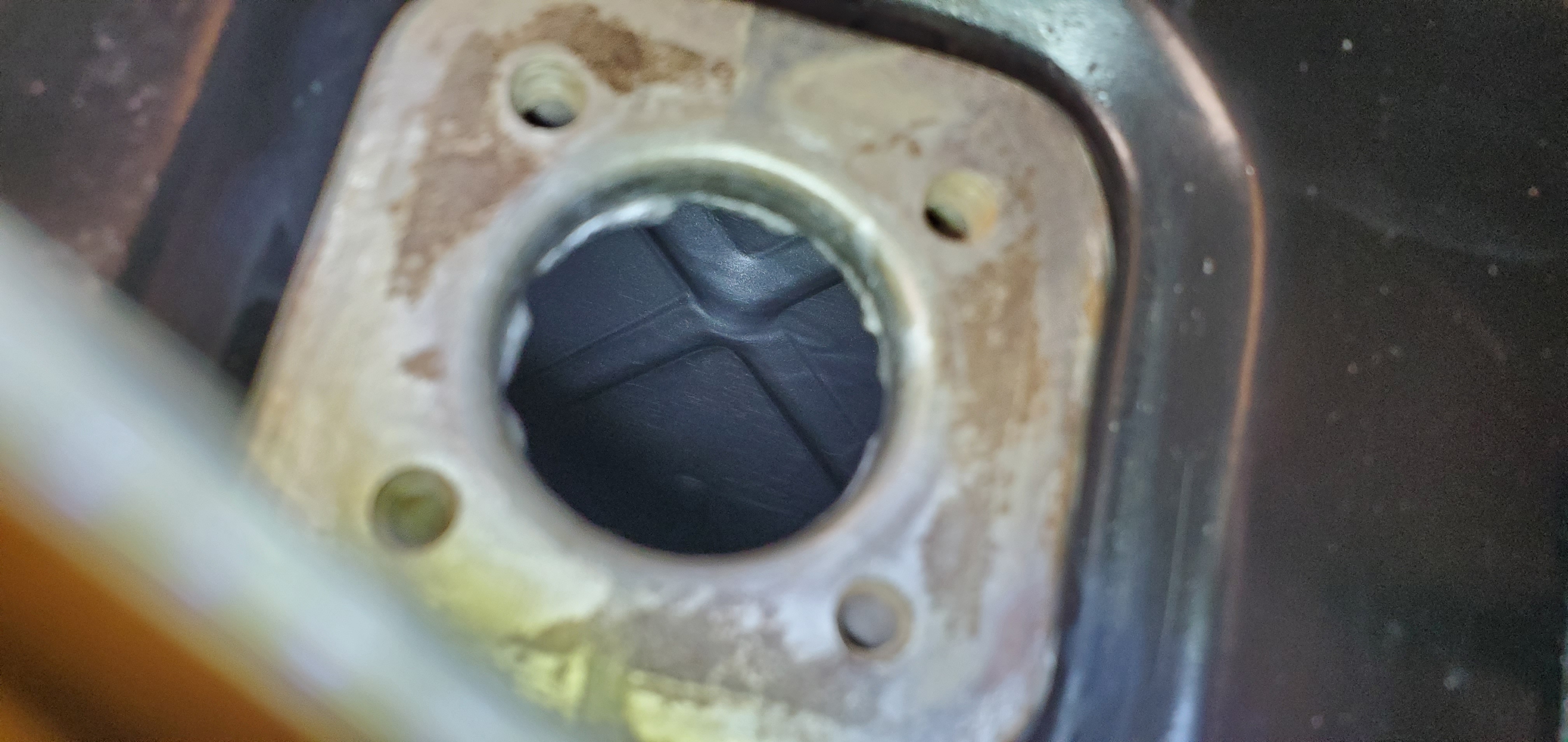

Got the tank lining done today. Excited to get it back together.

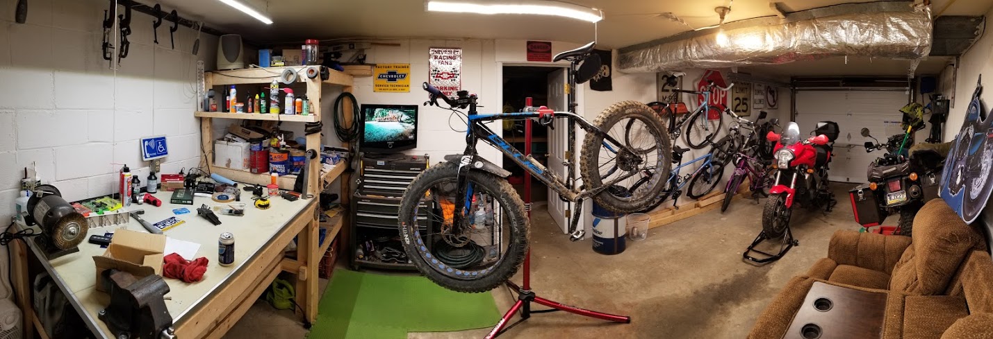

I only have an outdoor workspace, but I hope to have a shop soon. I'd been working on it as hard as I can, right up until I broke one wrist and dislocated the other shoulder falling off a ladder. (Only fell 4' -- getting old sucks!)
But I'm optimistic I'll soon be able to advance two bike projects: the aforementioned Sushiguzzi and a KLR 250. The new shop will include a lift table embedded in the floor.
I also have an old dog, which is my excuse for not riding a splendid old Rockhopper. (I used to ride a ton.) Patches doesn't like being left behind, so I mostly hike a short trail on the mesa that literally starts in my backyard. And I live just a nine-iron from a preeminent facility, https://www.mtbproject.com/directory/8017420/glorieta. It's a New-Year-resolution scale issue.
But one thing's fersure-- my wrist isn't nearly ready for handlebars of any kind.

Well, i reinstalled the fuel level sending unit. I'm still waiting for the tank lining to dry, but i can keep working. I finally put actual antifreeze in the cooling system. I've had just water in it. I changed the oil filter yesterday. With the new oil filter i also put seafoam in the crankcase. How long do you guys keep the seafoam in the crankcase? The bottle says 100-300 miles in a car. I was thinking as I'm working and maybe for the first ride just keep it in there. While I had the rear wheel off, i did notice that my bike doesn't have the vent hole on the final drive. Would you guys recommend me taking the wheel back off before i put the back of the bike together and drilling the vent hole ? It would be quick/easy to do now. Once the subframe is back on with the body it will be a bit more work. While the tank is drying, i can start the process of reinstalling it. It's getting close to being in one piece again. Oh yea, literally everything i look at has been wrong. The marker lights all had the wrong bulbs in them. Luckily the wiring schematic shows the correct bulbs.
