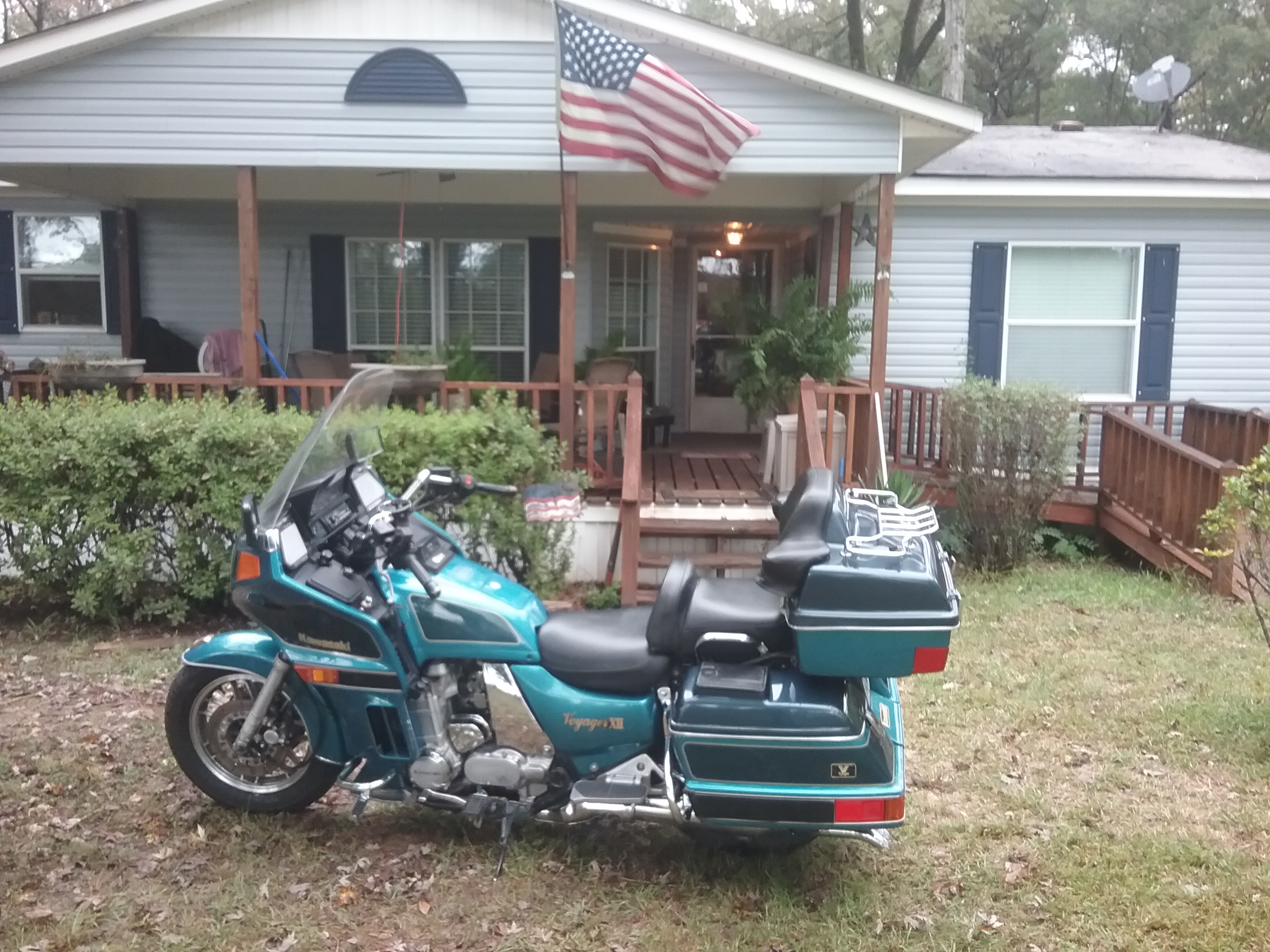

1994 XII new owner here.
I have a small oil leak and it's right at the 8mm bolt that has an exhaust pipe in the way.
My question is does the whole pan come off with no problems if I want to reseal it?
I just have nightmares of some springs popping out or some other problem that may require pulling the engine.
I only paid $1,500 for it (just turned over 60,000 miles) and don't want to get upside down on it.

I'll take another look but I'm almost positive of where it's leaking. It drops a couple of drops on the header pipes and smokes up. It seems like it doesn't do it after that. It may be build up from sitting overnight.

Hey Doug, the leak is above the header pipe on the right side.
I've been to partsfish.com to see what I'm up against.
It looks like a fairly easy job if the headers come off easily. Just a pain in the butt and an afternoon gone!
Looks like a bad weather day job!
