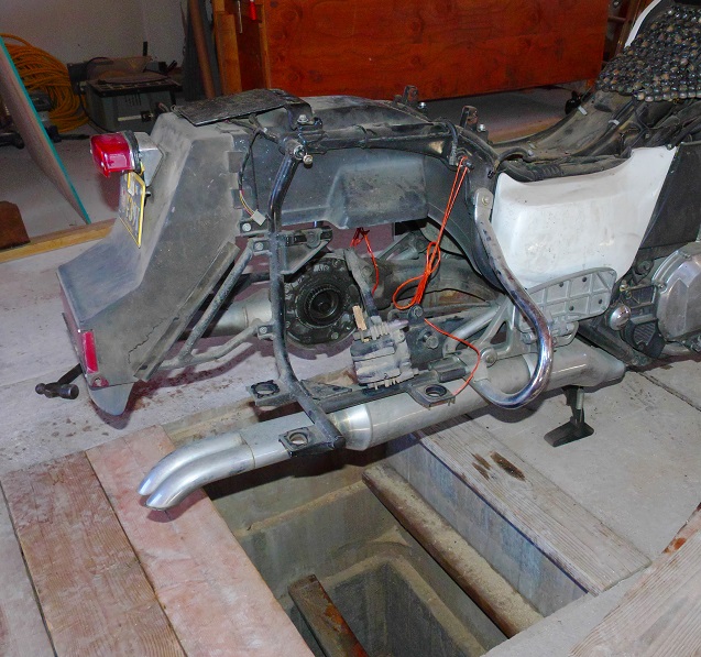

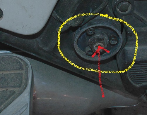

This is about deferred maintenance that I'm finally getting to, for the first time. I took some photos because the manual didn't really give me a very good idea of what I was doing.
I took my rear wheel in for a desperately-needed tire. And I desperately needed brake shoes. I left the saddlebag brackets &etc in place -- a good place to lay the brake. The shocks are off -- bailing twine holds up the swingarm.

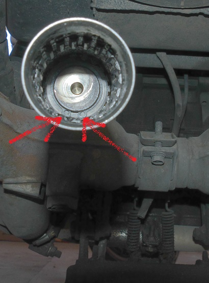

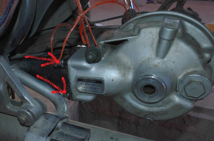

The final drive comes right off with four bolts (the visible two indicated). There's a spring in there that pushes the final drive case off the propeller shaft (see photo in next post), so don't let it fall! (That cover to add gear oil is 27mm.)

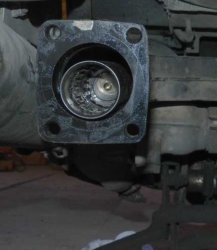

The propeller shaft turns inside the swingarm. Upon reassembly, I put high-temp grease on these splines.

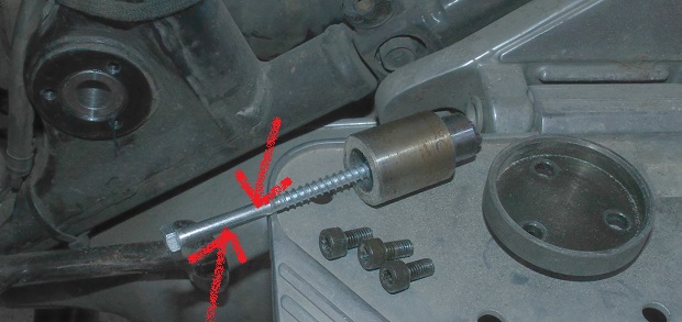

Detach the swing arm from the bike's frame. Here's the right end, showing the adjustment to get rid of any play. The manual calls for a special tool, but you can get by just fine with a 17mm box wrench and a 6mm Allen.
During reassembly, install the left side of the swingarm first, and grease everything so that you can adjust the play in the swingarm. The manual calls for setting that 6mm Allen (red arrow) at 95in-lbs, but that's what mine took just to turn the bolt. I had to over-torque it and then back off to the right torque, and it was a bit of a judgement call when it was right. I tightened mine very little from where it was before I took it apart. The swingarm moved just fine with no obvious play. Lock it down with that 17mm nut, holding the Allen of course.
Here are the parts that come off. The light blue arrow is a spacer that was in the yellow-arrow hole. The yellow arrow points to the swingarm shaft, still in place. These little bolts are 5mm Allen.
Here's the same story on the left side, with no spacer or adjustment stuff. The red arrow points to the "Suitable Bolt or Screw" I used to get the shaft out of the hole. (The left shaft is still in place. The shaft in the photo is for the right side.)
I took a photo of my swingarm, but can't find it now. The manual calls for popping out the bearings to repack with fresh grease. I didn't do that because I don't have the dust covers on hand. That's something else to order before next time. My old grease seemed just fine for now.

This shows the shaft removed. I cleaned the shafts and this bracket (in the frame) with fine steel wool, then greased them to slide the shafts back in during reassembly.

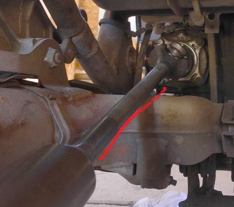

Pull the swingarm off the propeller shaft. In this photo, the boot at the front of the propeller shaft is removed. That boot slips over the propeller shaft, mounts on a flange on the transmission, and simply rests against the front of the swingarm (a hole where the propeller shaft goes through).

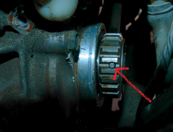

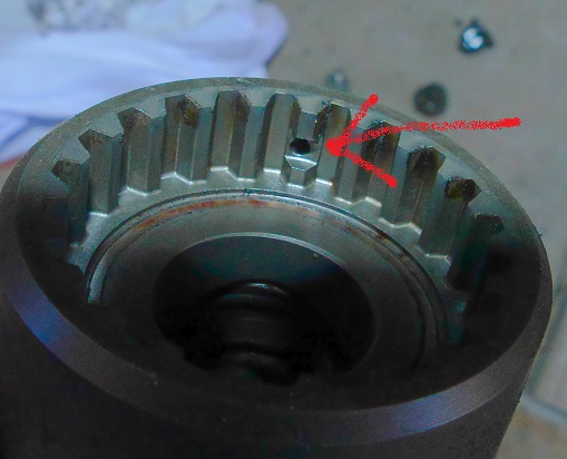

Here's the front slip joint, between the propeller shaft and the transmission. The u-joint is right behind (to the right) of the slip joint -- my u-joint seemed happy. The red arrow points to the hole where you poke something in to depress the pin.

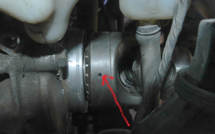

Here's what the pin looks like and how it engages the slip joint. Several posts mention this pin popping out and flying across the shop, but mine stayed put. I placed a rag over it in case. You are warned.
When I reinstalled this, I added some moly grease -- even though the manual doesn't call for it.

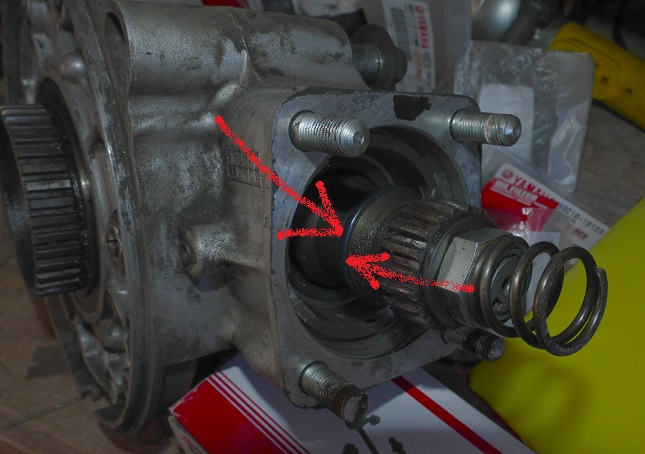

Here's one of the o-rings in the final drive. This also shows the spring I mentioned in the previous post. I did not replace this o-ring because it looked fine -- but I'll order it for next time. (Note that it's pretty easy to remove the final drive if I really need to.)

There's another o-ring that really should be replaced on the propeller shaft. It's between the the propeller shaft sliding joint and the propeller shaft. I didn't have this o-ring either, nor the long-nosed snap-ring pliers necessary to get it apart. (The previous post has a photo of the propeller shaft from the side to show how deep. I meant to measure this stuff but spaced it out during reassembly.)

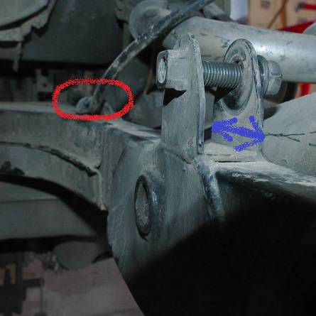

My rear brake line routes through the shock mount (blue arrow) and a tab (red) on the swing arm.
These photos actually are from reassembly, which is the reverse.

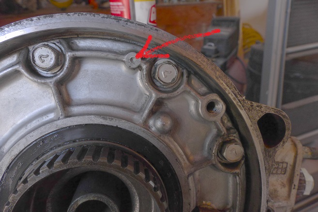

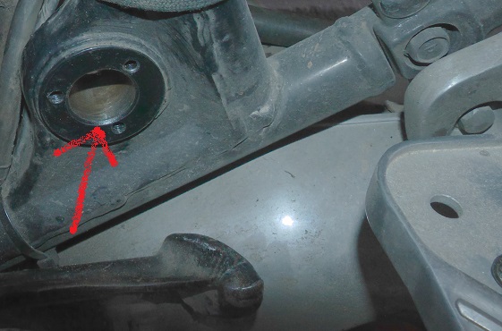

I skipped a photo. Here's where to drill the famous final drive vent. I used a 1/16" bit because that's the smallest I have on hand. It's twice as big as generally recommended here, but half as big as some posts mention.
I understand that early XII ('96 and before) had a vent hole in the indicated dimple. MaKa quit drilling this in later XII, reportedly because gear oil leaked out of it. But then the final drives leaked even more.
The final drive gets wicked hot -- why the splines (input shaft and wheel) call for high-temperature grease. The theory is that without a vent the final drive becomes a pressure cooker and the gear oil sputters out the seals.
That was my experience: most of my final drive oil blew out after several days riding in hellacious temps -- I mean 110-120F. The oil didn't appear to drip anywhere but instead seemed to come out like a vapor. My takehome is to check the final drive oil level a lot more often than I have been, especially after desert rides.
