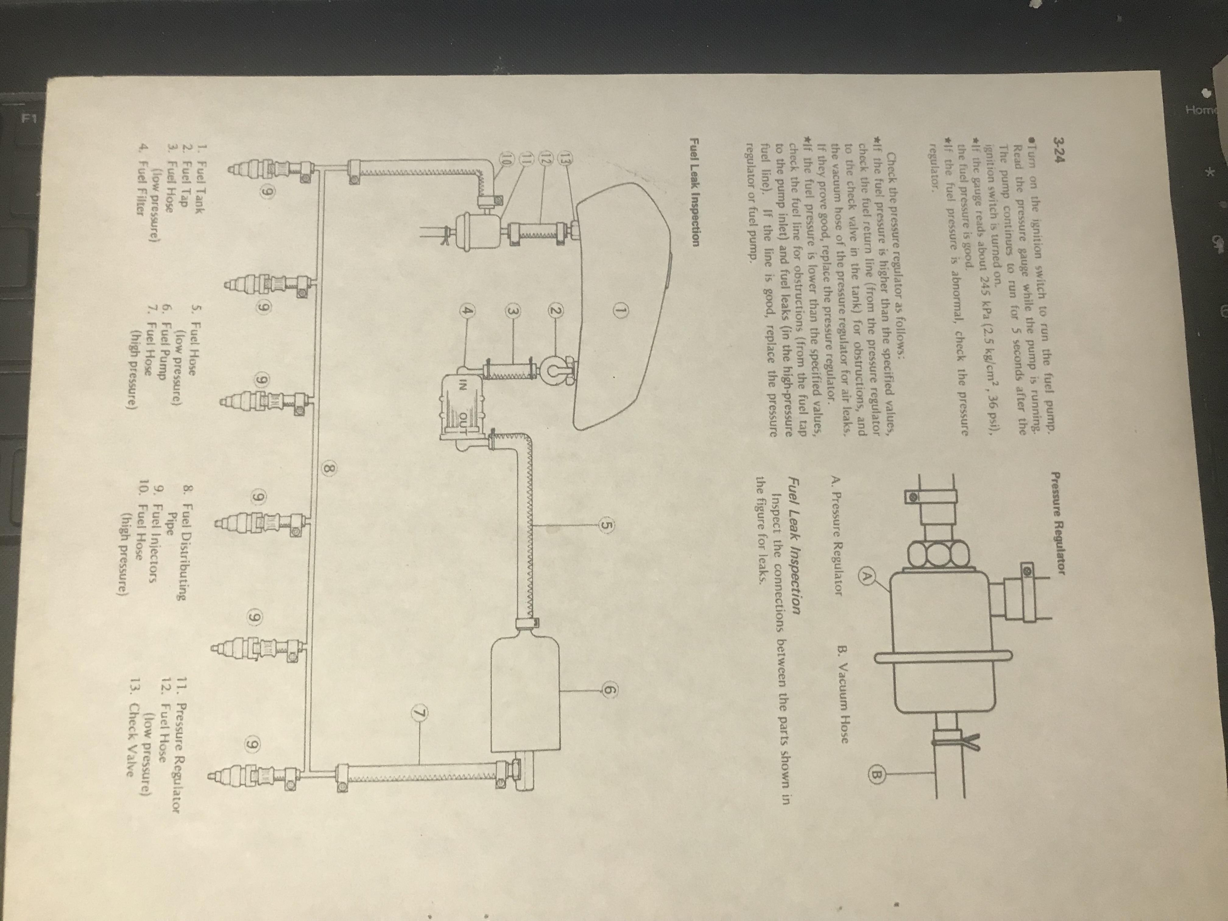

84 voyager. I removed the tank. Here is what i found.back left corner of rank a fuel line from somewhere about 5/16 fits over that.petcock has a couple of large diameter hoses clamped on.one disappears somewhere i guess hooked to a throttle body.so there are 3 throttle bodies and each one has a separate line from it to the tank? One large line,about 1/2 inch diameter goes from petcock T underand across frame toward right side of bike and it had a fuel filter hanging in the breeze.so goes to nowhere, from petcock to nowhere.seems like it should be to a throttle body somewher.last question when i turn throttle grip the cable goes to a place like a throttle body and i see the mechanism turning.so is that the only cable to throttle body connection? The rubber line to nowhere makes no sense

grumpy72 wrote: Wed Apr 27, 2022 9:37 am 84 voyager. I removed the tank. Here is what i found.back left corner of rank a fuel line from somewhere about 5/16 fits over that.petcock has a couple of large diameter hoses clamped on.one disappears somewhere i guess hooked to a throttle body.so there are 3 throttle bodies and each one has a separate line from it to the tank? One large line,about 1/2 inch diameter goes from petcock T underand across frame toward right side of bike and it had a fuel filter hanging in the breeze.so goes to nowhere, from petcock to nowhere.seems like it should be to a throttle body somewher.last question when i turn throttle grip the cable goes to a place like a throttle body and i see the mechanism turning.so is that the only cable to throttle body connection? The rubber line to nowhere makes no sense
Hope this is readable

I had removed the inline filter while investigating.on one end the word OUT is there. Does that end go to the line going to throttle bodies or does OUT GO on the top pointing upward to the fuel petcock.called fuel tap here by some people posting.

grumpy72 wrote: Tue May 03, 2022 3:36 pm I had removed the inline filter while investigating.on one end the word OUT is there. Does that end go to the line going to throttle bodies or does OUT GO on the top pointing upward to the fuel petcock.called fuel tap here by some people posting.
The line goes from the petcock (fuel tap) to the filter. From the filter to the pump (that line has different size inlet/outlet)/
From the pump to the injector pipe (distributing tube). From the tube too the pressure regulator, from the regulator to the check valve at the rear of the tank.
