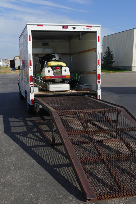

On Friday and Saturday I did a little more testing. The miss is much worse when I lug the motor; and it's best at 3500-4K RPM in 4th gear. That pretty much rules out starved for gas or a vacuum advance issue. I have nothing to rule out a bad secondary winding in a coil.
Going to the major PITA of pulling the coils (while on the road) just doesn't matter. If one really is shot, I can't hang out in a motel waiting for another to show up in General Delivery. Likewise, I can't futz around with a bunch of other fishing diagnostics.
Instead, I fixed the bike so it would make it home.
Trussed like a chicken.
