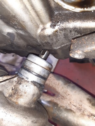

Andybarnes180
Posts: 13
Joined: Sun Feb 26, 2017 11:29 pm
Current bike(s): Zg1200
Re: Boiling expansion chamber tank- update pictures
Post by Andybarnes180 »
Some pics,
