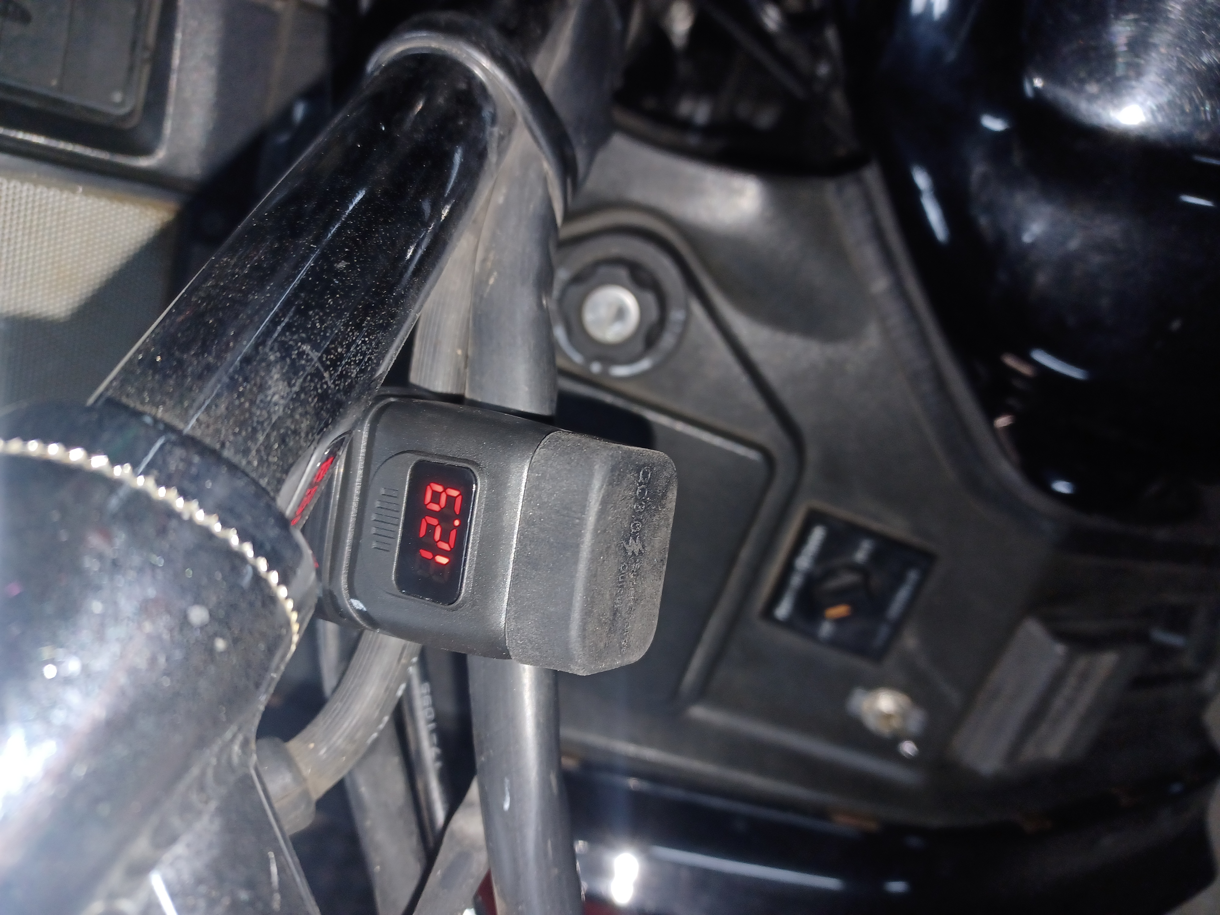

Plus i added one of these doodads so I'll have some warning next time
- Stew (Sun Apr 21, 2024 4:08 am) • Bonnie and Clyde (Sun Apr 21, 2024 3:30 pm)

A Voltmeter is a standard upgrade for me. Been left sitting before, due to a dead battery/charging system...
I replaced nearly all of my incandescent bulbs with equivalent LED's, several years ago. It freed up Amperes for charging my Battery. I highly recommend that to you. The OEM Alternator does not have a lot of spare Amperes for running accessories.
