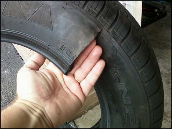

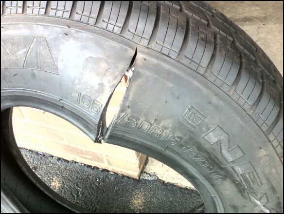

Re: dARKSIDE
Let me try to be as politically correct as possible:
Here is what happens when an "Intellectually Challenged Donkey" just keeps adding air in a "failed" attempt to seat the bead of a car tire on a bike wheel!
T'was a sad day, especially for the lad who's head was within feet when it blew!!!!
When mounting (going darkside) be patient and use caution! Oh and a little K-Y Jelly helps the bead seat I've been told!

Scott,that looks like it added some excitement to the day!
