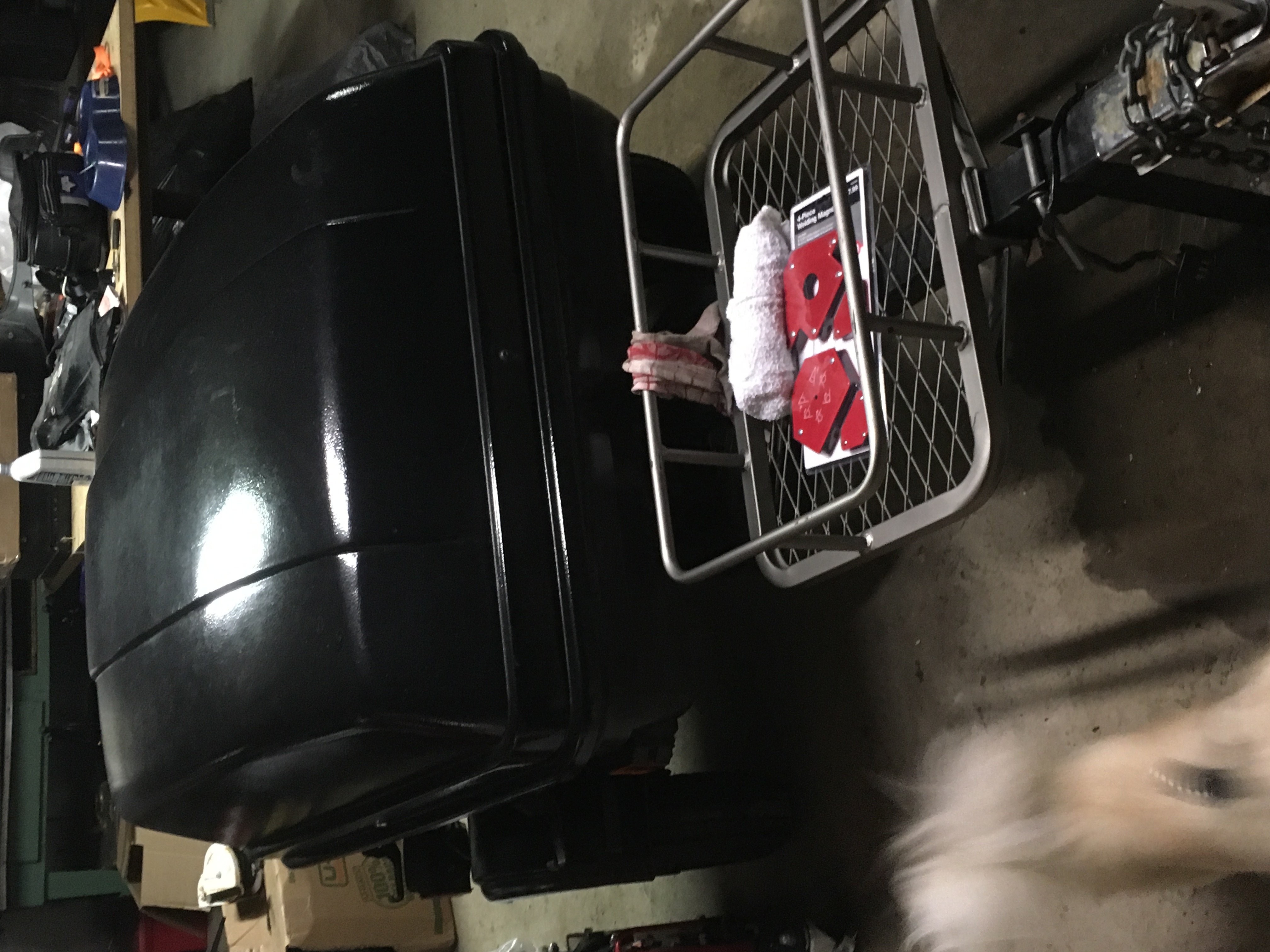

Got the trailer but will be a bit before I plan on anything.. also, may want to upgrade to torsion axle as it bounced a bit behind the car getting it home.. no milkshake puppies needed on a ride.

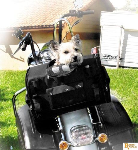

Before I stopped puppy #2 from going to the shelter I was going to get one if these:
but now with 2 it just is not going to work anymore.

That looks like the Saddlemen bag in the photo. Has anyone on here tried one? Curious if it would mount on the top box luggage rack or if it would be too high.

Not sure. I have seen them and it would sit a bit high but guess it would depend on the size of the dog as well. If they were not 200 a pop I would get, 1 for each dog, and remove the trunk and carry them both. Both my dogs together = 25 lbs. :thk: options ??

Exactly why I'm asking ;-) Too much $ to spend and find out it doesn't work.
