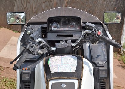

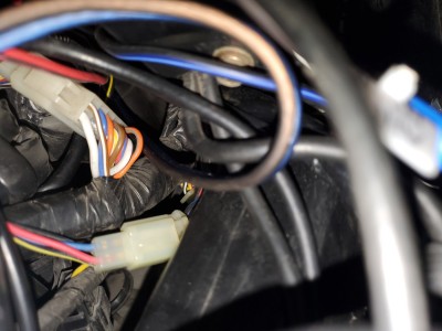

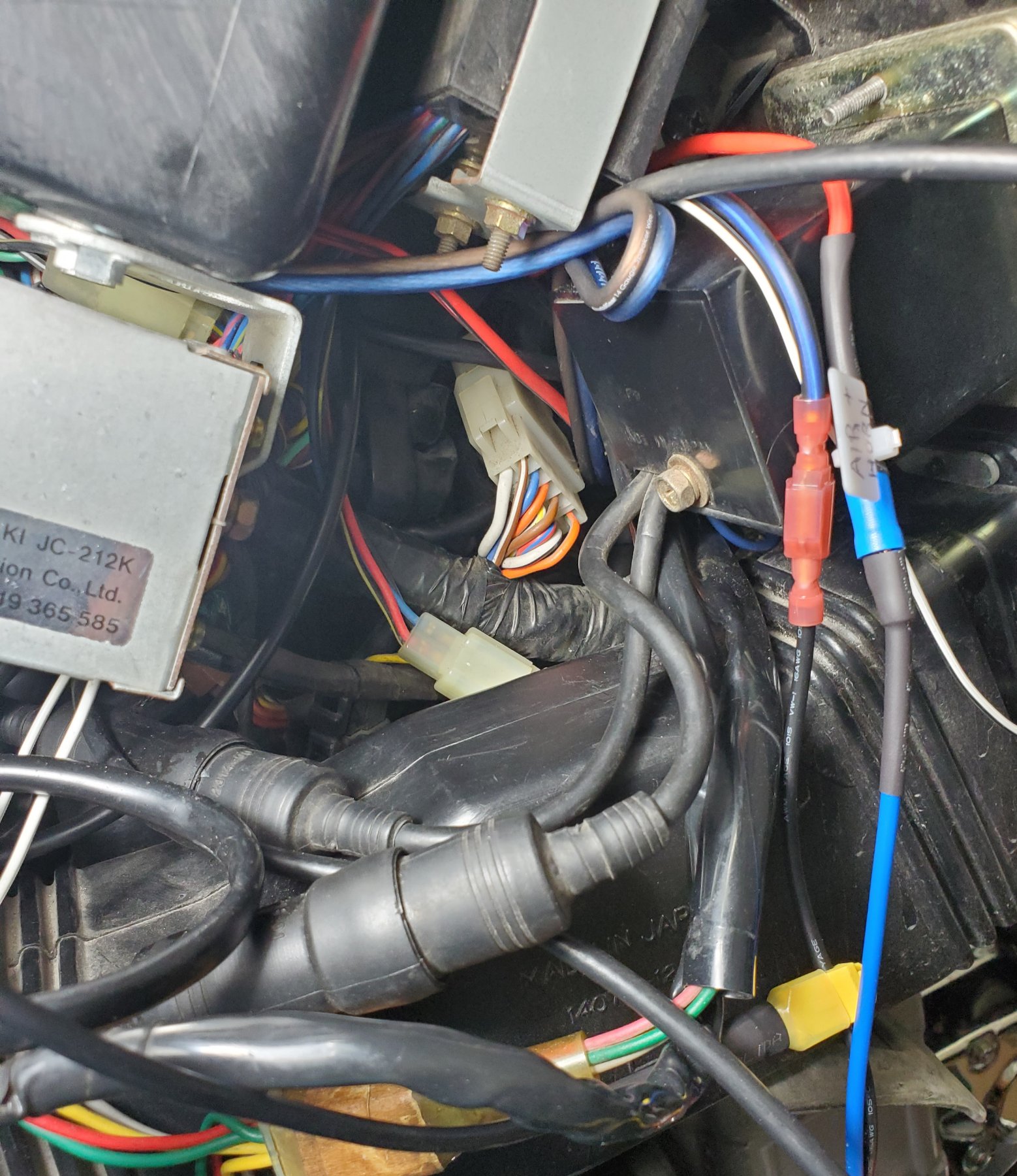

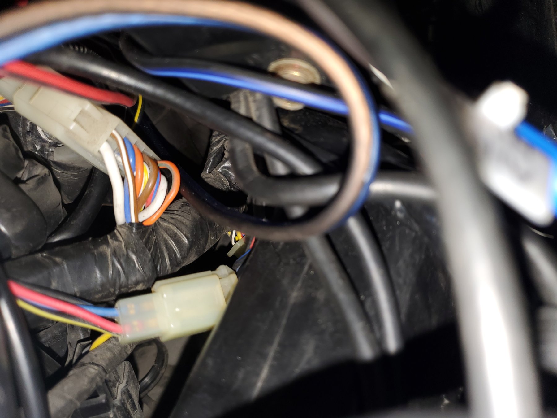

"Aha! " moment realizing is SO difficult to get at the Terrible Ten Pin because of the CB controller/dash display and related cables... that i just HAD to add onto my Voyager.
Easy to see [pic] but can't reach backside to release and uncouple.

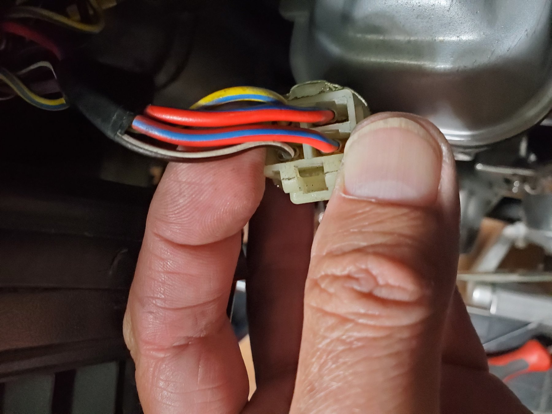

More info, (while I'm trying to get "Terrible Ten Pin" connector apart without breaking any plastic, tabs, etc.
Per the just posted picture, the lower side (sorry can't tell yet if it's upstream or downstream ... from... the fuse box)...Red/Bl has power with and without engine running, also Br/W, Bl and Wh/Bl.
On the Headlight Relay (new attachment) ONLY the Red/Bl by my thumb, lower left wire, has power with bike running. None powered otherwise, and none powered with bike not running.

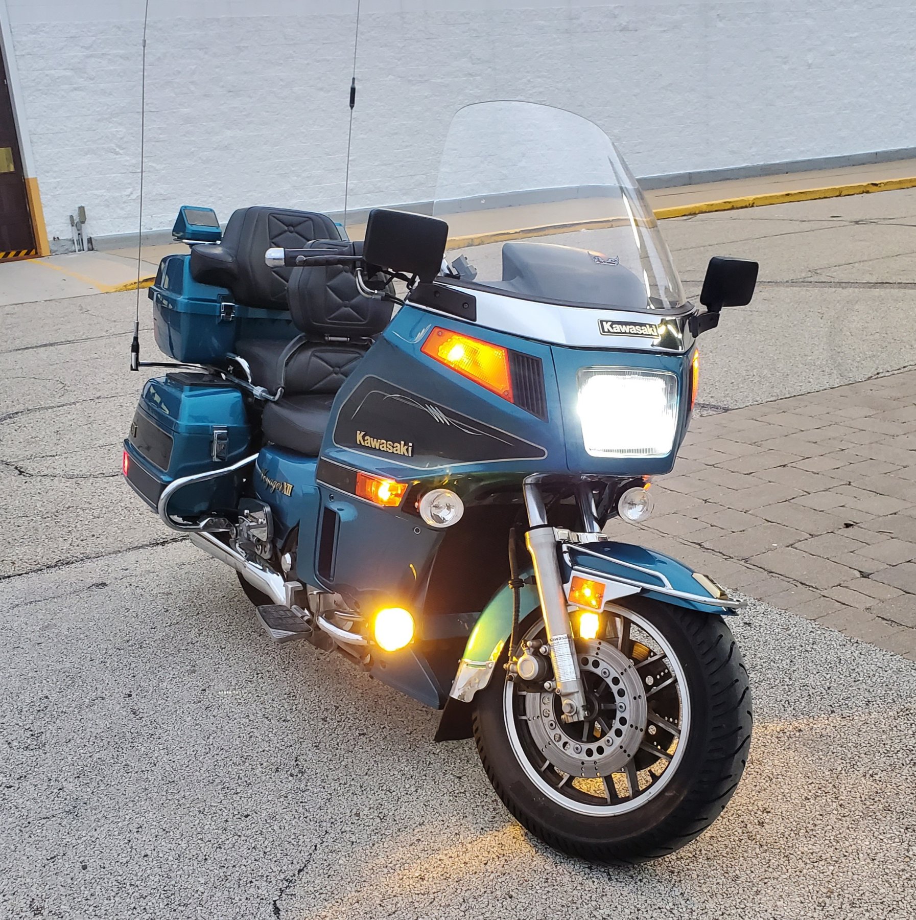

This is my bike altogether, running (2 weeks ago) still ignoring the lights on, then next start all lights off issue.
I grew tired of not being able to just start it up and drive, and be legal.

Bench test a relay you replaced and if it checks out as good, substitute it for the present installed headlight relay. If still no lights after starting the bike, shut off the bike and then verify the Yellow wire does in fact send momentary 12V to the diode when the starter button is operated for a restart. If you have a checked out relay and the Y wire is supplying momentary 12 V power to the diode assembly when the starter button is operated, and you still have no lights then I suspect one or two of the diodes has/have gone south.
Test for the diode: the Yellow/Blue wire at the headlight relay plug, which is the Yellow wire after the diode, should show 12 V while the starter button is operated and then 0 V when the button is not being operated. If Y/Bl wire test works as described then diode and the momentary 12 V Yellow wire connection from the starter cable to the diode assembly is good. If no power as described in test then there is a problem in the circuit which starts as the Y wire coming from the starter cable and ending as a Y/Bl wire at the relay. Verify both the Y and Y/Bl wires have uninterrupted continuity. If both wires check as good then that leaves 1of the diodes in the the diode assembly the only unknown provided the starter button operation is in fact supplying 12 V to the Y wire.
If the Y, Y/Bl wires and the diode of the momentary 12 V circuit test as good, then the loop R/Bl circuit to the diode and back to the relay through a connection to the Y/Bl wire would seem suspect to me. The diode assembly needs bench testing and the R/Bl wiring between the fuse block and the relay sounds as though you have verified it is in fact supplying 12 V to the relay so the other R/Bl needs to be switched by the relay in order to power the lights and self feed the coil circuit of the relay in order to maintain the closed switch circuit of the relay.
I can not stress the importance of bench testing components as if they check good, wiring and/or connectors are the only other item left. I hope this doesn't confuse all too much and I may be incorrect in some of my assertions but others may chime in and offer simpler solutions.

With respect to the terrible ten I prefer to rehabilitate any rotted male or female pins with new pins and reinsert them back into the connector. But that's only because I am a stickler for the way things are built. Sometimes though the plastic melts from arcing and is no longer usable or too much of the wire has been corroded away so in those circumstances I would probably hard wire and bypass the connector but only as a last resort. To each their own.

not sure if this would work but how about using a zip tie to hold the 2 sides that must be held in tight to the body. This should, if it works, free up a hand to do the pulling apart of the 2 halves. Just a thought.
Re: Starts Normally, May or May Not have Lights
It depends what condition it is in. Visually look at the condition, Most issues with connectors can be cured , simply by unplugging and plugging the connector several time to scrape away any mild corrosion that is causing the resistance issue. However there comes a point in time that the corrosion has become to the point of no return that it requires cutting it out for repair. The high resistance can cause HEAT , which will show up as burnt areas of the plastic, if you see that , well cut it out.DocSnowFox wrote: ↑Thu Jul 16, 2020 11:19 am triton28,
