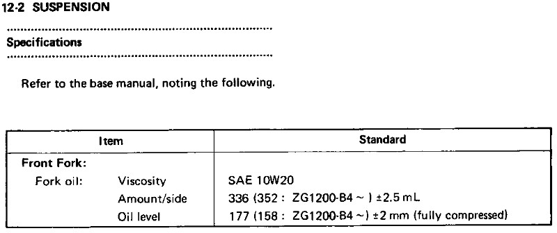

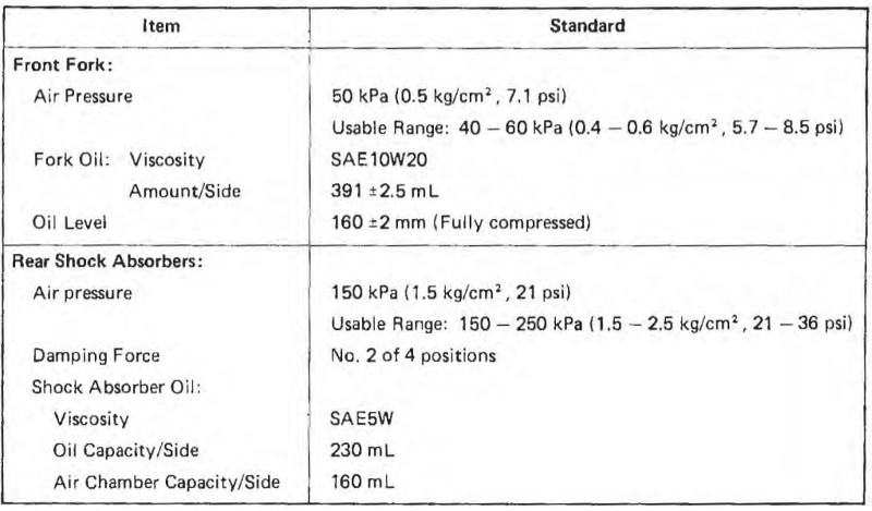

sgilbert14, below are the shock specs. Second photo is the revised spec for 1990 (B4) and later models, front fork oil level and quantity.
36 lbs. is the upper limit for the rear shock. You could decrease the air pressure. For stock shock seals, maximum front pressure recommended is 5.7 - 8.5 PSI. Rear is 21 - 36 PSI. You can bleed of the rear to see if there is any difference.
One thing I noticed prior to replacing my front fork springs with Progressives, is that I had a hard time putting my bike on the center stand. This is because the front springs were compressed more even at maximum recommended air pressure. Also, the front wheel didn't ride as smoothly as with the Progressives. I was getting a lot of diving on braking, and for example, road to Portales from Clovis prior to repaving was washboard like, front did not respond well. The Progressives smoothed out the ride considerably. I gather my 2001 front springs were already sagging from age.
Anyway, I hope this helps. You should find the 1986 base service manual in the manual downloads section. There is also the B1 - B17 (1990 - 2003) service supplement, which has the changes for the year models since the 1986 manual was produced. Not sure, but I think that supplement front fork oil also applies to 1987 - 1989, but I'd verify that first with the more knowledgeable here. I replaced my left front fork with one from a 1987, parts manual and looks were identical to my 2001, so I used the same oil level for both (revised spec). Someone previous to me buggered the Allen head bolt on the bottom of the shock so I couldn't disassemble it. (Head was thoroughly chewed up by using say, the wrong sized Allen wrench.)
Both would be a good start.
