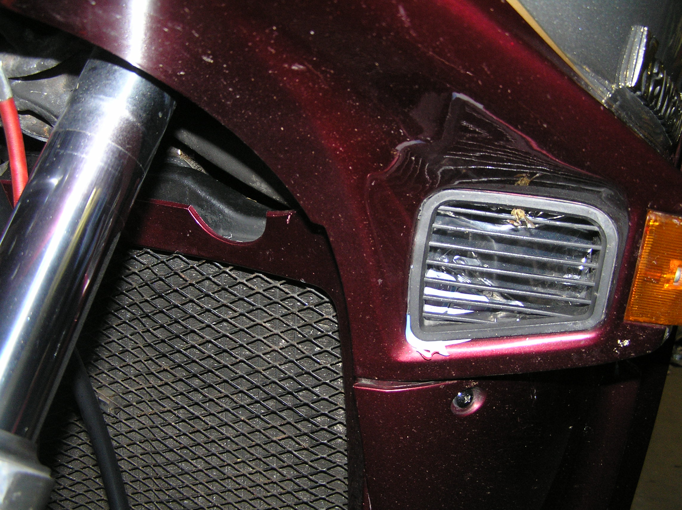

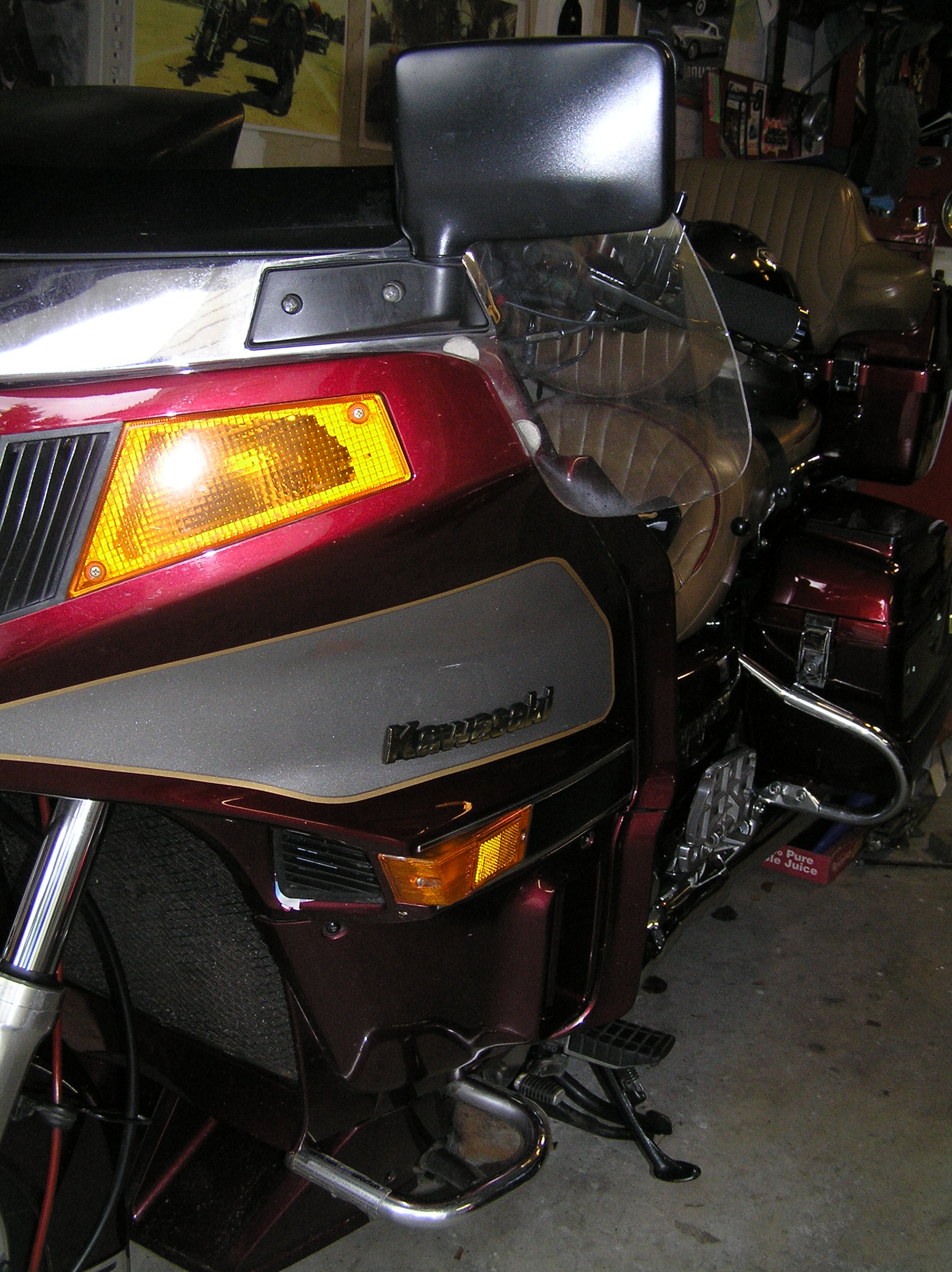

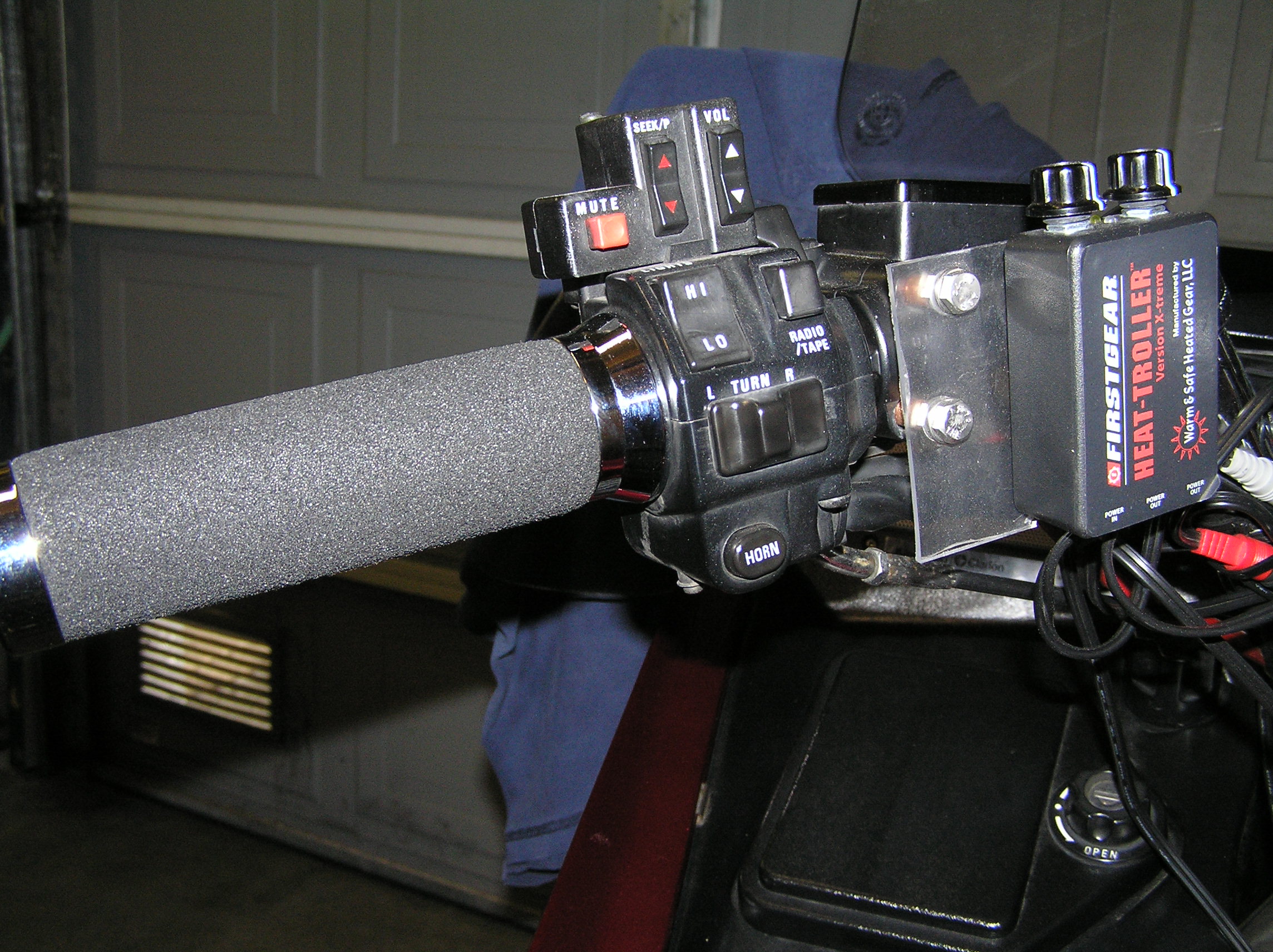

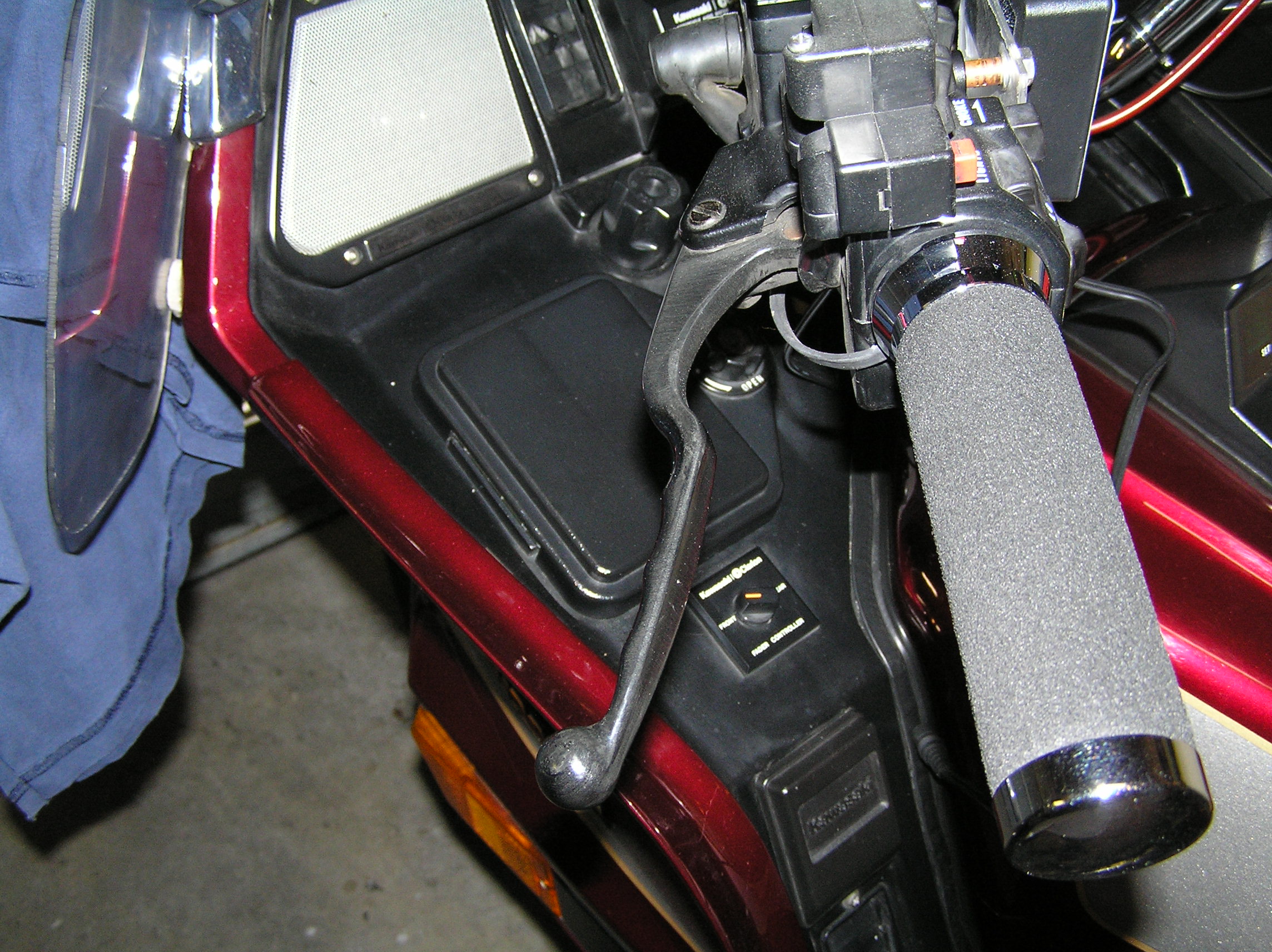

There are two ways to go 1 Electric grips 2 Grip heater kit. I've used both, I like the Grip heater kits because I like soft grips and the electric grips where too hard for me.
On my Voyager 1200 used some elcheapo brand and it's still on the bike, the grips were knock off Grab-On grips. The grips are open cell foam, making them very soft (they wear quick) making them warmer then the hard grips. I also wired a thermostat for electric gloves and long sleeve liner. Never had charging problems with everything drawing power. But best to check all of the grounds on the Voyager 1200 as there getting old. Remove the grounds and clean them (don't just check) I didn't have fog or driving lights on my Voyager 1200.
Now for some pictures of my Voyager 1200 ready for winter riding!

Thanks for sharing these ideas, especially the heat shields. (I can't make that photo out too well on my phone, and my PC died.)
I also like foam grips, but doesn't open-cell foam stay wet?

yes they do, but when wet I've got my rain gloves on. Plus when you have the grip heaters on they dry the grips fast.
I have the same grips on my Voyager 1700 and this summer I encountered that problem and the grips dried fast. But in the winter when I've ridden in the snow, my Electric glove are water resistant. The gloves are First Gear and they're the thinner winter gloves. But with the grip heaters and the Electric gloves my hands stay very warm.
