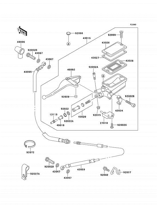

Nails the part number for that switch on bikebandit.com is 27010 and it is $25 and still available. You can find it on their blowout on OEM Clutch Master Cylinder. You are welcome.
