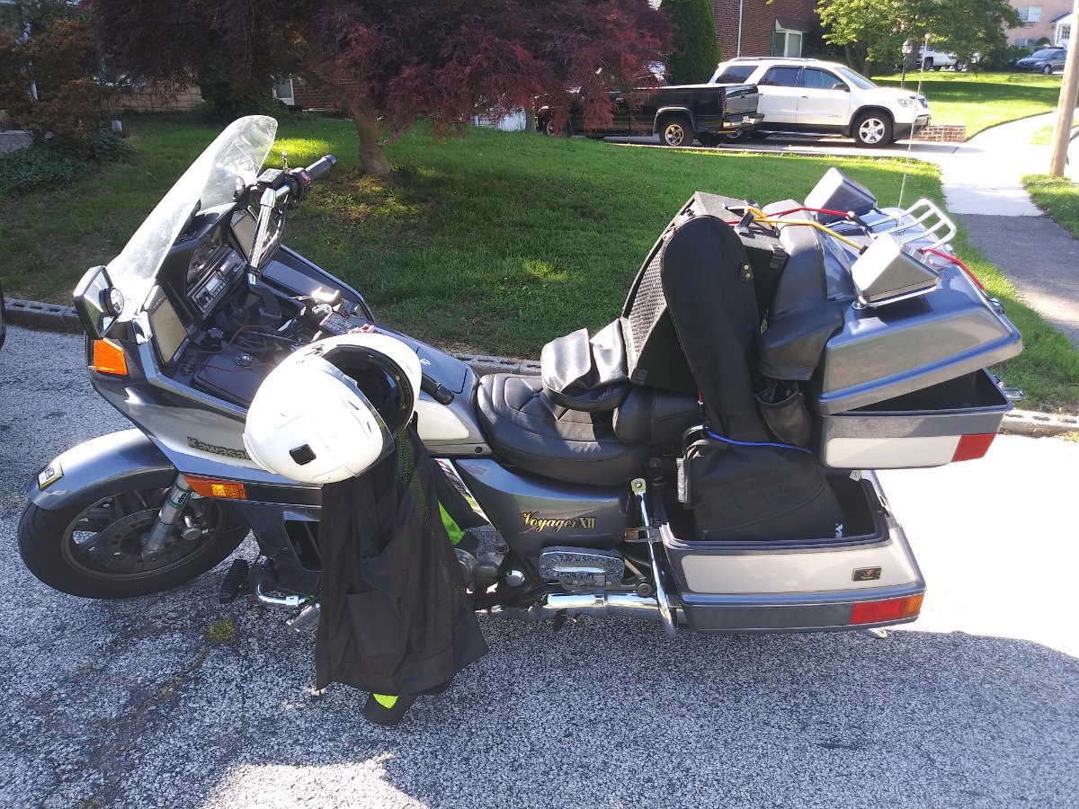

Went for a 150 mile ride to Delaware and back in a big loop yesterday, picking up a guitar, amps, and various accoutrements. Here's a pic of Gertrude loaded:
This is so annoying. Turned my $90 adventure into who knows how expensive, if I can find another lid. It took me four months to find the last one. Of course this had to happen two weeks before my Florida trip.
Isn't it cool how the electric guitar fit right into the saddlebag? Notice how the lid isn't in the way at all? Well... when I made my first stop, to pick up a guitar stand, as I walked back to the bike I noticed that the left saddlebag lid was missing. Again. I give up. This is the third one (including the one that was missing when I bought her). I don't know if it's an inherent problem with the latches; the lid was latched down tight and locked (part of my preride checks is to make sure all of the saddlebag latches are tight and locked). The tethers failed :(This is so annoying. Turned my $90 adventure into who knows how expensive, if I can find another lid. It took me four months to find the last one. Of course this had to happen two weeks before my Florida trip.
