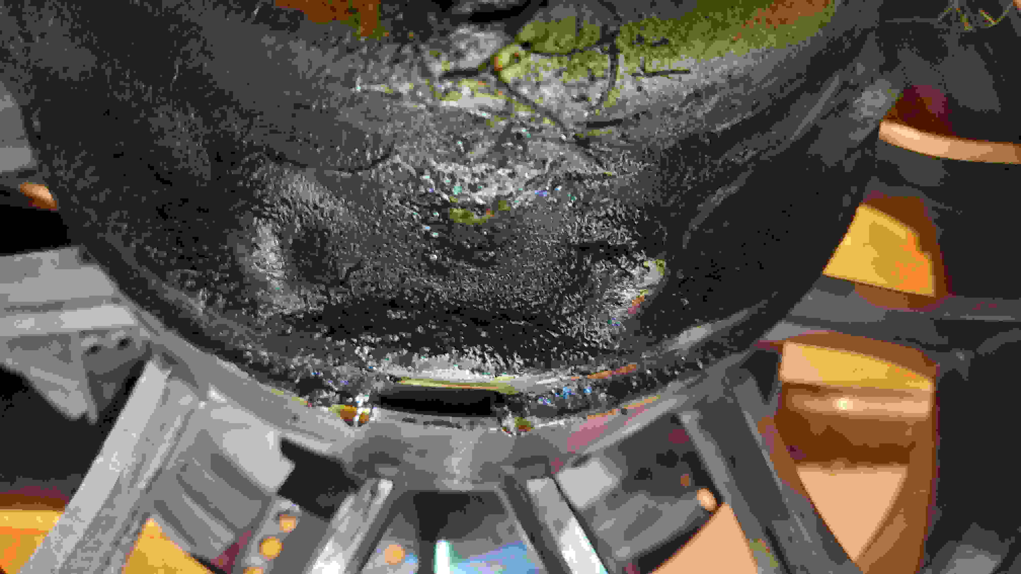

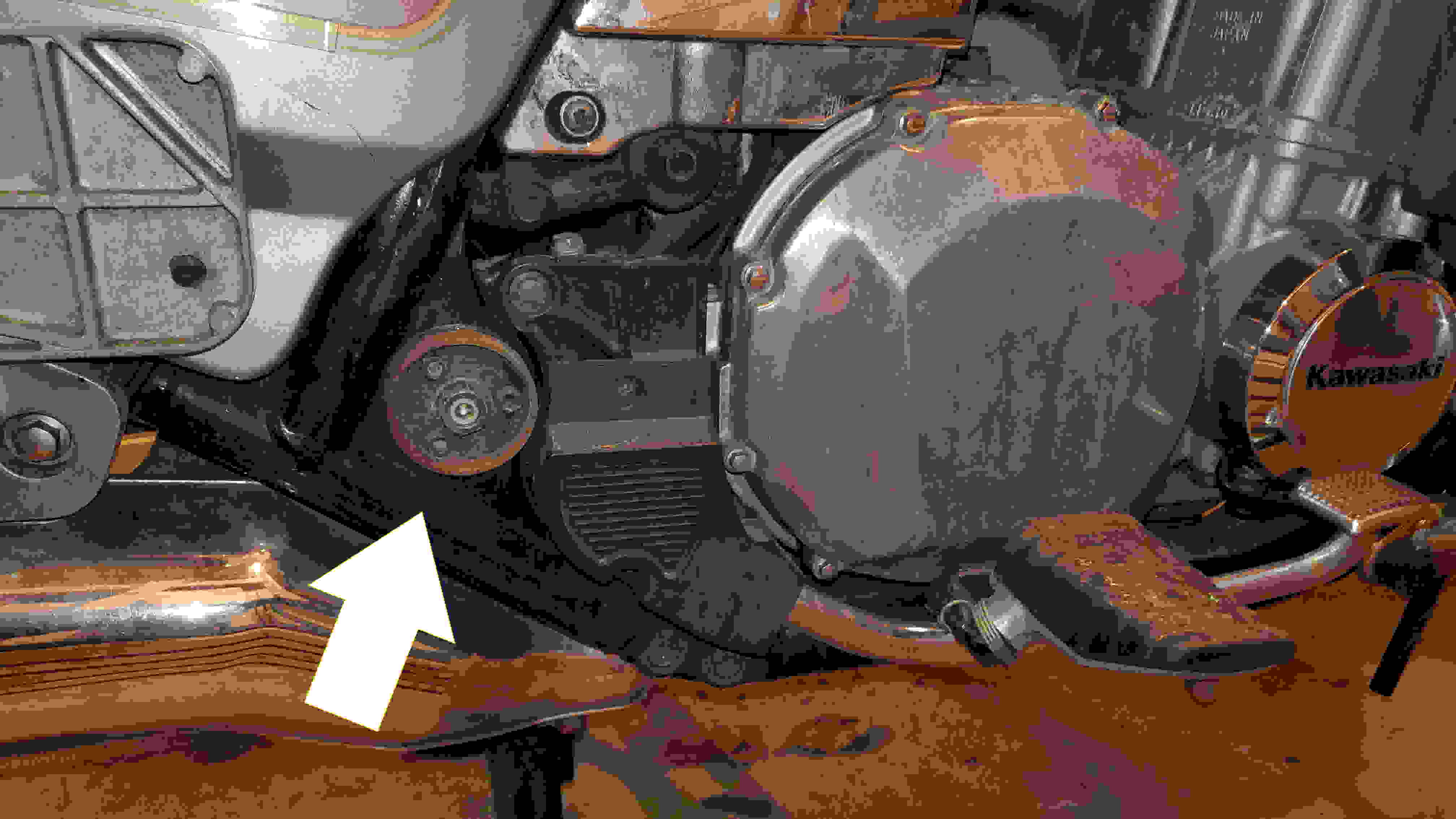

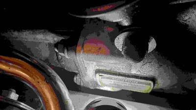

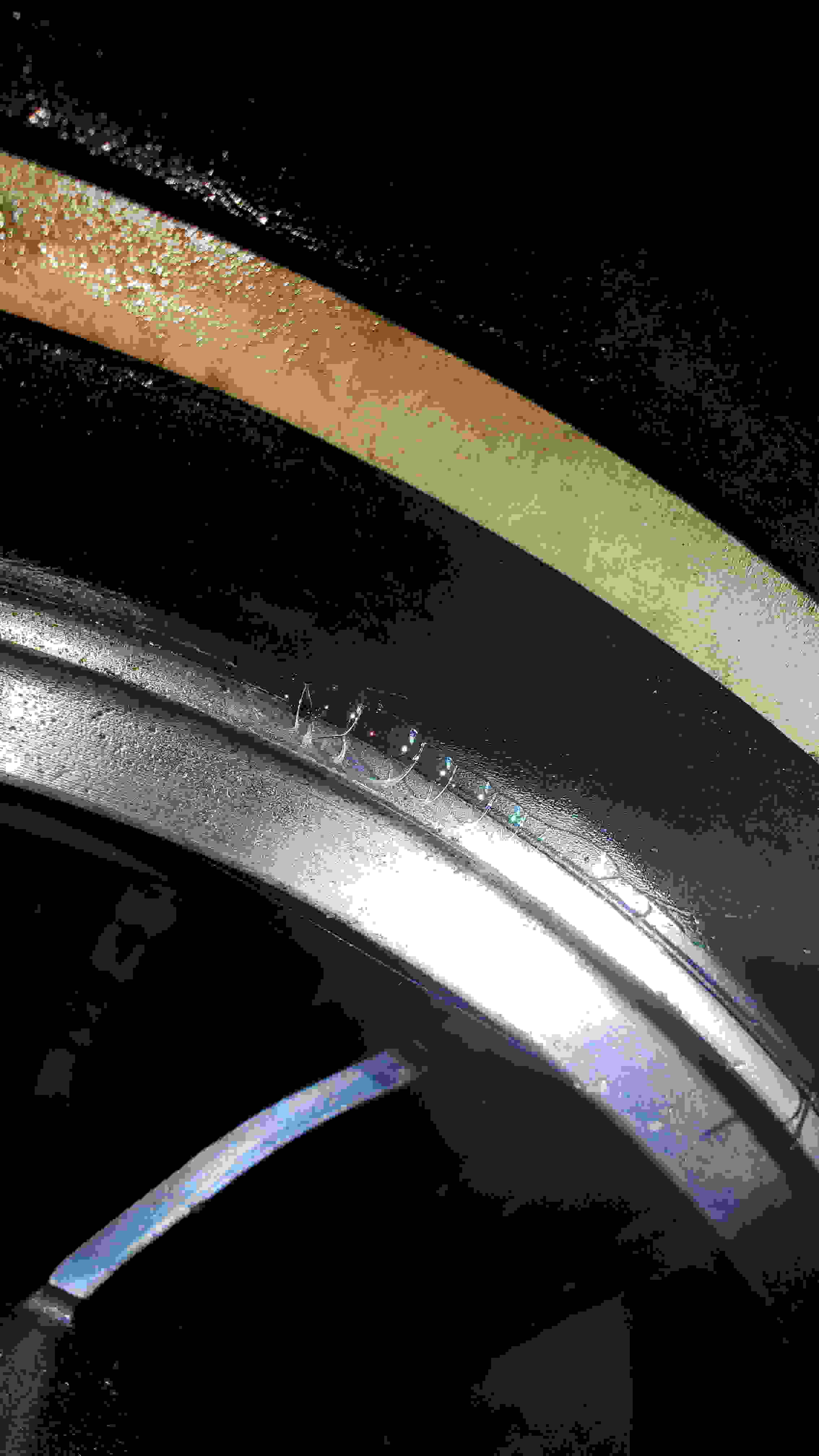

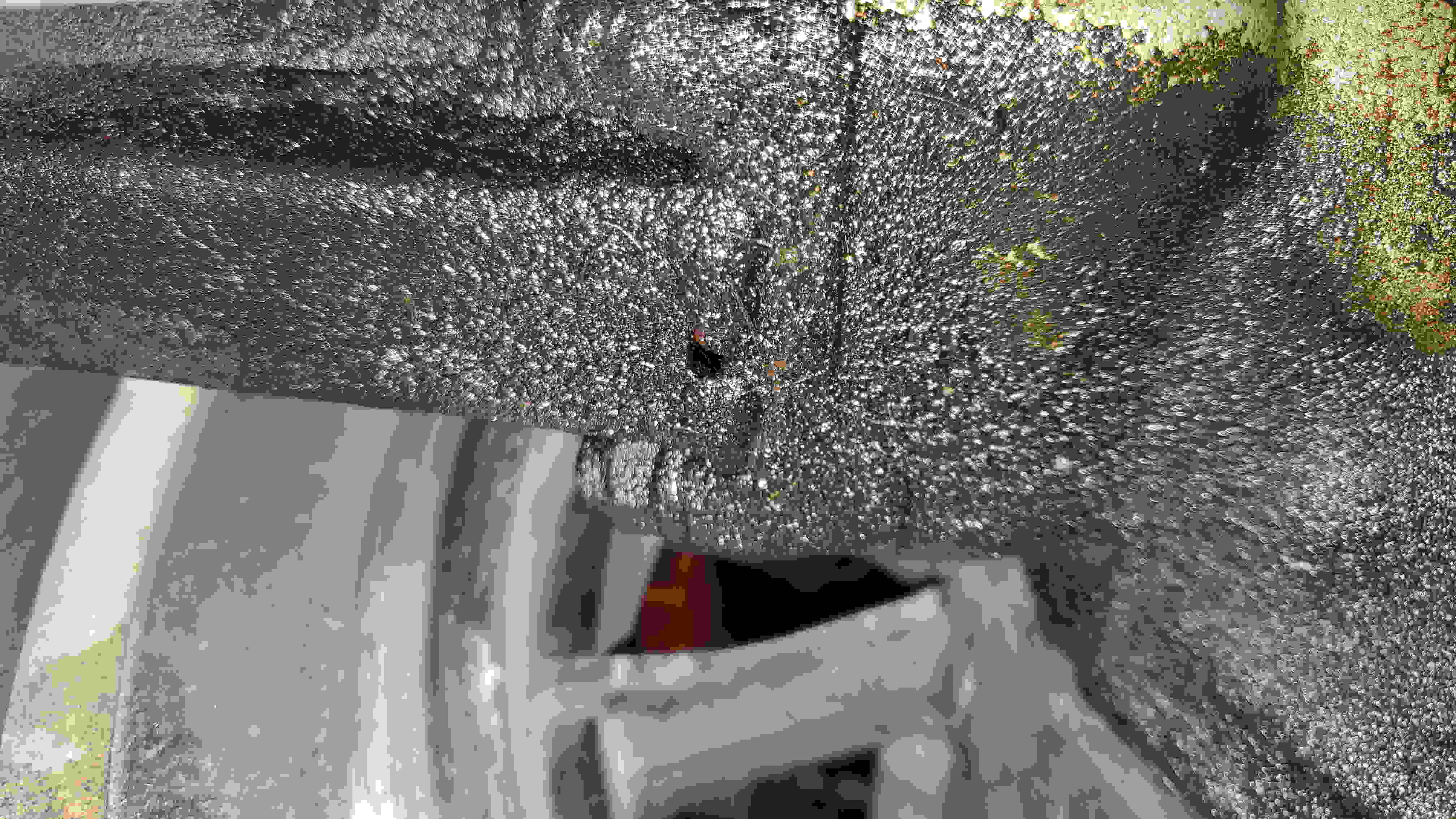

Ok, just bought a '91 XII Voyager with 47K miles. Impulse buy, no buyers remorse but noticed a bunch of stuff after getting it home. I'll try to post some pic of the issues because I'm know they will help but I'll start with the descriptions.
1. Rear Tire has at least 8 leaks at the bead/rim interface. The tires look to be in really good shape, no cracks or checking but again numerous leaks. Are the rims notorious for sealing/leaking issues or did I just get one where someone did poor precleaning or installation of the tire? 2. Missing part from right side. See px with white arrow. Can someone share a picture of what is missing and maybe a place to get a replacement? 3. Shaft Drive Leak? I am assuming there is a leak as the bottom of the center hub is dripping and there is a lot of wetness (see pxs). Is this a common problem? I would classify myself as above average when it comes to doing repairs myself. Is this a repair I would be able to take on myself? Is there a writeup or some guidance anywhere on this forum? I have a look of tools, are there any special ones I would need? Thanks and looking forward to riding this spring.

Welcome to the forum. There aren't any known issues with the rims on vxii's. Sounds like yours needs the tire removed to see if there's corrosion affecting the tire bead. The part you are missing looks the same as the one on the left side.. I vaguely remember people complaining about it being a discontinued item. Most of the rear end oil leaks are caused by running too much oil. The manual says fill it to the bottom of the fill plug. Most people run 1/4" below that. There's a couple of "O" rings on the driveshaft that have been know to cause leaks. If you become a member of the AVA, I believe you would then be able to search the forums to find more answers. There's lots of things to address when picking up a used bike. Start with changing all the fluids, and go from there. Note: there are 2 engine oil drain plugs. Have fun checking everything over.....

Check the date on the tires.
Yeah, you're missing that little round chrome cover.

Good morning and welcome! The little round cover you're missing is a swing arm cover. I have two of them; however they are still packed away - i just moved. On the bright note, the box full of motorcycle parts is one of the very few remaining boxes. I'm going riding today (31 degrees here in Philly) with the South Jersey Retreads.
