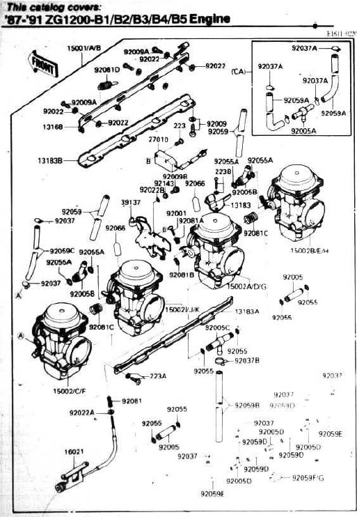

I found a carb assembly blow-up on a parts microfiche (ZG1200_B1-B5_VoyagerXII.pdf) I surely got off this AVA website somewhere. (I don't know how to search for "parts manual" without getting a dozen pages of everything that has "parts" and "manual".)
But I still can't identify that mysterious plastic tee I've been carrying on about. Much less what it actually does. Oh well. :Cball

The only "FITTING,T-Type" tees shown in this illustration, and used on the Voyager XII carburetors, are: 92005-1119 which is used on California only models to connect the tubing downstream of the float chamber vent tees to the evap system and shown as 92005A on the illustration; 92005-1125 which are used to vent the float chambers and are shown as 92005B; 92005-1148 which is the fuel rail inlet where the rubber hose from the pump connects onto and is shown as 92005C; and 92005-1151which are the tiny black plastic tees used on the drain lines and are shown as 92005D.
https://www.partzilla.com/catalog/kawas ... carburetor
Posts: 1831
Has liked: 241 times
Been liked: 624 times
Re: Fuel leaking from carb overflows
Yeah, I saw that CA insert. Maybe I have a mostly-de-Californicated XII. I don't see an evap canister -- that mysterious Tee drained in front of the rear wheel. I assumed it was the carb overflow drain. If I ever have the carbs off again (press wood) I'll try to figure it out.
