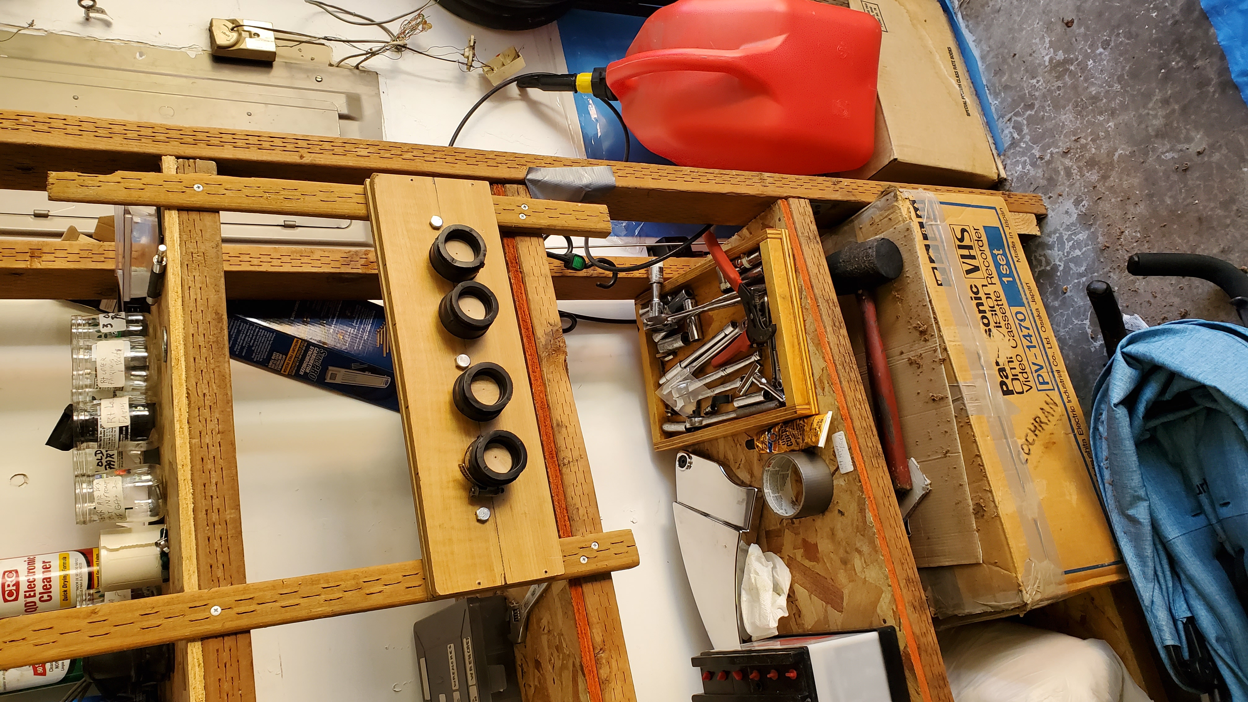

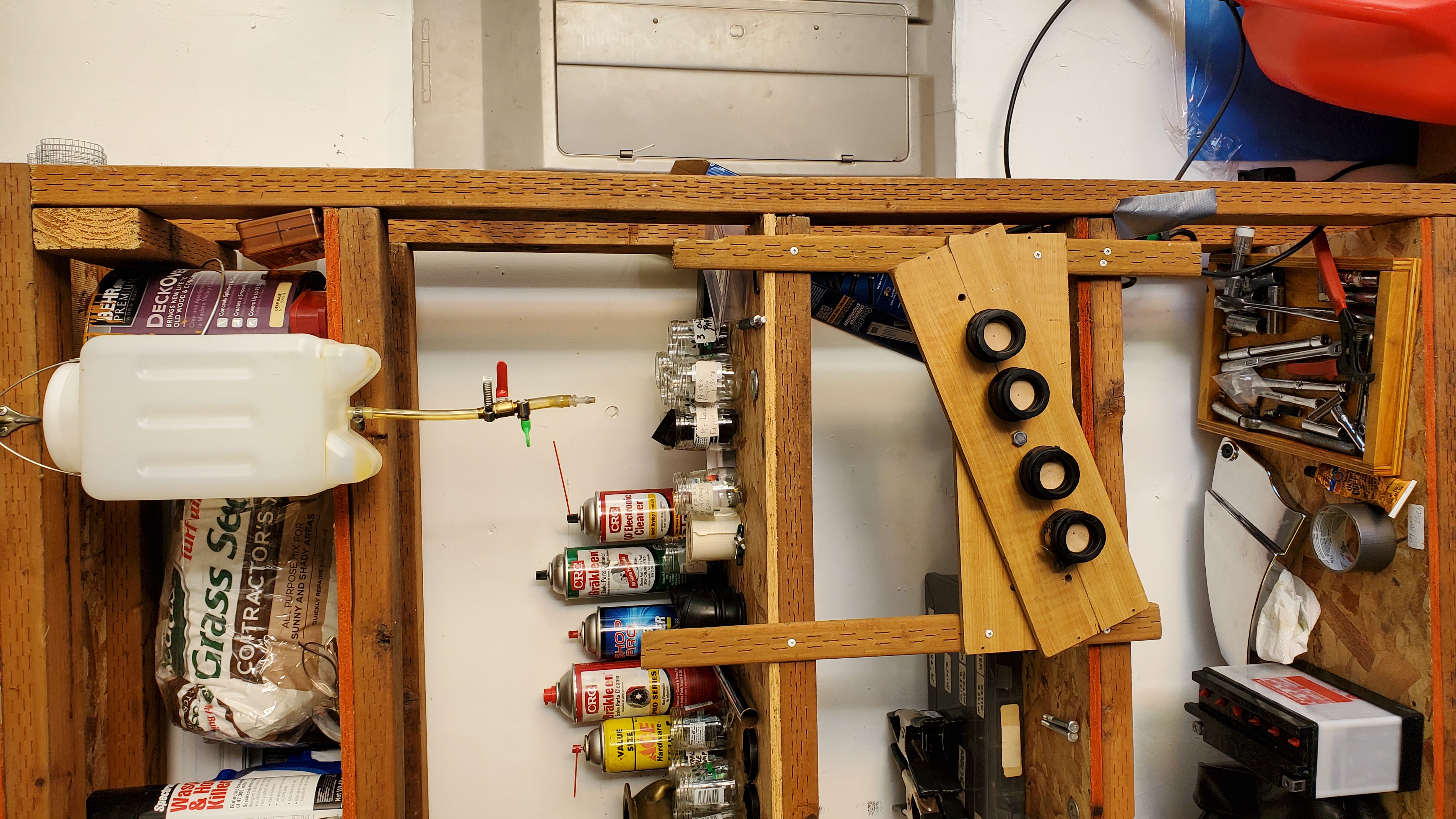

Shown are pics of my quick and easy carb work "stand". The wall shelf unit it is secured to is solidly attached to the wall. The thing has four forward rubber carb mounts attached to a section of wood that can rotate 360 degrees. Above it is a solid place for the fuel source to mount.
Just click on the pics to get them to orient correctly.
