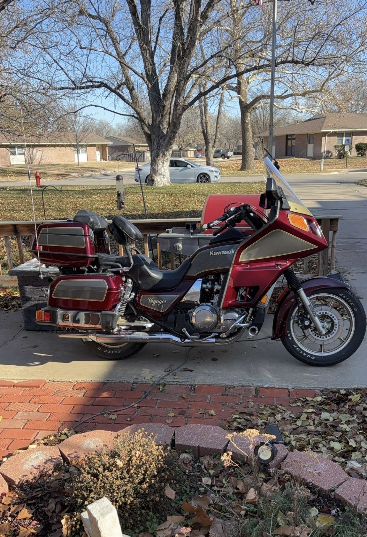

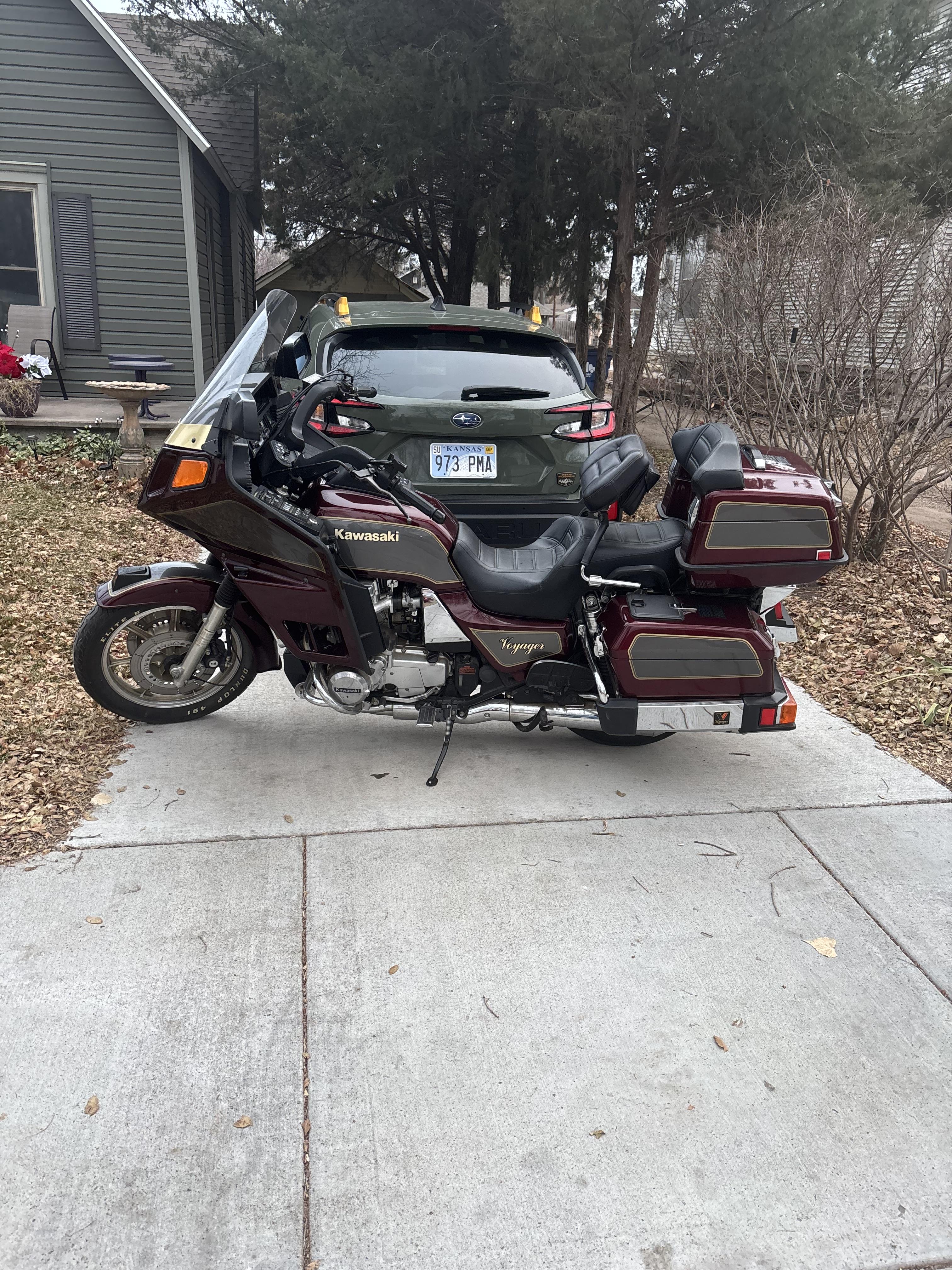

I’m happy to announce I’ve got my hands on a cherry 1986 Voyager that’s completely stock! It even has the owners manual and service manuals!
I was wondering if there are any quirks of this bike that I should be aware of or issues that it’s known for.
I need to get to the fluids and tires replaced, hopefully the engine is in good shape as well - I heard a noise that made me a little paranoid.

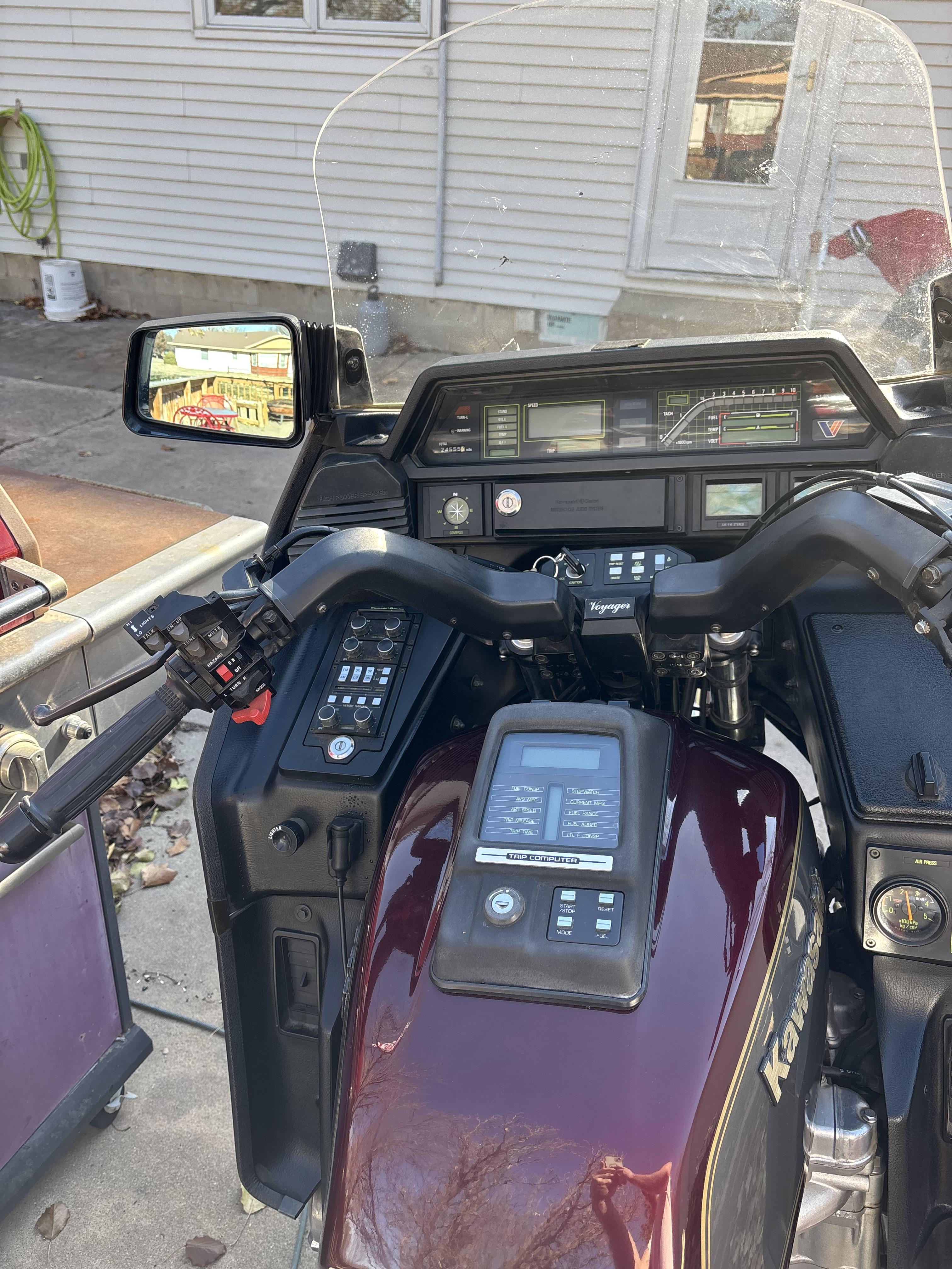

One Quirk (off the top of my head): there's a 'Cruise' button, but it's not for 'Cruise Control' - the button leans out the fuel mixture to improve MPG's. After riding the bike around a bit you'll be able to feel when it's in cruise mode (there is an indicator too) as it'll feel a bit more gutless than when it's not in cruise mode. I tend to leave mine in cruise mode all the time unless it's really hot out (cruise mode will, at least in theory, make the motor run hotter).
