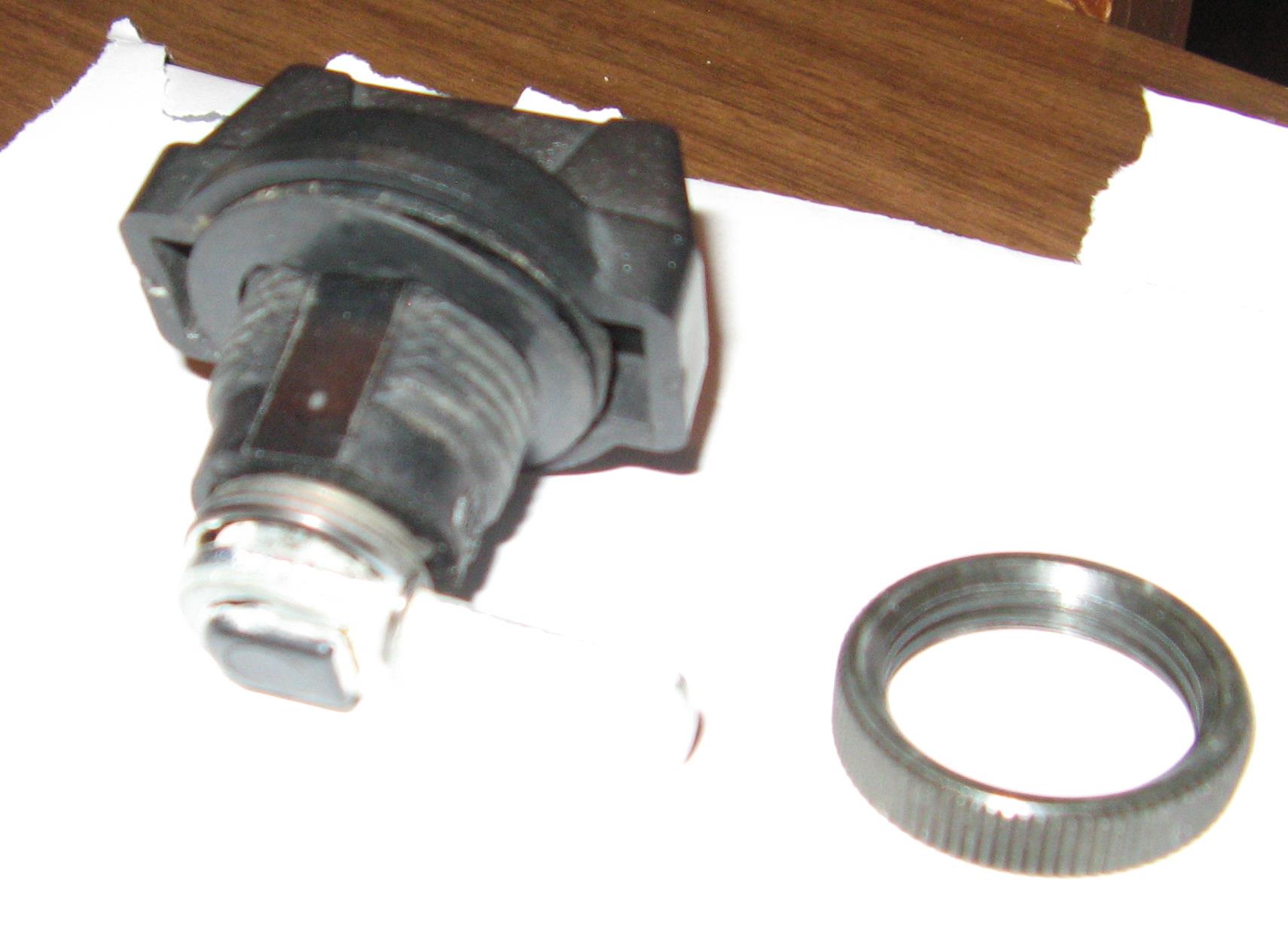

I have lost one of the flat round knurled nuts that holds the latch on one of the small pockets in the saddlebag lid. I have tried looking in the parts catalog available on here, the closest seems to be on page 89/92, shows the entire assembly as 27012-1339 (HOOK SIDE BAG) or 27017-1126 (LOCK BAG). I just need the little flat round knurled nut, I guess mine worked loose and I can't locate it anywhere. Any ideas? Thanks in advance!

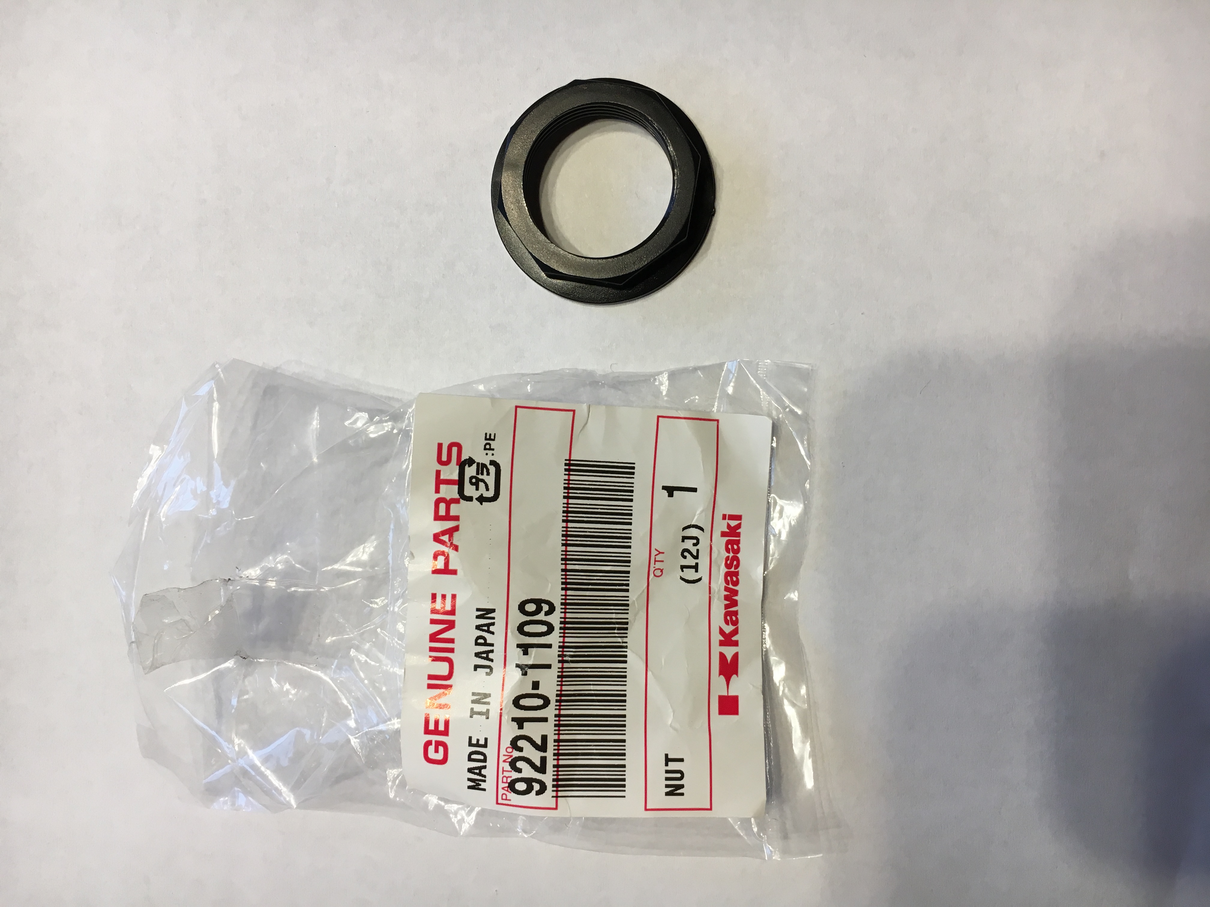

The nut is only $2.00 and fits perfect and you can tighten it like the original. It's just hex instead of knurled. It's for an ignition switch on a atv .

Bought the nut - works perfect. Thanks to all!
