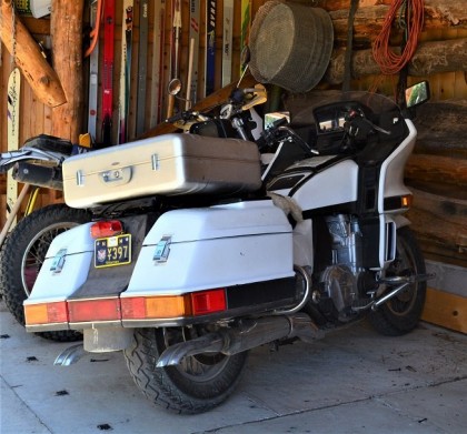

This might not have been addressed here because few XII have the "GoldWing" fender lights. I understand that Honda sued MaKa over it, and so since an early model year XII painted over the fender lens and abandoned it. I removed that paint, inserted 1157 sockets into the housing (which is still there), and started using those lights as part of getting rid of my trunk.
I also encountered issues, complicated by not being able to find reliable sockets. I wired these from scratch, working from the elec plug that used to go to the trunk. (I added a fender taillight at the same time, so no big deal.) In other words, I couldn't figure it out either. I'm suggesting starting over wiring these fender lights from sources under the trunk. I bet that'll be easier than trying to sort the existing harness, which obviously wasn't designed with LEDs in mind.

Nails wrote: ↑Thu May 21, 2020 9:14 am This might not have been addressed here because few XII have the "GoldWing" fender lights. I understand that Honda sued MaKa over it, and so since an early model year XII painted over the fender lens and abandoned it. I removed that paint, inserted 1157 sockets into the housing (which is still there), and started using those lights as part of getting rid of my trunk.
Nails, how did you remove the paint? Once removed is it a standard red lense?

I used a wire wheel on a Dremel -- nothing complicated. It's pretty butchered on the inside. I put a couple bright red LEDs in there, and it looks fine on the bike.
What's not so fine is the 1357 sockets. I can't find ones that actually work -- seems they're all crap. Right now, I think only the tail lights are working (the sockets are very touchy). They also have to be short to fit in there.
