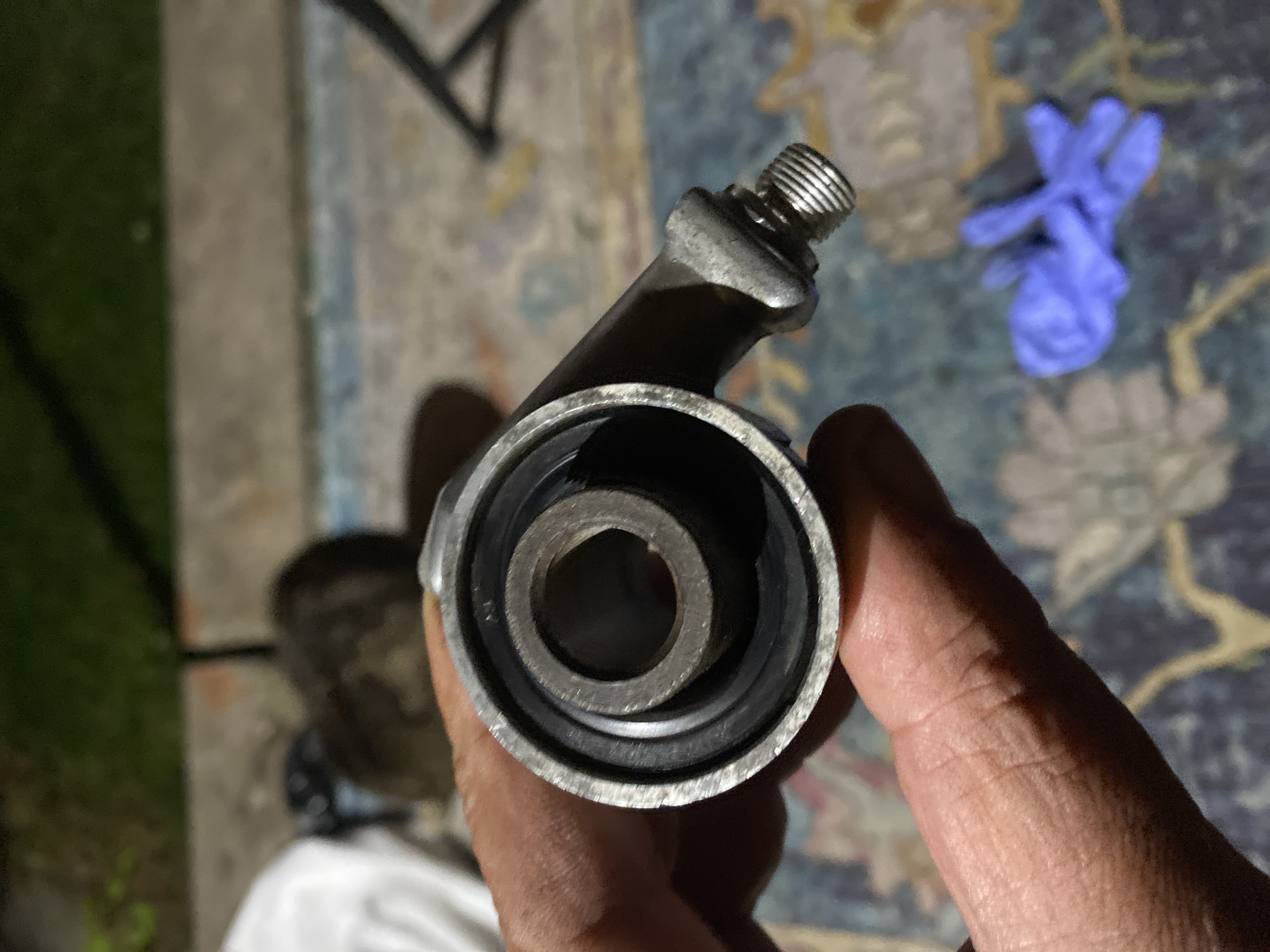

Re: Speedometer not working
I was able to put the new seal on (pic attached). I’m still not sure what grease I should use to grease it.
Thank u very much for the help brothers!
