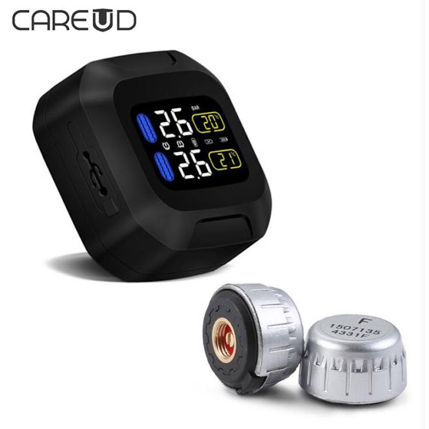

I found the same exact system, still available, still around $65+, delivered. I also found an alternative TPMS System, for $23.99, delivered. I opted to get the less expensive system. Note that each has very similar features: tire pressure monitoring, with both Hi and Lo settings modifiable by the owner, which will sound a visual and an audible alarm; tire temperature monitoring (one sensor on the old system read unusually high rear tire temperatures which seemed to be in error as it was reading 300 F); time clock; and a charge level indicator (USB charging for the receiver).

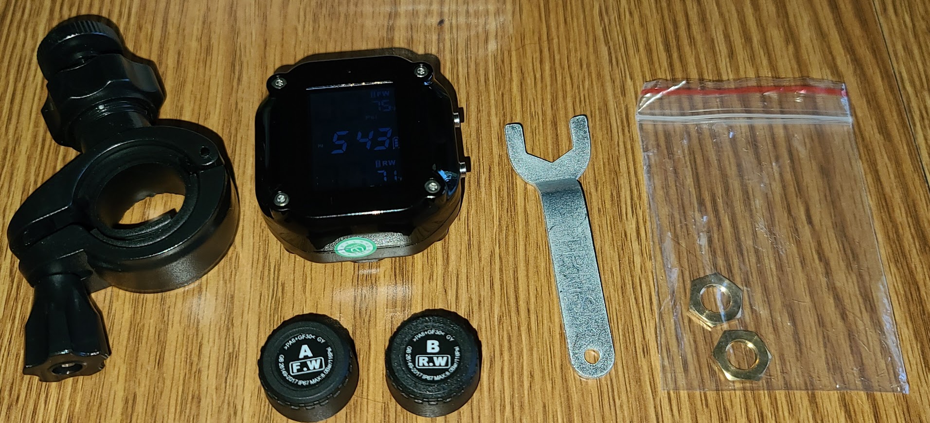

Note that my original system was not marked to indicate which sensor was for the Front tire, and which sensor was for the Rear tire -- I had to figure it out by trial and error. The newer version shown above, is marked F and R; the new system I purchased is marked FW and RW. Both sets came with a similar wrench; the newer system's nuts and wrench, are slightly larger, however, by around 2mm.
The rear tire was fine, in spite of the 300 F temperature reading. We were consistently riding two-up, with luggage, and the sensor regularly read 300 F running down the highway, so I assume with that amount of stress, the temperature reading had to be off, or the Michelin Commander III tire would surely have blown out on us... This is another reason to get a new system.
I installed the new system, and it appears to be working normally. I wanted to share some insights between the two systems. The $23.99 model has basically the same features and functions, and for me, saving $40 for an equivalent product, was a no-brainer. The lower cost model also has a magnetic USB charging port: it is not polarity sensitive, and it snaps into place firmly, and easily. The expensive model has a micro-USB port which must be inserted properly -- polarity sensitive, and you will break it if you force it in the wrong way.

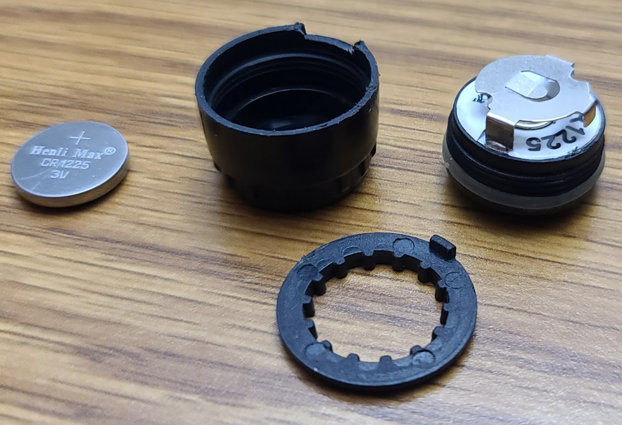

The old sensors, and the new, both have a rubber/soft plastic O-ring seal; they both screw together to house the electronics; they both run off of similarly sized watch batteries. NOTE: use CR versions of these batteries as they have higher Amp-hour ratings -- they will last longer. The old sensors, however, have plastic teeth, which can be very challenging to grip, to twist the cap off of the sensor for battery replacement. I ended up buying a Retaining Clip Pliers to unscrew the caps from the sensors. In my crude initial attempts, I believe I broke one of the sensors because it stopped working.
https://photos.app.goo.gl/uErV35DQRZw5HJN79

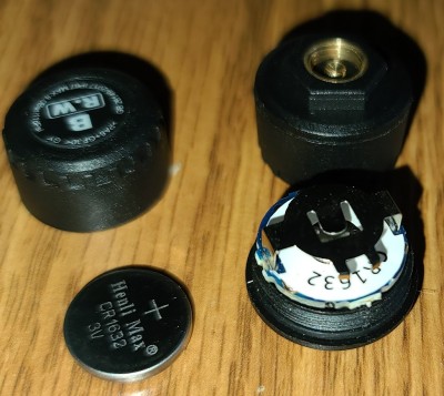

Old sensor was disassembled. Note the thin gears which were best gripped using a Retaining Clip Pliers, to open. The translucent, semi-clear O-ring has a surprisingly tight grip on the housing, when assembled. They are most certainly water-proof! Note, also, that the older sensors used a CR1225 battery, while the new sensors use a CR1632 battery: both 3 Volts, but different sizes, and likely different Amp=hour ratings. Be sure to use the proper type of battery (CR) and the proper size (indicated by the number). Substitutions might work, or they might not.

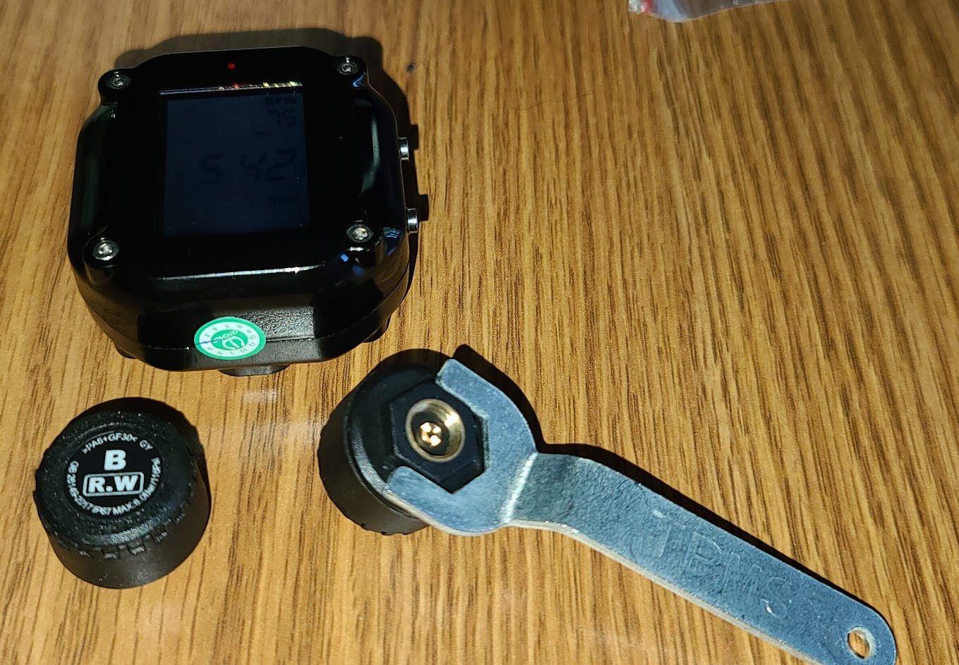

The new sensors have a molded plastic nut in them. This molded nut is the same size as the nuts provided for locking the sensors onto the valve stems. The provided wrench fits perfectly on the molded nuts, making unscrewing the caps from the sensors ridiculously easy.
https://photos.app.goo.gl/hJf6zsZ56cVaoLG29
Here is the rub, however... The plastic nut is cinched against the metal nut used to lock it in place on the valve stem, and it can be tricky to put the provided wrench only on the metal nut, not the plastic molded nut, when tightening. The good news is that you do not need to cinch the nut too tightly against the plastic sensor housing to prevent it from vibrating off of the stem while riding!

The two systems use the exact same size screws to mount the receiver to the handlebars. I unscrewed the original receiver, and then I screwed the new receiver to the same mounting assembly; now I have a spare mounting assembly.
