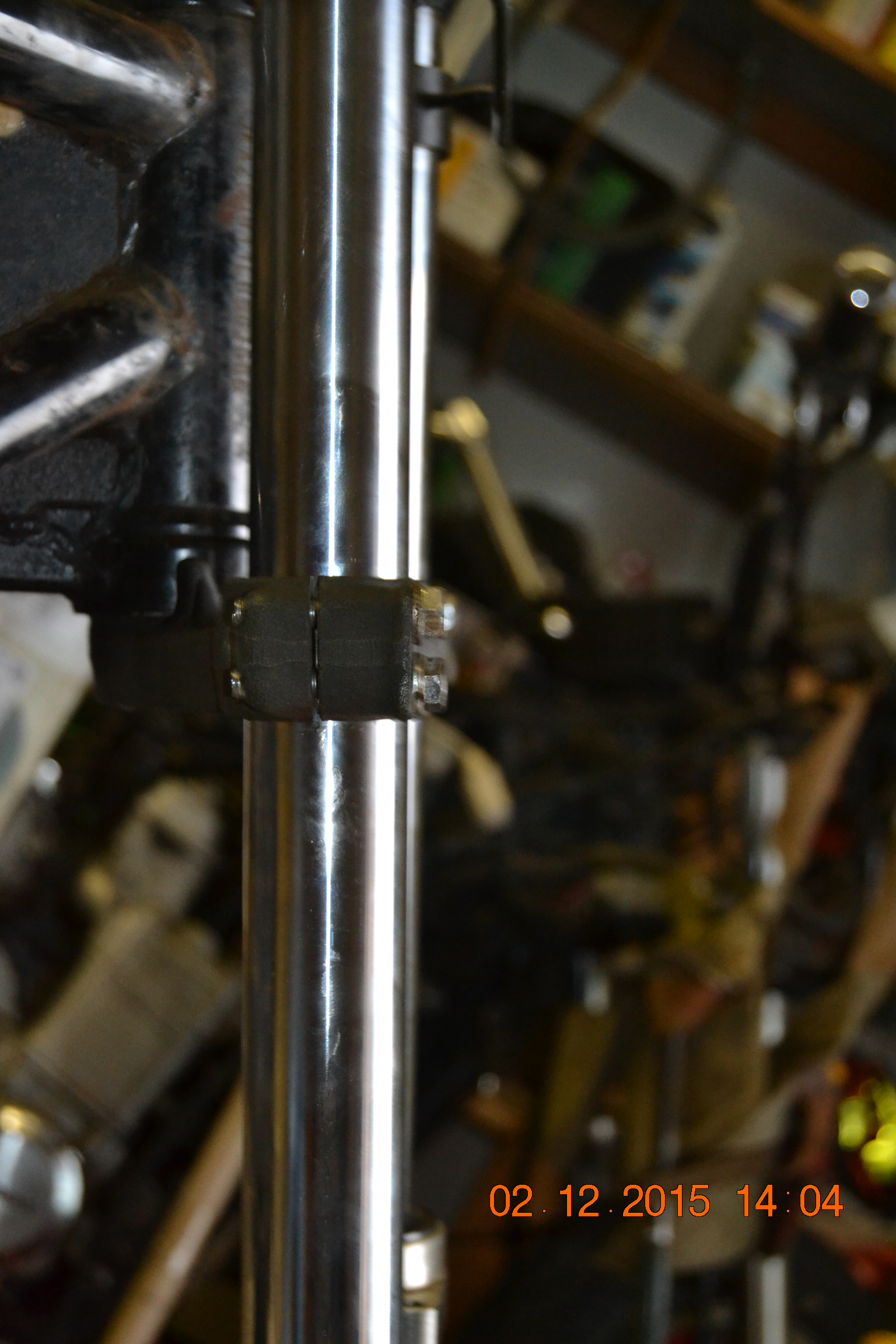

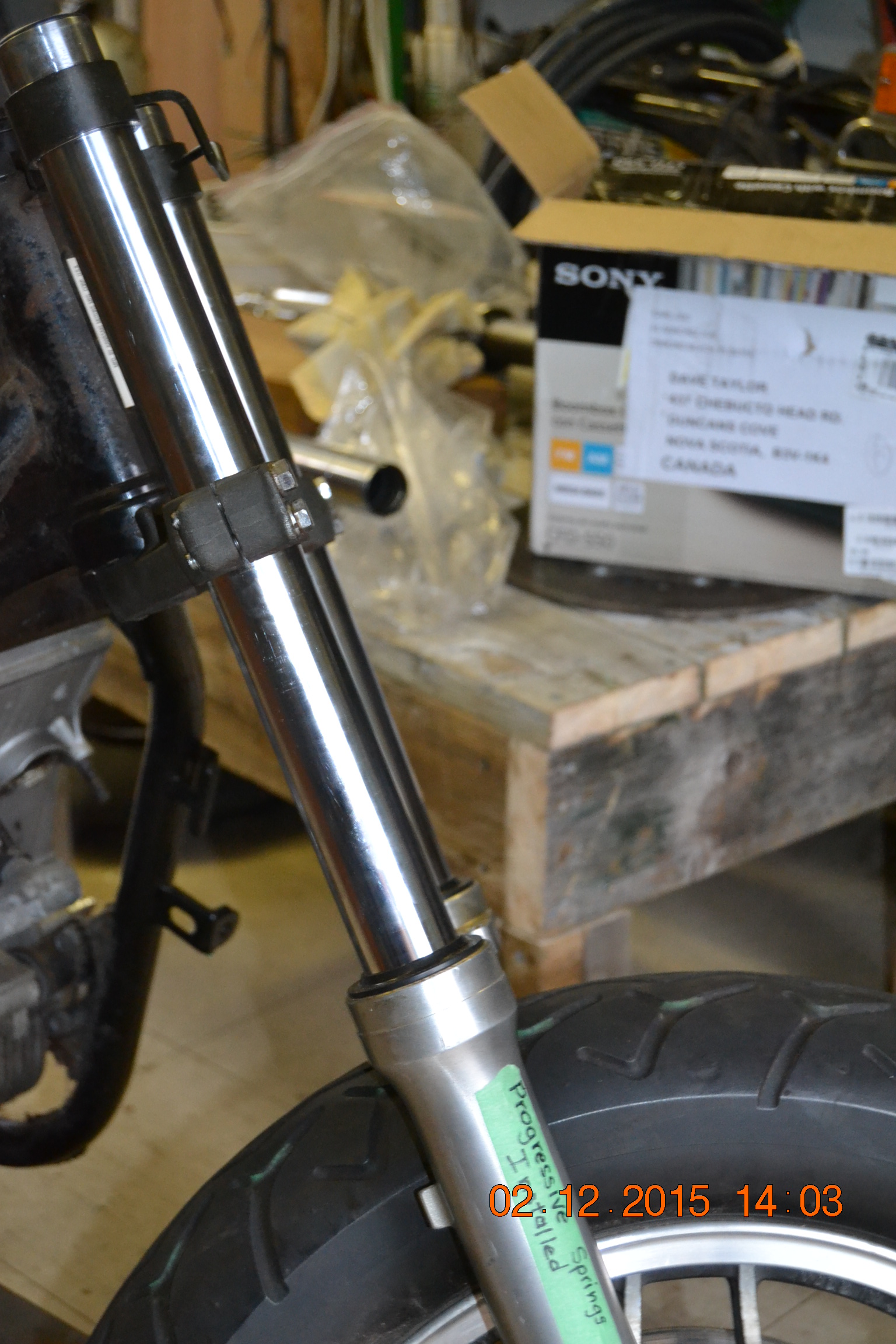

With respect to the wallowing I had one that would wallow and it turns out that one of the fork tubes was bent .025" and the lower triple tree was bent a slight amount, almost imperceptible. The way it showed up was the fork tubes were NOT parallel to each other when viewed from one side or the other. Once I changed the tree and the fork tube the bike ran straight as an arrow; see attached BEFORE photos.
Let's hope this may not be the case for you and perhaps it is worn tire tread or low/too high air pressure.
