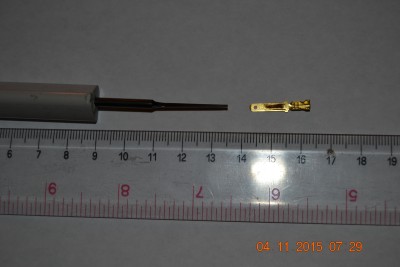

Also I have included a photo of the tool which makes removal of the brass terminal so easy.
