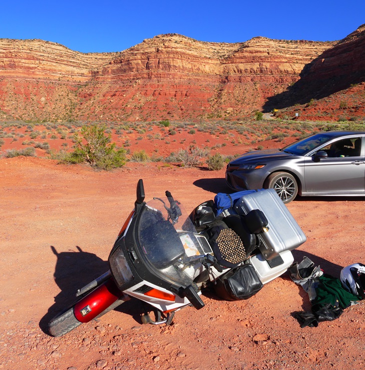

I agree with Denny and Nails. I have 3 times had to lift my Voyager XII. First in the back yard, ground was very wet, and it slipped out from under me, 2nd was trying to turn around on a mountain trial and hit a small gully (don't ask, long story), and lastly halfway to work it started to rain so I stopped - dropped the side stand and began donning my rain gear. Then with one leg in and one out I watched my bike slowly roll off the side stand due to facing slight downhill (like a dream, all I could do was watch it happen!).
Each time the engine guards/bars did their job. Kawasaki's design is amazing in that the bike doesn't actually lay flat. It's more of an angle and much easier to lift using proper lifting techniques (as Denny mentioned).
Put your back to the bike, bend your knees and with a firm grip straighten your legs and the bike is up! Any 95lb girl can lift a XII doing it that way.

My XII knows how to do knee-tap take-downs https://www.youtube.com/watch?v=R0WPnaDOzGQ -- from the back!Scott-(Altoona, PA) wrote: ↑Fri Jul 12, 2024 8:18 am... I watched my bike slowly roll off the side stand due to facing slight downhill
