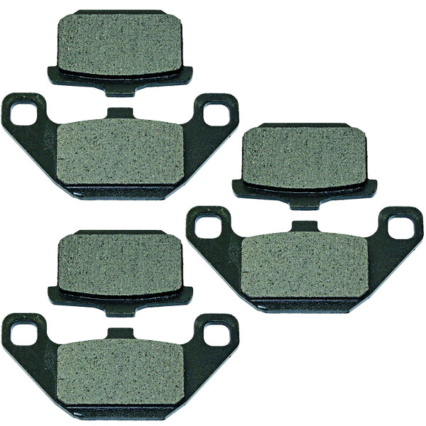

Amazon has brake pads for all three calipers, $13.50 per set with free shipping. I bought these and they work fine.Aladinbama wrote:Of course the brake pads on the left side are toast :(
https://smile.amazon.com/Caltric-KAWASA ... 00LIT5EN0/

Mr. Jensee, I'll keep them until I either use them or sell the bike. I tend to buy things I think I need without a real need. The front seems to be sitting a bit low (with @7 lbs of air in), so I'm wondering if the oil level is too low anyway. I guess we'll see.
Ghostler, Thanks for the tip, though I did find them for .50 less on fleapay. I usually go with EBC's, but hey, I can try something new once in a while. Have you gotten many miles off of them?

I installed them about 14,000 miles ago. Last I checked a few weeks ago, still had easily over half their life left, although I didn't mike them. But then, I don't brake hard. These aren't quite as abrasive as the OEM's. OEM's were tearing up the rotors something fierce. Previous owner(s) seem to be back braking folk, rear rotor shows severe wear compared with the fronts that had hardly any wear.
I gather the pad technology has improved over the past decade. But to answer your question, they work fine. I figure they are being cleared out as there aren't as many XII's on the road as previous years.

Thanks for the tip George. I just ordered a set for when I will need them. Great buy.
