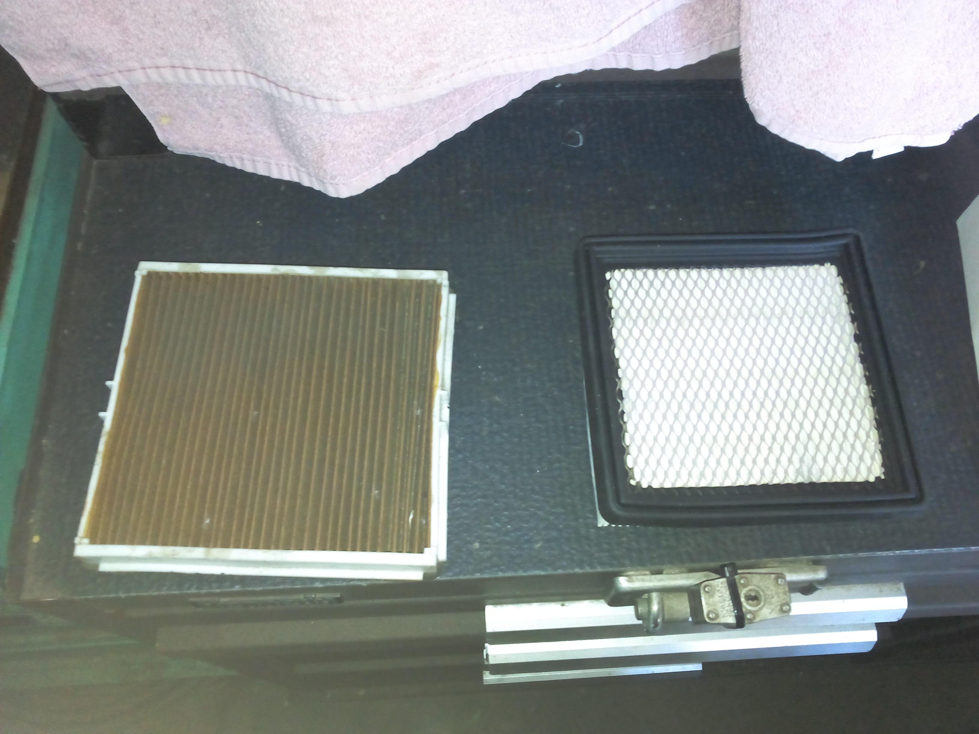

The other day I removed the fake gas tank to clean those areas, inspect the battery and service the air filter. It looked like the engine air filter was ready for replacement. Long story short, there were no aftermarket ones available. Even the owner of the independent bike shop couldn't find any. Funny thing, not to be able to find an engine air filter for a MC that was made from 1987 - 2003, but I could found air filter replacements for the older Voyager ZN1300.
After a little research here, I decided to find an automobile panel style air filter.

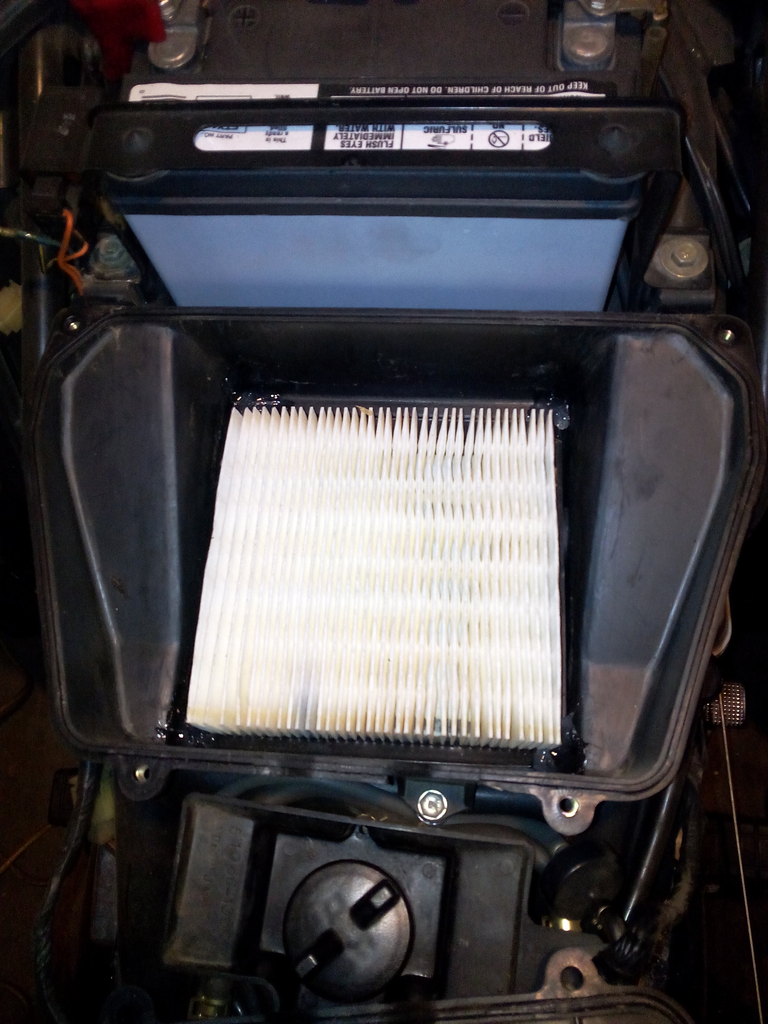

I measured the Kawasaki engine air filter, looked up on the WIX website and found a cross reference with my measurements. The measurements are 6-1/2" x 6-7/8" x 1". The WIX filter number with dimensions closest to the Kawasaki filter is 49460. I then called around to local auto parts stores and found a couple of Microguard MGA46140 at O'Reilly Auto, for around 8$ each (2nd picture shows the Kawasaki filter and the Microguard filter).
The new filter drops in perfectly, screen side down. I put a little dollop of RTV silicone on each corner to ensure that the new filter would never slip out of place (1st picture).
