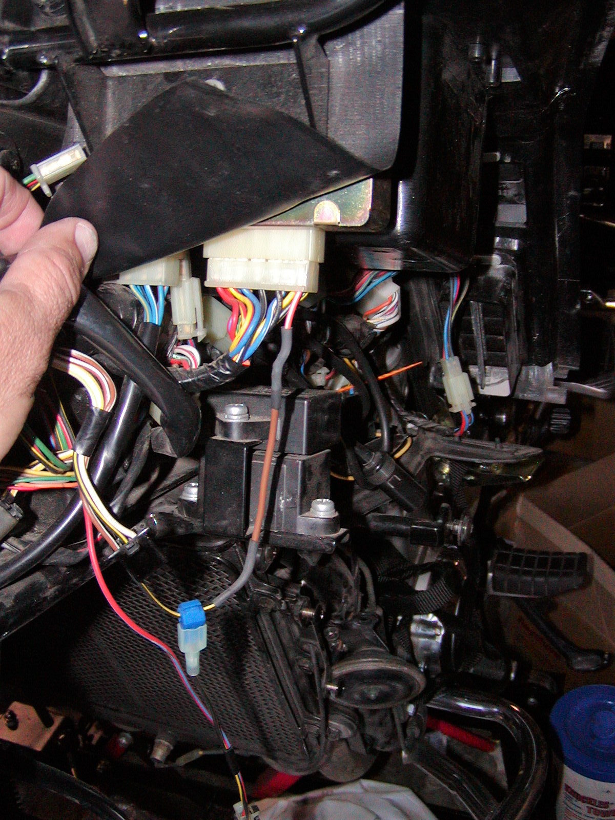

I saved this info from one of the forums 20 years ago. I'm not the author, but can attest that it's worked on 2 of the 3 vxii's that I've owned over the years.
"CRUISE CONTROL MODIFICATION:
OK! here it is; It is a fairly easy process although it is time consuming. First remove the left outer fairing shell. Next locate the cruise control main control module. It is attached with three 10mm nuts to a bracket forward of, but not to, the cassette tape storage compartment. From the bottom of the module are two plugs. One has 5 blue wires with various colored tracers. The other has 12 wires of assorted colors. The second plug is the one you're looking for.
Locate the orange wire with a white tracer. Cut the wire as close to the wire harness wrapping as possible. Splice a piece of wire about 6" long to the orange w/white wire coming from the plug. Ground it under one of the 10mm mounting nuts. Re-install the fairing shell. YOUR DONE!!! This was done in 98 and to the best of my knowledge is still using it this way today."
FYI I chose to tie this wire to one of the many ground wires near this plug. If you ride 2 up & pull a trailer, this is the only way to go.

Hi folks. So I did this mod to my '93 (1200). Works great!! It's a pleasure to ride in the mountains now.
I looked at the wiring diagram and is seems that when the transmission is NOT in OD the orange / white wire that goes from the harness to the cruise module (see previous discussion) is OPEN. When you shift to OD, that wire becomes grounded (through a switch), and that tells the cruise module that the transmission is in OD. So by following the mod procedure and installing a permanent ground, we're essentially tricking the cruise module to thinking that the transmission is always in OD. Brilliant.
Modification time - ~30 minutes.
Time wasted deliberating over whether I wanted to cut the wire (I HATE cutting wires) - ~ 2 hours.
Cruise control in 4th and 5th gear - PRICELESS.

Unfortunately, the orange/white wire hack did not work for me (1996). The OD light stayed on all the time, and the cruise control couldn't be turned on (much less set).
I put it back together stock -- maybe I have a second problem.

Did you zoom in on the picture I posted? The wire I cut I used a piece of scrap brown wire that must be connected to ground.. Also the other end of the cut wire can be seen where the black tape ends on the wiring harness. Is your OD light staying on in ALL gears?? My OD light works fine.
