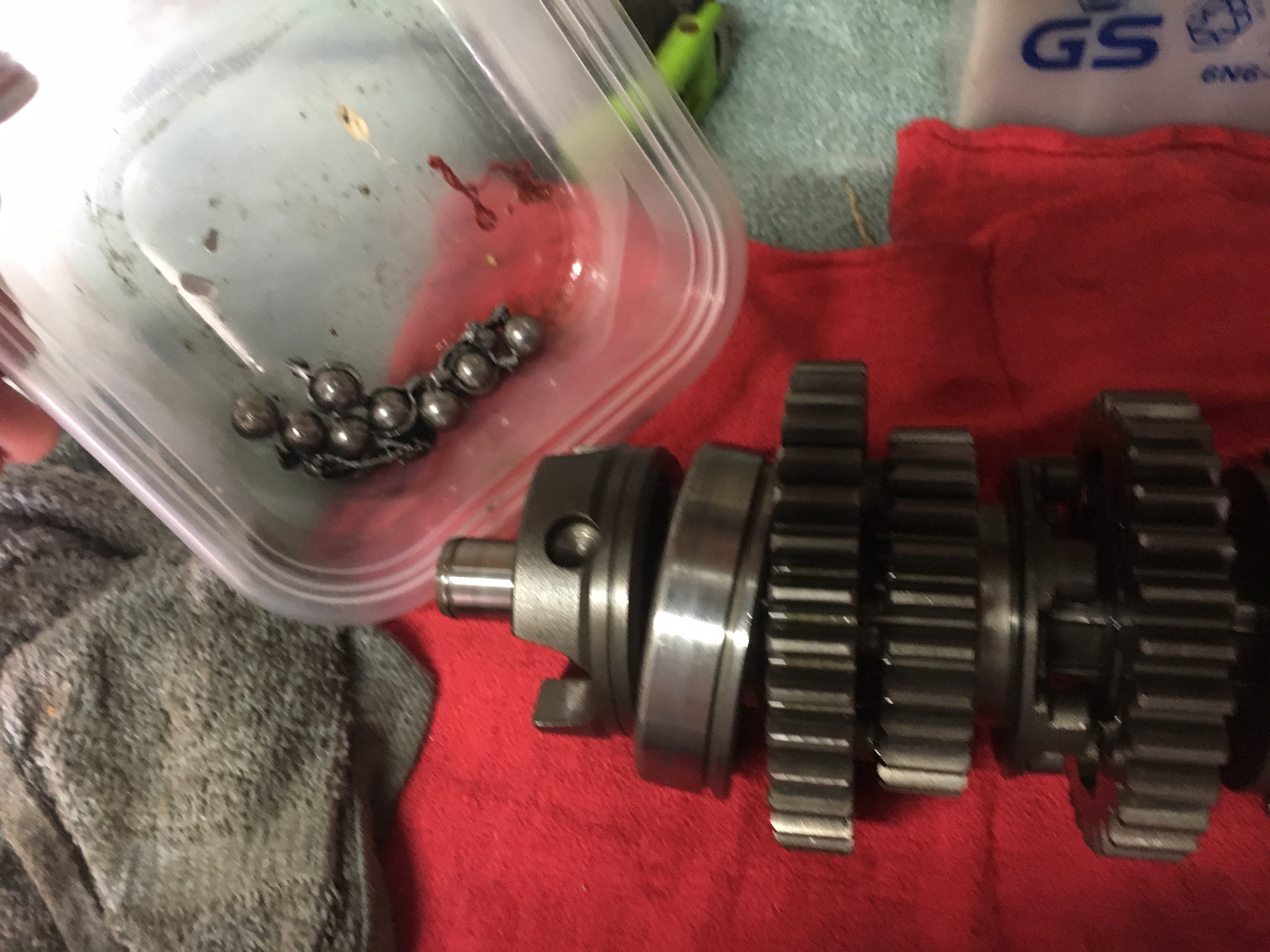

He replaced the transmission assembly with one he had with 1800 miles on it. Road it back home to Gurnee , IL from Ormond Beach Florida. Around 1300 miles. Shifted like a new Voyager.

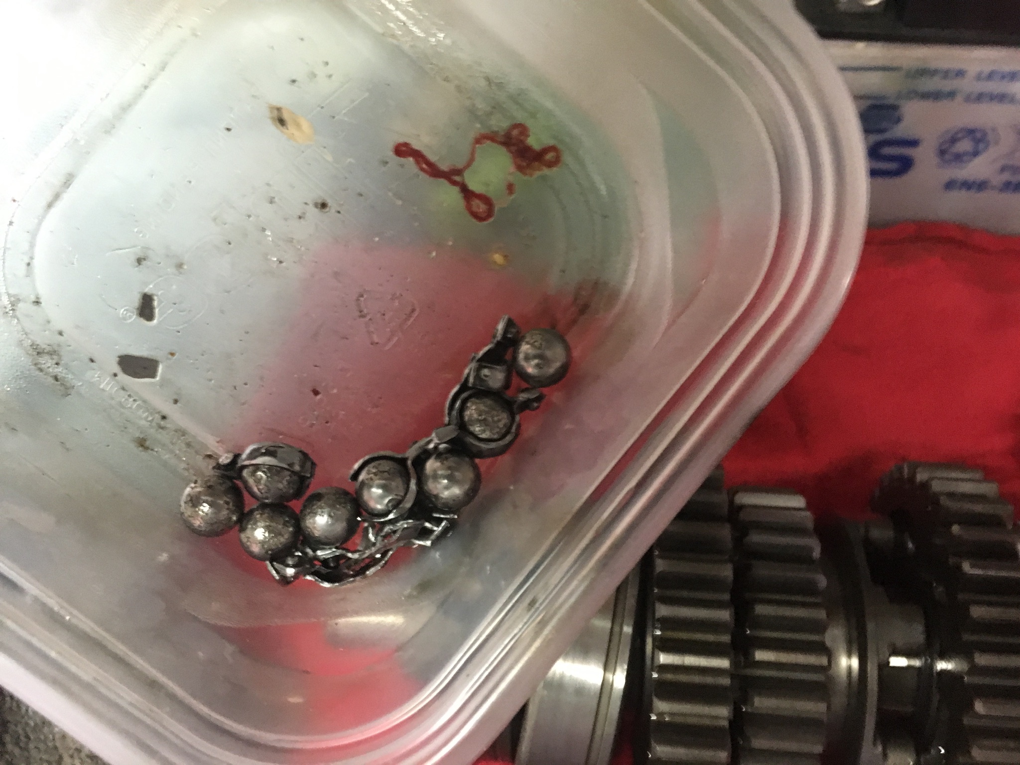

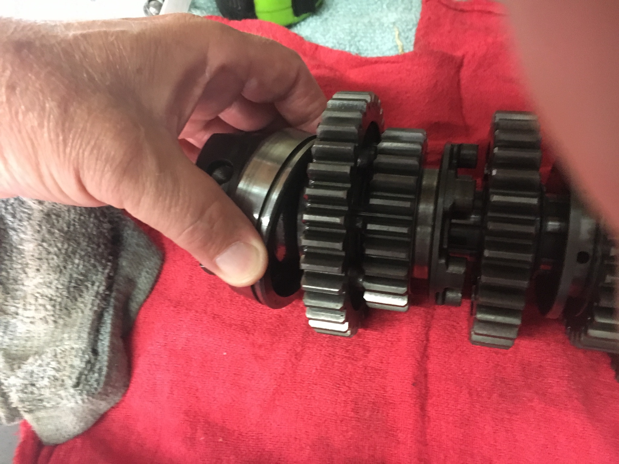

I will post pics instead. Transmission output bearing failed causing lots of problems.

Re: Did anyone find out what happened?
That bearing certainly did fail! :hmm:
Did Carl give any reason to suspect why? And how to avoid such a failure?

Carl has never seen this happen before. He has no idea why it failed. He had to split the case on my engine for this repair. He said my engine was very clean and pristine. I change my oil always before 3000 miles.
