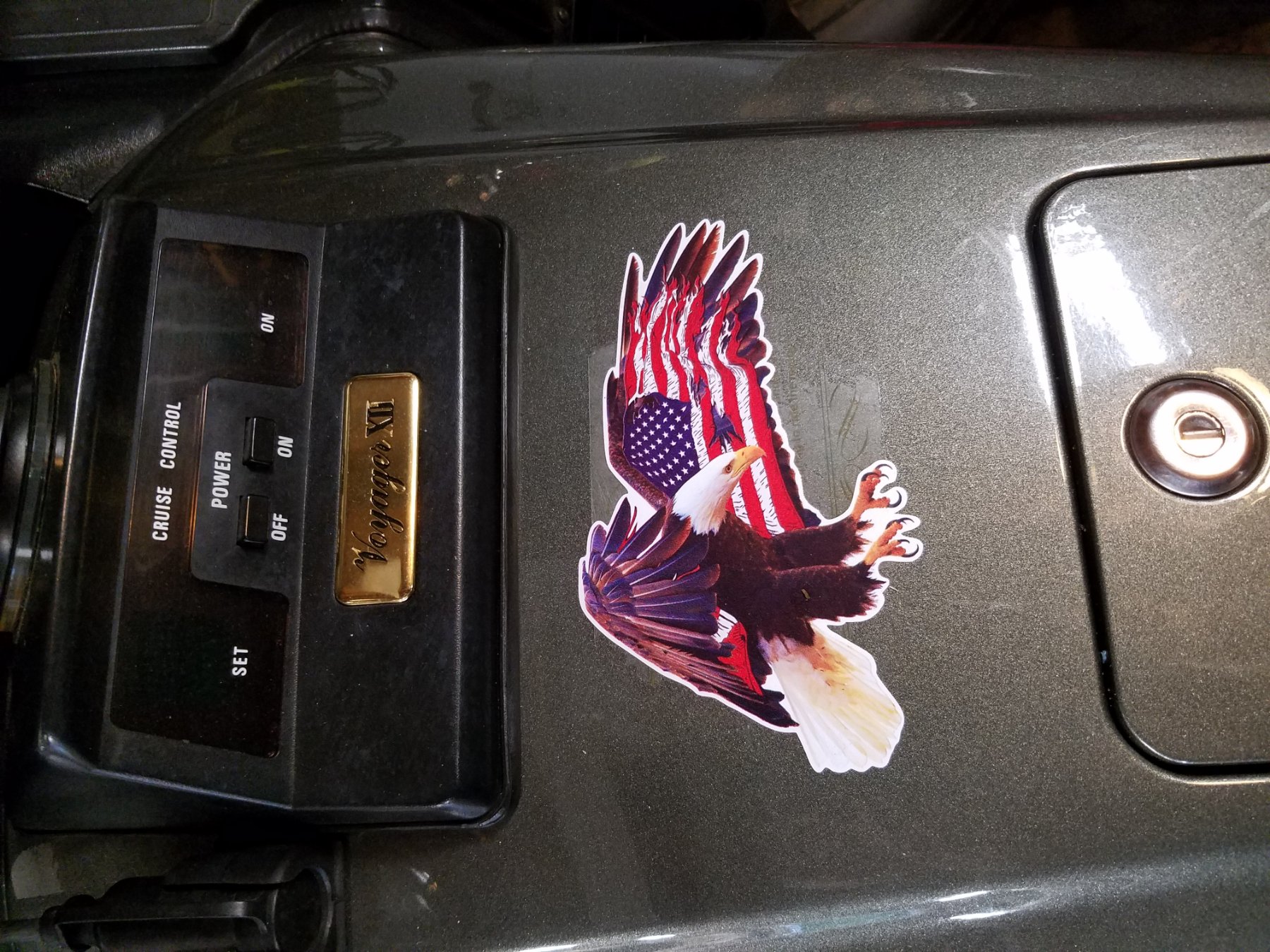

First thing I will advise anyone looking to do this is to leave it alone! Denatured alcohol did the best at softening the decal, but it was a very painstaking and long process. WD-40, goo be gone, isopropanol, and anything else I tried did not even touch it. Thought about doing carburetor cleaner but I was pretty sure that would take the paint off also. In the areas where I did get the decal off there is a noticeable difference in the paint so, my best solution was to put another decal over the partially removed Factory decal. Not ideal and not the decal that I will eventually have there, but it looks okay for now. Best advice for all, leave it alone!!
