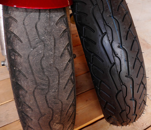

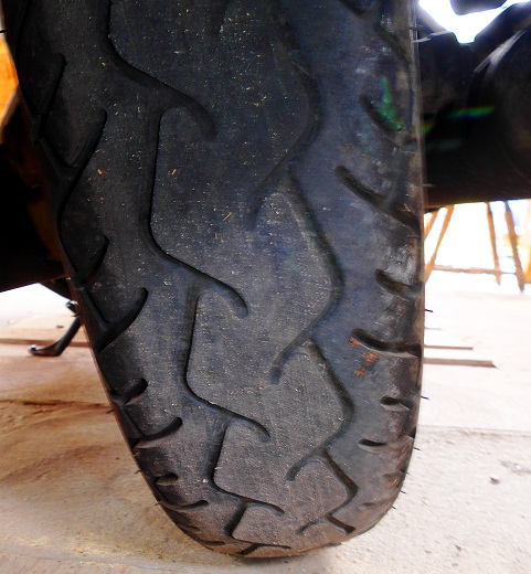

Pirelli review
I can't decide whether to put this here or in a new thread.
I previously gave my little opinion of MT66 tires here: https://www.amervoyassoc.org/forum/view ... lli#p88087. I still love them.
These also are bias ply and otherwise 90's technology, which I think suits the XII bueno. I understand that bias-ply tires tend to require more pushing on the handlebars, which is sure true of my XII. But that's the extent of any negative comment.
Interestingly, my front tire wore out before the back. I rode it to the wear bars last week; and I have a new one waiting at the post office. I got about 9K miles out of it. My rear tire probably is good for my next trip, 4K or so more miles -- I got it about 8K ago. But this tire also has seen a lot of high-temp days: my TPMS often beeps at me about tire temps of 130F or more.
My experience definitely is not "low mileage"; and I don't seem to have any acute chicken strip shame for a tour bike. I don't have any good reason to switch.
[edit: One "complaint", it's recently started to catch tar snakes &etc. But it's wore out.]
9K down ... and 9K to go: About 8K miles.
