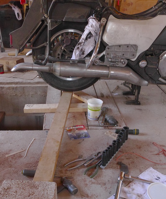

I changed the shock oil once before, and it was only a moderate hassle. But this time I can't get the fork oil either out or in. I'm trying to follow the manual procedure to fill the shocks with oil and then pour out the "air space volume".
I hung the shocks upside down for a couple days, but they didn't seem to drain right. (I was draining them into a pan that already had some oil in it, so couldn't tell how much really drained.) With minor percussion, they drained a few more drops of oil.
Then I could only get a little oil back in. I tried pumping the shocks, but just a little (don't want to knock it off the centerstand). The photo has just one shock on the swingarm (rag around it because I'm making a mess) with no air lines attached. I pumped that 2X4 to move the swingarm about 1/2"; and then left it partially compressed (the concrete bricks), but still could only add a ml or less of oil at a time.
Now I'm trying to drain the "air space" oil back out (upside down again), but it's coming out just a drop at a time.
I think, to do this right, I'll need to compress the shocks a lot, and then add oil as I extend them. I have spring compressors for struts (yes, I hate using them), but I bet I could put a long bolt through each shock eye and then put a compressor on each end of the bolts. (Yes, I'd wrap a safety chain, somehow.)
Right now, I have no idea how much oil is really in there. Suggestions?

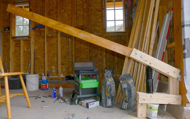

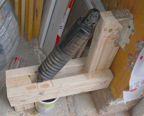

I hesitate to call this a success, but here's the weirdness I went through to get the shock oil out. It took me a couple hours to design and build this abortion ... and then just a couple minutes to pump all the oil out of both shocks.
After about four days, most of the oil had drained out by gravity -- maybe 20-30 ml was still stuck in there. The problem was that I just didn't know. With pumping, I got a satisfying wheeze that all really was out.
This thing also holds the shock right-side up for filling.
The manual calls for 230mls of oil, which should leave a 160ml headspace. Tomorrow, I'll swing by that friend's vet clinic -- she was pretty sure she could find a syringe with a needle that'll fit in the tiny hole in the air fitting. Last time, I squirted in that 230 ml, which seemed to work accurately. I just had to refill the syringe a bunch of times.
The ATF did a great job cleaning out the skanky oil that was in there; and I'm not screwing with this again anytime soon.

Nails,your "shock pumper" looks a little more professional than mineNails wrote: ↑Tue Mar 29, 2022 9:32 pm I hesitate to call this a success, but here's the weirdness I went through to get the shock oil out. It took me a couple hours to design and build this abortion ... and then just a couple minutes to pump all the oil out of both shocks.

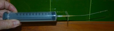

Okay, S came through with a 60ml syringe and a 5.5" urinary catheter for cats. Seriously.
It fits in the tiny hole in the shock air fitting (loose enough for air to come out around it), so I should be able to inject oil directly into the shock. But I just brought the oil into the house and it's still a little below freezing -- I couldn't draw much oil into the syringe like that. I'm hoping I'll be able to get oil through the catheter once it's warmed a bit. And I can cut it in half or shorter to limit the length of that super small-diameter tubing. (S says she can get bloody body-temp pisss through it just fine.)
I'll leave you with that visual.

I got the shocks reinstalled. The catheter worked pretty good, but honestly this was a PITA. I have no idea why because last time I just drained and refilled the shocks without any drama, just like the manual says. But this time, the oil wouldn't drain out, and it would drain in either. I used my pump gizmo both ways, and still spilled oil that I needed to account for.
